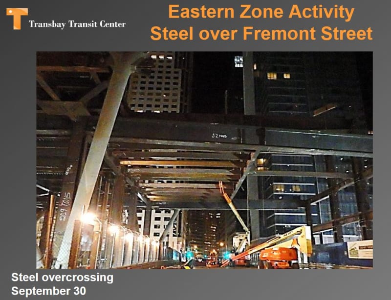

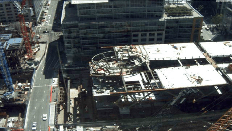

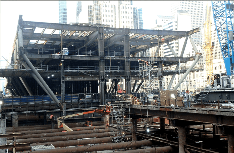

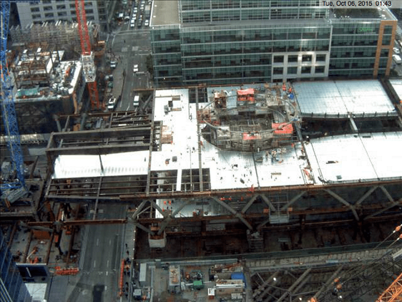

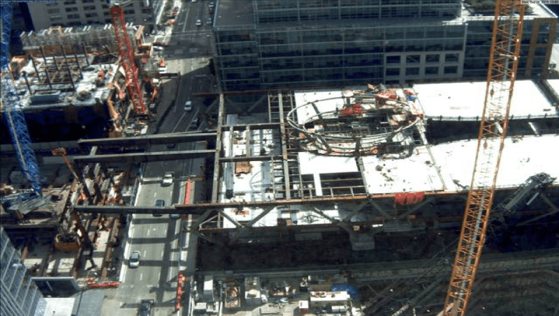

There are two such bridge spans, the one with the crack spanning Fremont St. and another to the west at First St. The TJPA will be shoring both, though the Fremont St. location is the only one that has cracked. News Video: Link

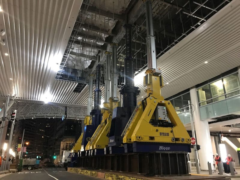

The yellow jacks are 100 ton capacity and the blue jacks are 800 ton capacity.
Original Press Release with As-Built photo (PDF). Link
ENR photo of steel erection: Link

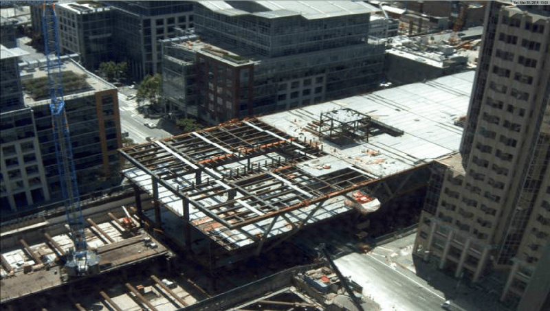

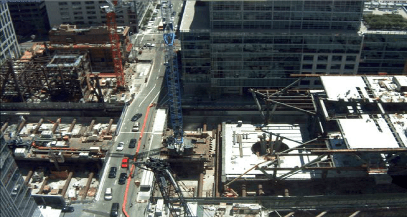

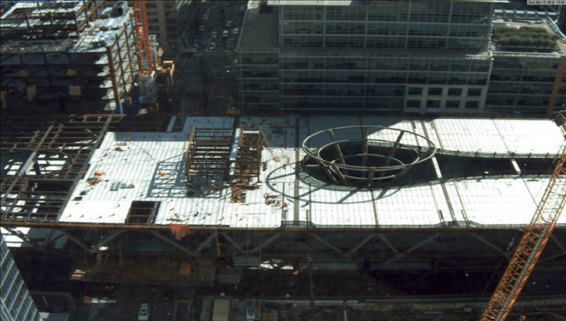

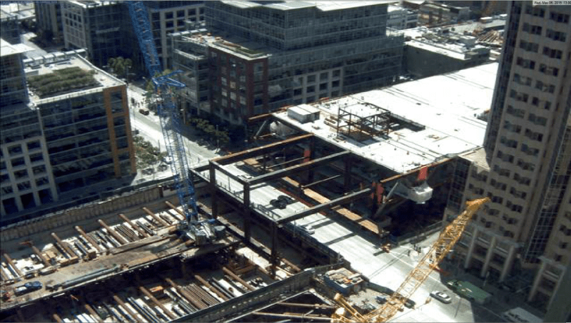

WebCam grabs:
First St.
Fremont St.
Looking north with Millennium Tower on the right.
Steel having just spanned Fremont St.
I'm curious how that raft is constructed and what the target bearing pressure is for the street.
Really, only 100 ton capacity...from a hydraulic/ram area perspective they look like closer to 1,000 ton capacity. Given their effective length I can see reductions in the load capacity, but only 100 ton. I have several 100 ton hydraulic hollow rams and they are 8" diameter - sure, they are only 8" tall.
