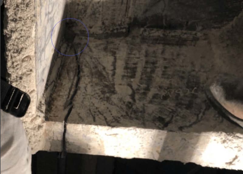

Has anyone considered the ASIC provisions for transverse stiffeners? Specifically, I'm looking at AISC 360-05, section G2.2 which says, "The weld by which transverse stiffeners are attached to the web shall be terminated not less than 4 times nor more than 6 times the web thickness from the near toe to the web-to-flange weld." I think it's in section 3 in 360-14?
In graduate school, I underlined this sentence with a note that full-depth stiffeners may cause cracking in the flanges. That is, the welding of the stiffener to or close to the flange will reduce the ability of the flange to strain properly, and instead the flange will crack. It's a different condition if the stiffener is located at a support....
Perhaps this has been pointed out -- I haven't read the whole thread, but didn't see anything about this section after a quick page search.
Thanks.
Don't think I agree. Full-depth stiffeners are pretty common. Haven't designed plate girders since school but I had thought that you actually needed full-depth stiffeners to consider tension field action, partial depth stiffeners won't cut it. You also see full-depth stiffeners used pretty commonly in beam-column moment connections as well.
The sentence immediately preceding the 4-6 web thickness requirement discusses stopping stiffeners short of the tension flange when you don't need the stiffener to bear on the tension flange to resist a concentrated load or reaction (like you would for tension field action or stiffening a column at a moment connection). So I've always consider this 4-6 web thickness requirement to be specific to partial depth stiffeners.
Looks like a very tight re-entrant corner. Maybe there were some flaws in the original plate that opened up into cracks once real load was put on the joint?
Well MrHershey and Ave85, I think you're both correct. The stiffeners for plate girders typically are full depth. However, we clip the inside corner the 4-6 times the web thickness from the flange (at the web) and 3/4" from the web (at the flange). We then hold the welds back a 1/4" from the end of the clip.
Edit: Apparently, some like VDOT and WSDOTclip the stiffeners, as we do. Others may not, but I don't know of any that currently detail transverse stiffeners without a clip.
Sure. Maybe I mis-typed. I'm not pointing to full-depth stiffeners. I'm pointing to full-depth welds. Welding is known to reduce the strain capacity of steel, which is why I think the code requires that welds be held back from the tension flange. I think this is specific to web stiffeners on plate girders, and there are different requirements for moment connections, concentrated forces on WF shapes, panel zones, protected zones, etc.

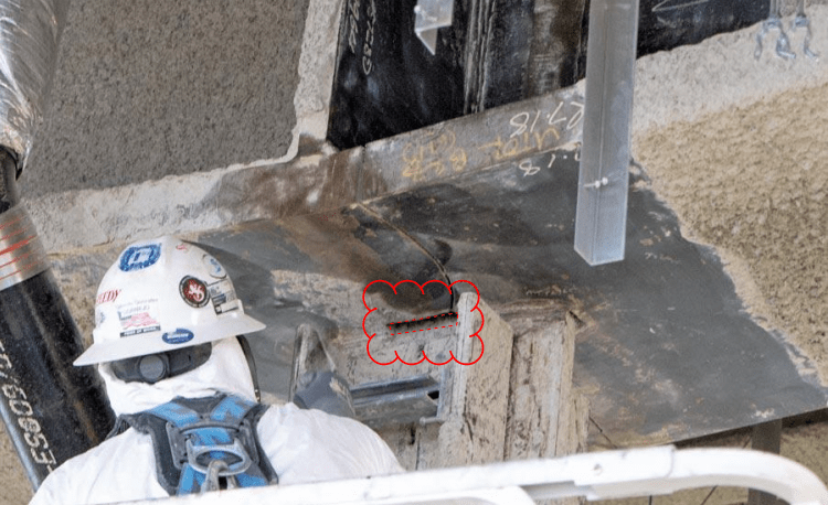

"The holes were added after shop designs were submitted for approval. So, Herrick crews first built a set of girders without the holes and then had to build a new set of girders with them included, he said.
“Why they were added, that’s more of a design issue than a fabrication issue,” Hazleton said. A representative from Thornton Tomasetti, the design firm, declined to explain the purpose of the holes."
ENR has some additional info on the hanger plate and flange holes: Link
The flange holes appear somewhat contentious between EoR and fabricator - why were they were added and who requested them.
Interesting place to locate two 2" x 4" flange holes (each side of web), and allow a hanger plate to pass through, so as to connect the back-to-back vertical channel hangers.
At what point should this design have been done per AASHTO instead of IBC/AISC/AWS?
It looks like a lot of CYA will happen as to how the holes should have been finished. However my quick scan of AWS doesn't seem to say a weld termination finish in cyclically loaded structures to be different than weld access holes.

An update in ENR:
ENR said:
A combination of:[red]
1. Low fracture toughness deep inside thick steel plates,
2. Cracks present as a consequence of normal steel fabrication and
3. Stress levels from loads, which are a function of design[/red]
apparently caused brittle fractures in the bottom flanges of the center's twin built-up plate girders that span 80 ft across Fremont Street.
All three ingredients were needed for the brittle fractures.
“Take away any one and there is no brittle fracture because the other two compensate,” says Michael D. Engelhardt, a professor of engineering at the University of Texas, Austin
