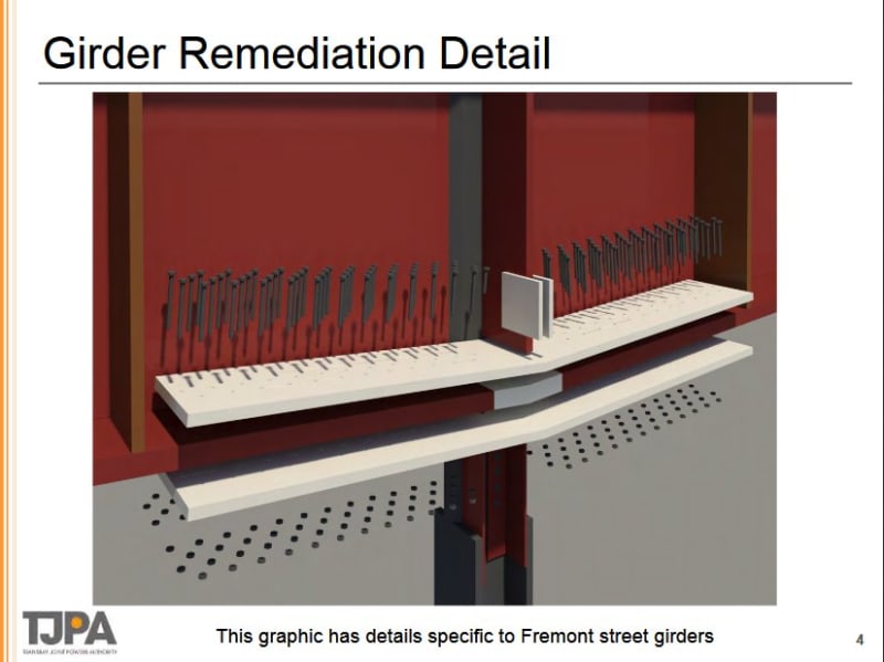

Discussing with another engineer in our office, I just realized how poorly this was detailed in several aspects:
1) They cut a hole in the tension flange of a girder at the maximum tensile stress location.
2) They put a kink in a 4" thick plate at the maximum tensile stress location.
3) They welded a stiffener to a 4" thick plate at the maximum tensile stress location.
It took us about 2 minutes to come up with an alternate configuration that would have been be far better for the beam: 2 Beams a few feet apart with a pair of diaphragms running between, sandwiching the hanger strut.
Using a wider and thinner flange would have helped considerably with fabrication, as well.
In reading the ENR article more thoroughly, I noticed they utilized a full-penetration weld to connect the flange sections together at midspan. That would seem nearly impossible to do adequately for a 4" thick plate. The slot for the hanger plate also follows the taper of the hanger plate as it goes from 4" in the middle to 1.5" at the end, making the slot diamond-shaped, which is a poor fatigue detail. Using a continuous flange plate, bent over a long radius curve and using an oval hole around the hanger plate would have decreased the susceptibility of the flange to fatigue cracking.
Apparently they drilled in the rat holes AFTER the welds were done and then didn't grind them smooth.
The article also mentions that there was a problem with the actual steel material but didn't go much further in explaining that.

Here is a March 14 Update - It is kind of a puff piece presentation for board members & the Citizens Advisory Committee. Link

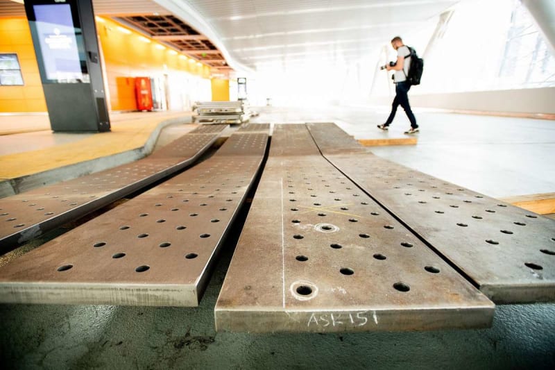

Four-inch thick steel plates to repair and reinforce the four beams have been delivered.
I haven't been following closely enough to know if this is correct, but the plates they show only look to be 2" thick at most if the bolt holes are 1-1/2" diameter. Maybe they mean four 1-inch thick plates?
Perhaps it is 2 inches top & 2 inches bottom for a total of 4 inches.
