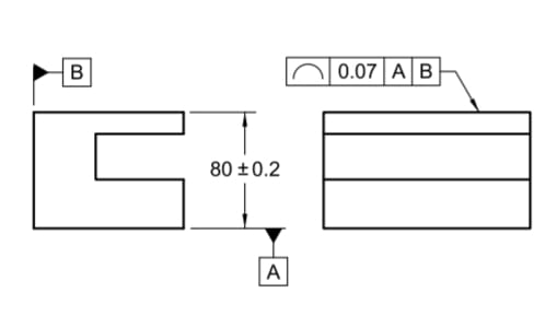

I disagree that toleranced dimensions can control a relationship to the datums. It's possible only with a dedicated note like shown in the standard for castings, forgings and molded parts, and as I think was allowed in Y14.5 until '94.
Burunduk, what about the example already given of Fig. 11-32?
Doesn't that example of profile have toleranced dimensions back to the datum?

I consider 80±0.2 in figure 11-32 to be a simple size dimension. It has no direct relationship with the profile of a line tolerance or the datum established for it. It certainly doesn't affect the profile of a line tolerance zone in any way.
If that were the case, then the same callout without referencing datums A and B would mean the same thing as the current figure. But that isn't true.
Think of it this way...the profile tolerance must live within the size tolerance. Thus, profile doesn't control location, but it does control orientation, which is a refinement of location.
So I'll repeat my contention that profile can sometimes be applied to a true profile that itself isn't basically dimension to the given datums.

Without referencing datum features A and B the profile of a line would only control form, like straightness would. As it is in the figure, orientation is controlled, but the size requirement of 80±0.2 has nothing to do with it.
If this directly toleranced dimension was removed from the drawing without being replaced by a basic distance dimension or dimensions linking to the datum, the orientation and form would be controlled by the profile of a line just the same.
I agree that the profile of a line tolerance in the figure doesn't control location, and that it does control orientation (and form).
But what are exactly the implications of "profile must live within the size tolerance"? Does the part have to conform to both requirements to be accepted? Yes it does. But does the size tolerance or dimension take part in defining the tolerance zone for profile? I claim that it doesn't. The part could be, for example, 100 mm tall instead of the required 80±0.2, and still conforming to the profile of a line tolerance, within a very small measured value. It could be rejected only for non-conformance to the limits of size, imposed only by the toleranced size of 80±0.2. There is no reason to mix the two requirements. A good reason not to mix them is exactly because they use different types of dimensions - one uses a toleranced dimension, the other needs basic dimensions.
Perhaps we are saying similar ideas, but with different perspectives and wording. (I will amend my previous post.. the profile zone itself doesn't live entirely within the size limits, but the line elements must fall within both requirements, as you mentioned.)
My point is that the profile tolerance has some relationship to datums A and B; we certainly agree on that. So my comment (where you said you didn't follow) simply pointed out that dropping the datum references A and B would change the meaning of the profile tolerance.
Profile is not locked by the size tolerance. But my comment is that people often assume that any profile tolerance that references a datum MUST have a basic location back to that datum. Figure 11-32 is the prime example of why that's not the case.

Regarding the latest tangent to this thread, I think both of you are right in some way. In figure 11-32 the profile tolerance does reference the datums, but unlike most uses of profile, it's not a basic dimension for location (Belanger's point). The location is handled by the size tolerance.
Profile does control orientation, but there is still a basic dimension for orientation of 0 degrees (essentially that's Burunduk's and axym's point).
For the original question, I would agree that the second profile example is incorrect because it doesn't have a basic diameter.

A profile tolerance can reference a datum without having a basic location to the datum, but if it does have a location back to the datum, that location must be basic.
This is why I initially said at 24 Mar 23 16:53 that "I disagree that toleranced dimensions can control a relationship to the datums".
In figure 11-32 the profile tolerance zone, or true profile, has no location relationship whatsoever to datum A, because it has no basic location relative to it.
There is only an implied basic 0° orientation. It is true that the feature which is controlled by profile is part of a feature of size, with the other part being the surface labeled as datum feature A. The size of that feature of size is controlled by 80±0.2. This is a size tolerance, and it does not use a datum feature and doesn't require the establishment of a datum. I guess it would not be wrong to say that this size requirement effectively results in an indirect limitation of distance between datum A which is used for profile of a line and the top surface, but that distance limitation is absolutely not part of what the profile of a line requirement imposes and not part of the definition of the 2-parallel-lines tolerance zones. The tolerance zones can float freely in translation relative to datum A, and have nothing to do with the toleranced dimension.
I am wondering what theory would Y14.5 offer if in fig. 11-32 the surface controlled with the profile of a line tolerance was nominally coplanar with datum feature A?

In that case, the shown nominal coplanarity would imply a basic zero location. Then the true profile would need to coincide with datum A, and profile of a line would control coplanarity by limiting the offset of the line elements from datum plane A.
Burunduk,
My question wasn't about what the interpretation of the line profile tolerance per the existing rules in Y14.5 would be in that scenario, but rather what solution they would propose to enforce the line profile tolerance zones to freely translate relative to datum A. Would it be a recommendation to apply a directly toleranced 0 dimension?
In that case, parallelism on a "EACH ELEMENT" basis for orientation (and form), and a profile of a surface for the control of coplanarity, would be the proper callouts.

In other words, why didn't they just use parallelism on a "EACH LINE ELEMENT" basis in current fig. 11-32 instead of profile of a line?
