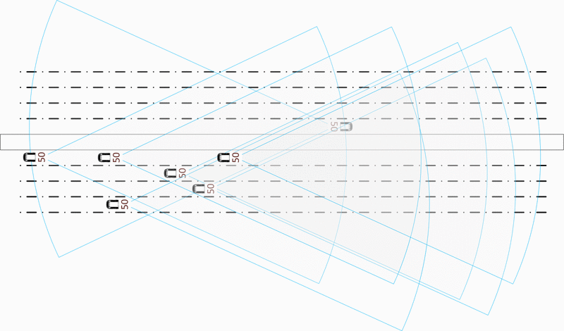

LiDAR fires a laser. A few micronanoseconds after the laser fires, the receiver sees what is called the t0[ ]blast. The LiDAR electronics start counting, waiting for the signal to bounce off something and reflect back into the receiver lens. The receiver probably will have a narrow band interference filter that excludes all light that is not within say 2nm of the laser signal. LiDARs now are fairly rare. That 905nm signal you are detecting almost certainly is yours. If fifty cars all have LiDAR, that signal almost certainly is not yours. You have no way to make sense of the other signals. There is not enough bandwidth to give each vehicle its own laser wavelength, even if this were practical in cost sensitive production.
The company I worked for was developing airborne LiDARs that flew high enough, and ran at high enough laser pulse rates that the lasers were firing before the previous pulse came back from the ground. There were all sorts of tricky electronics for dealing with that. Of course, this would not be a problem for a car approaching woman pushing a bicycle across the highway. LiDAR scanners are a whole lot of fun

lidars measure distance using their time of flight (TOF) [TOF/(2*c) = distance]. Typical pulse widths are on the order of nanoseconds, as are the times of flight; for 100-m radius coverage, TOF is 667 ns.
The design beamwidth of a lidar might be on the order of 1.5 mrad, which is less than 0.1 deg. lidars need to be scanned to cover the 50 deg or so of frontage, so the receivers are aligned with and have fields of view (5 mrad-ish) comparable to the beamwidths. There needs to be a larger receiver FOV than beamwidth to allow for physical misalignment and TOF during the scan. Opposing lidar beam on own receiver will be very, given the small beamwidths and FOVs, and masking by other cars. But, such events are essentially non-events in the sense that the strength of the signals are likely to saturate the receivers.
Returns from cars going in the same direction are likewise relatively rare, as there also masking by other cars, and the limited time and angles over which a Lambertian return can actually get into the FOV of a receiver. Nevertheless, the interference can be mitigated by a pulse-coding scheme with a matched filter receiver. Additional mitigators could be varying the pulse energy as a function of traffic congestion, since having a car 20 ft in front of you means that firing the lidar to find a 100-m distant target is not realistic.
Additionally, the collision avoidance processor needs to maintain a 3D database of detected objects, and generate trajectories as required, and apply a fading memory to kill of older and no longer relevant objects.

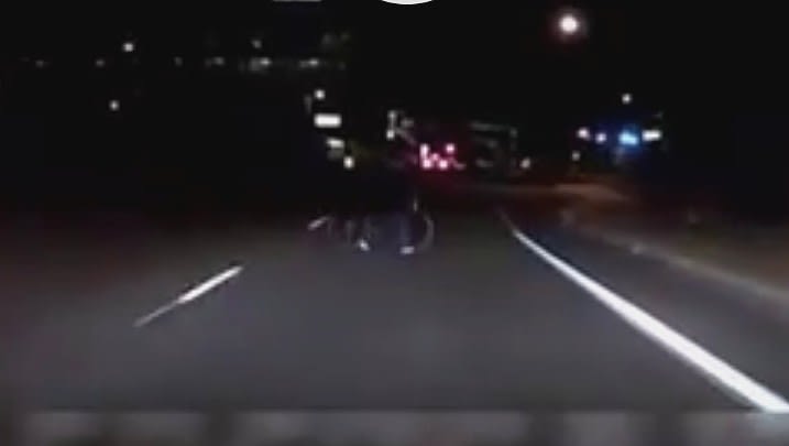

The victim was walking her bicycle across the road. She was already in the left lane for an extended period. She did not dart out of the shadows; the Uber's headlights eventually reached her. The Uber drove past its headlights range, and its Lidar obviously failed to help.
It's a comprehensive failure.
IEEE Spectrum
Screen capture cropped:
IEEE Spectrum, "Although the video shows the pedestrian appearing almost out of thin air, she would have, in fact, crossed two turn lanes, a through lane, and half of the Uber car’s lane before being struck—that’s roughly 42 feet. Walking at a speed of 3.5 feet per second, the design walking speed for traffic light 'walk' signals, she would have been on the road for more than 10 seconds before impact."

Regarding “coming out of the shadows;” locals are starting to draw attention to just how poor the quality of the video that has been released is relative to what it is actually like at night there.
Another dash cam still from that exact spot:
The police essentially aided and abetted Uber in potentially steering public opinion about their culpability in the accident. This is a huge fail, particularly given the example dashcam image with decent histogram equalization.
Uber shot themselves in the foot with their video, because the better video shows that TWO sensor systems failed to operate correctly; the video cameras should have been capable of seeing the pedestrian, and simple change detection would have detected the lateral motion into the car's lane and the lidar likewise should have detected the pedestrian from double or triple that distance.
