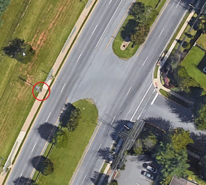

Just to touch on this subject, the picture below shows the main road adjacent to my community. The speed limit is 45 (55-60 is the norm). All of the houses (+/- 500 units) are to the SE. There are none on the NW side of the road.
The red circle is the bus stop, which are spaced evenly along the road every 500' or so. That is 140' curb to curb. The nearest crosswalks are 1/2 mile in either direction.
Don't even get me started on the turning movements and different ways right-of-way is perceived through those intersections. That causes more peril than the traffic moving along the main road.
