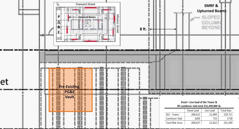

Do you have any other information on the old PG&E vault? What was its function? What is holding it down?
At this point, I think the only thing holding it down is the single floor basement of the tower that flies over the older vault. As far as I can tell the vault is still in service.
The vault was originally installed under 129 Fremont St. 129 Fremont St., for many years was a Foundry or Heavy Equipment Machine Shop. No one knows how old the building was but it is possible it's was built in the 1920's. It had an unusual cribbed floor, with 2in by 12in planks set on the ends, rather than laid flat. It certainly could have dealt with a lot of impact & weight.
Grand Opening of the Transbay Terminal w/ 129 Fremont adjacent.
The building on the corner, 345 Mission, was a clothier "Berkshire Stockings", eventually part of "Hane's" hosiery wahehouse. PG&E occupied both 345 Mission & 129 Fremont St., from about 1970 until the 1989 Loma Prieta Earthquake, when 345 Mission was Red Tagged.
It is possible that during this time of PG&E occupancy, the vault was installed under 129 Fremont St., though it is also possible that the vault was installed when the Transbay Terminal was built in the late 1930's. The basement of the Transbay Terminal on the east end drops to 13ft and the PG&E vault vented through two 18in by 36in openings into the Transbay Terminal basement. The original Transbay Terminal was the destination for both Electrified Streetcars & Electrified Trains that ran across the SF-Oak Bay Bridge. The power demands of the Transbay Terminal would account for the vaults existence.
What originally held the vault down would have been the soil/fill on top of it. It was buried into the Bay Mud, below the historic Bay Fill. I assume this was to avoid excessive movement during an earthquake. Bay fill is subject to liquefaction. It can't be discounted that the vault doesn't have some kind of pier & tie-down system beneath it to keep it level. Bay Mud can be relatively mobile under load. If I recall correctly the seawall on the Embarcadero has been replaced at least twice and there is currently discussion to replace it again. The fill & buildings that sit on Bay Mud pushes bay mud below the fill, out from behind the seawall and into the bay. Since the time when Yerba Buena Cove was first filled in, surveys show the mud may have traveled as far as half a mile out into the bay from the present shoreline.

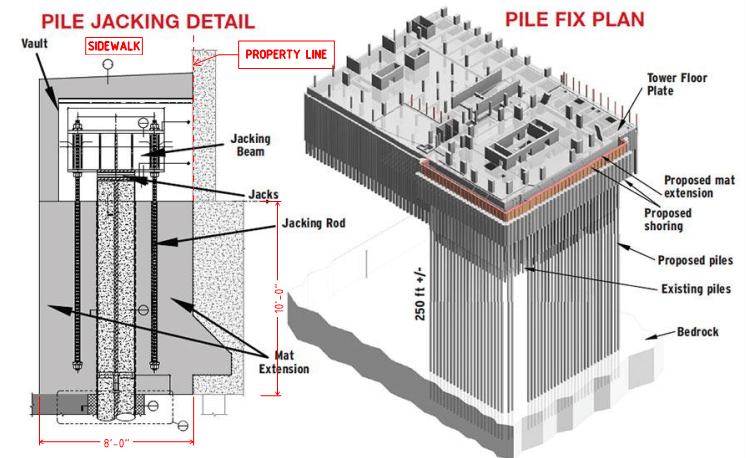

From ENR: Link
ENR said:
Piles would extend up through an 8-ft-wide extension of the tower’s 10-ft-thick reinforced concrete mat—4 ft from the old mat. New and old mats would be connected by chipping into the side of the old mat and coupling new reinforcing steel onto existing rebar.
Based upon the above graphic - assuming it is somewhat to scale - the hydraulic jacks maybe sandwiches of Freyssinet flatjacks, given the small space on top of the new piles and underside of steel jacking beams, and that calculations by Hamburger anticipates 1" immediate vertical recovery.
Long-term tilt-recovery of 50% to 75% - seems 'ballsy':

I had hoped to discover how or if SG&H planned to form the extension of the mat foundation in a monolith on Fremont St & a monolith on Mission St. but there isn't any detailing of this portion of the work. Trying to get a 100' x 6’x 10’ or 150' x 6’ x 10’ block of concrete to slide up and down…, preferably "Up", 22 piles & 30 piles, respectively seems ambitious; especially since they need not all move equally.
Simpson, Gumpertz & Heger (SG&H) will have the foundation upgrade piles drilled and cast, then remove the top 10+ feet and recast a more plumb top of pile section. There is still the issue that the vertical travel up the piles won't be the same for all piles from south to north or east to west. While it is a small amount of travel, each pile must slide through 10 feet of concrete. Will they sleeve the tops of the piles? The upper portion of the steel pile casings, extending down into the soil, will have an anti-friction treatment, to prevent the piles from acting with the soil layers above the Old Bay Clay.

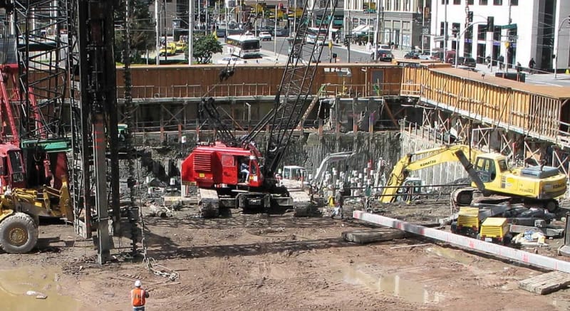

I had remained suspicious. Mainly because the rate of settlement doubled when the last set of struts was removed from the excavation. Any increase in settlement should have taken place when the bottom struts were removed, not the top struts. Before the struts were removed the tower had settled 3.8 inches from Sep 2006 to Oct 2007. By Feb 2008, 4 months later, at the time of the Topping Off ceremony, the tower had settled 2 more inches, at double the rate, (6.07 inches total in 664 days).
Just imagine the weight of 42 floors (more than 75% of the final load), bearing down on the shoring wall while the tower settles 4 inches and then they pop the strong-backs loose from the shoring wall. Thankfully, the shoring wall was directly below the mat and not offset. Does the CDSM wall look to have a high cement content?

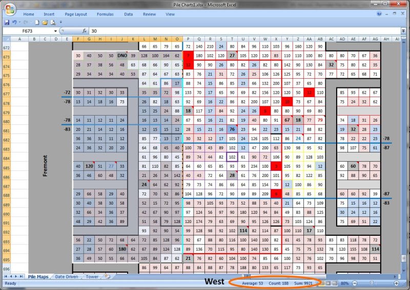

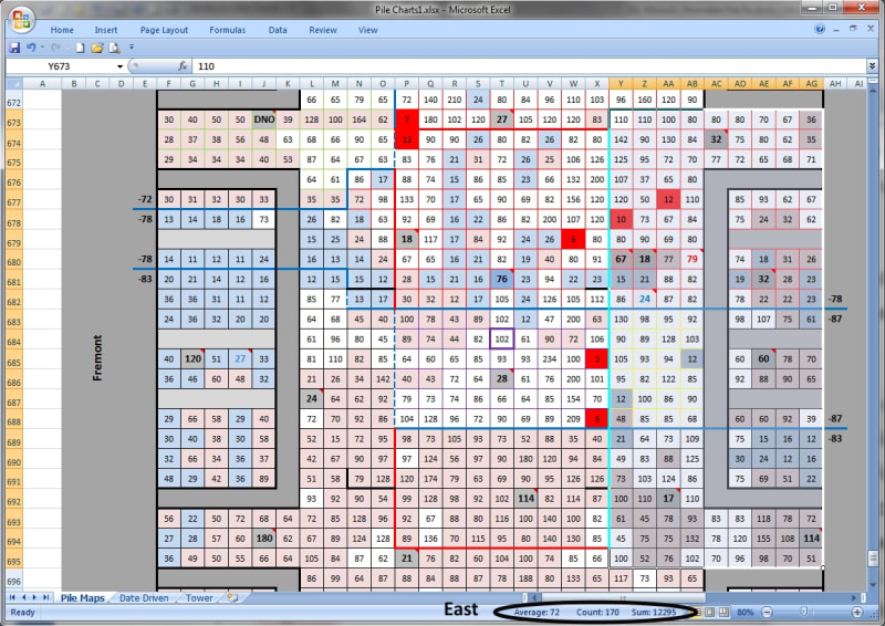

Here are the average blow counts for the piles between the outriggers east & west of the shear wall/core.

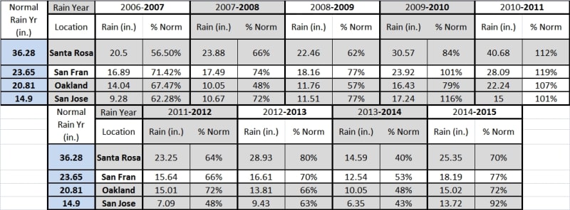

7.1 Groundwater Conditions, (Geo pdf pg. 5)
The report offers a history of area dewatering but does not reference the original Treadwell & Rollo groundwater monitoring from the 301 project. Demolition at the 301 Mission site commenced on 2 Sep, 2005 & Treadwell & Rollo requested a SF Dept of Public Works permit for 4 monitoring well borings for Fremont, Mission & Beale streets on 16 Sep, 2005. This photo suggests the work took place, so where is the “Historical” data? Site demolition is not yet complete
The podium/mid-rise excavation was -60 bgs. I’m somewhat skeptical that the dewatering level for the podium/mid-rise excavation was only -40 bgs.
Webcor Builders stopped dewatering the 301 Mission site on 7 Feb, 2008 and no additional dewatering took place until April of 2013 (350 Mission/Webcor) & May of 2013 (Transit Center/Webcor). The Transit Center was the only project to use Cut-Off walls, into the Old Bay Clay. While the 1000 ft tall Salesforce Tower was being excavated, the SFPUC lost track of the amount of water the contractor was discharging from the site. The response by the SFPUC to inquiry by the SF Audit & Oversight Committee, investigating the Millennium Tower sinking & tilting, was very nonchalant; considering the tallest tower on the West Coast & the largest excavation by a regional public entity, were going on immediately adjacent to one another.

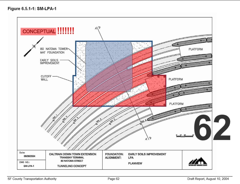

When you read the TJPA consultants predictions for 80 Natoma, consider that Webcor, Treadwell & Rollo, UC Berkeley Prof. Jack Moehle & SFDBI’s Hanson Tom, were all hip deep into this project and yet just 9 months later were giving their blessings to a taller & heavier concrete tower with one less basement level, which included its own adjacent deep excavation.
Prof. Jack Moehle, as chair of the 80 Natoma peer review, (80 Natoma was a Shear Wall Core Only – Performance Based Design), chaired a publicly attended peer review meeting, fielding input from TJPA consultants both in attendance and via phone. Somehow the response given by the former head of the PEER's Tall Building Initiative, to the SF Govt. Audit & Oversight Committee, that he was only reviewing the structural part of the foundation, leaves a lot to be desired. He was supposed to be working for the city, as was SFDBI’s Hanson Tom.
Coincidentally, in February 2005, SFDBI’s manager of Structural Plan Review, Hanson Tom, P.E. was putting the final nails in the coffin of an Administrative Bulletin of SFDBI’s requirements for Geotechnical Reports.

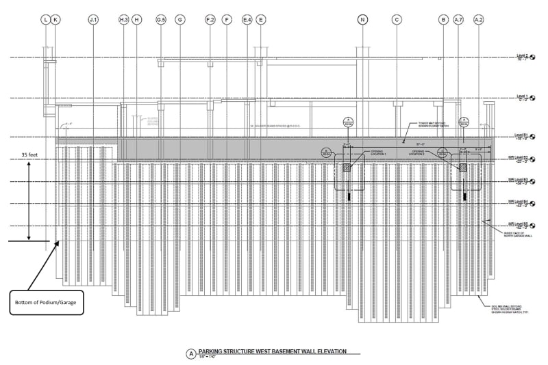

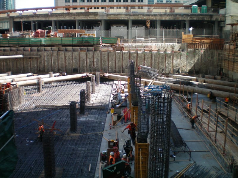

Sub-sidewalk walls of the tower excavation:
The bottom of the tower excavations by Webcor Bldrs. along Fremont & Mission Street contains copious demolition debris, as evidenced by every subsequent boring. What was the quality of the backfill used for the PG&E vault buried under the 3 ft. cantilever slab? I’d expect PG&E would have required inspection services during the backfill of the vault.

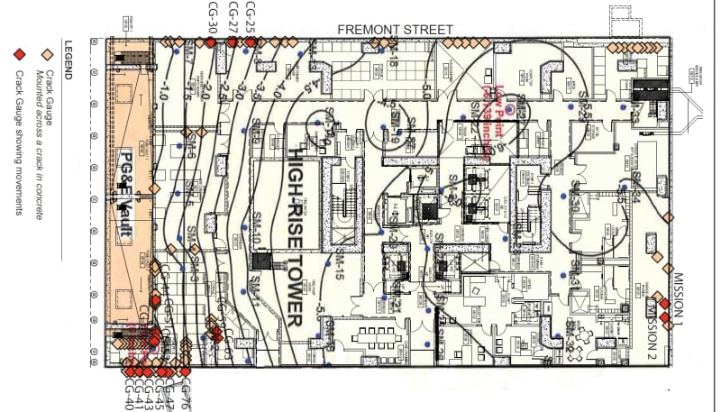

Looking at Arup’s placement of crack monitors, and which have been the most active, alongside the differential settlement contours; it is easy to see that there is already an accumulation of stress between the 3 ft. cantilever slab & the 10 ft. mat. The walls in the tower basement, immediately adjacent to the cantilever slab, that in effect, buttressed the cantilever slab, have cracked considerably. The cracking would have been much worse, were it not for the tilt/settlement at the northwest end of the tower. The question is how much upward bending stress can the cantilever slab tolerate? If the cantilever slab were to crack where it joins the 10 ft mat, the crack could potentially travel from one point of confinement to the next, in the direction of the mat. Or from the reentrant corner, where the 3 ft. cantilever meets the 10 ft mat foundation, then up through the mat, to the outside edge of the sloped SMRF & upturned beams.
I would repair the existing cracks in the basement before applying any load to the upgrade piles. If you don’t agree, I’d love to know why.

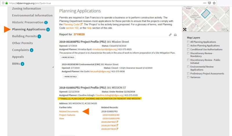

geochase - It looks like SF City Gov. has updated the portal I was using.
Go to the SF Assessor's "Property Tool"
Link
Click on the Map for 301 Mission
Click on "Planning Applications"..., then "More Details".
Click on "Related Documents"
“Voila”
