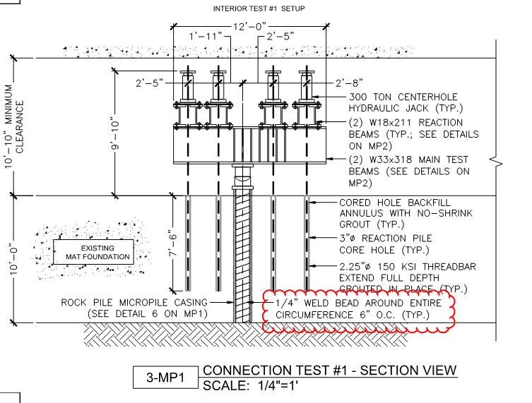

Here are links to the drawings for the test piles designed by LEAR or perhaps more precisely by Hayward-Baker. Link

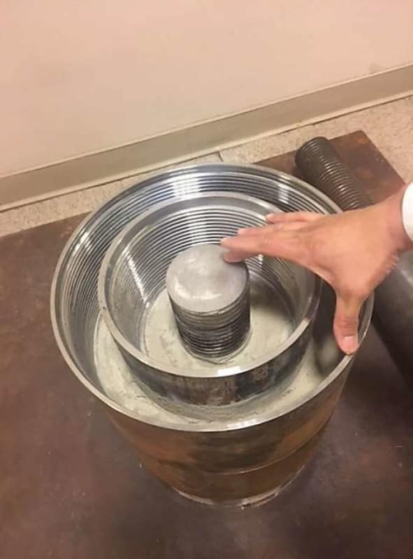

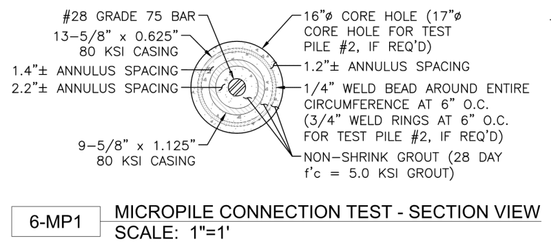

From epoxybot's link above - Link - the micropile cross section is pretty impressive:
#28 grade 75 bar, 1-1/8" thick wall x 9-5/8" dia inner casing, weld beads around outer casing at 6" c/c:
It hardly seems like a micropile.
I am posting a clarification to the TEST PILE PROGRAM - it is actually a MICROPILE CONNECTION TEST PROGRAM, and as the name implies, is a test of the transfer/connection between the existing mat and the proposed micropiles.
Micropile TEST #1 is only 10 ft deep - cored into the existing 10 ft thick mat foundation. This test uses 1/4" weld beads around the outer casing circumference and tested to 2000 kips - yes 2,000,000 lb.f!!!
If TEST #1 is NOT satisfactory, then TEST #2 - with 3/4" weld rings to the outer casing - is tested to 2000 kips.
