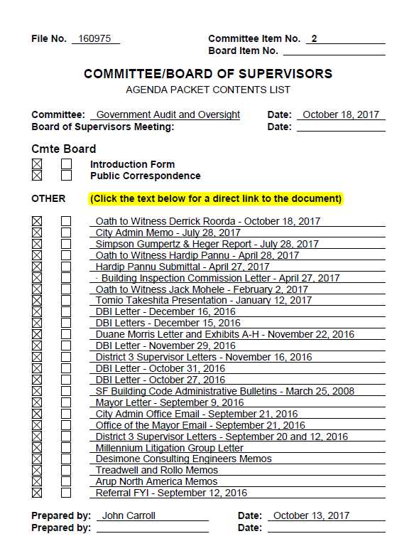

If you want to take a close look at what SF Supervisor Peskin has accumulated you can download all 93mb here. Link
Here is an table of contents.

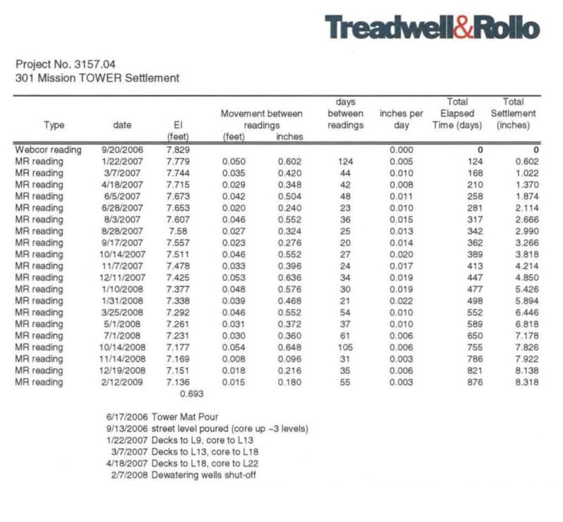

There has yet to be any disclosure by Millennium Partners, DeSimone, Treadwell & Rollo or Webcor Builders as to why the building is sinking & tilting. I have been through the information the SF Government Audit and Oversight Committee has on their site & I guarantee you that they are not being as forthcoming, as they could be. Even the SG&H 2017 "Supplement" commissioned by the SF Mayor's Office - 301 Mission Seismic Safety Committee is flawed. For starters the bore hole used to characterize all the piles isn't even under the tower. It is 25 feet to the east of the tower under the podium. Why not use any of the 5 bore holes that are under the tower? Other than that they pass through more clay and less sand at inappropriate elevations.
Spending millions of dollars on an exploratory remedial program when you have yet to fully examine the cause is imprudent. To what extent the HOA is being led down this road by Millennium Partners or other parties is a mystery. If it is a judge who is urging the homeowners to work towards a remedy at the expense of knowing all the facts, then that is unfortunate. I can guarantee you Millennium Partners, DeSimone or Treadwell & Rollo or Webcor Builders all know why the building is tilting & rotating.

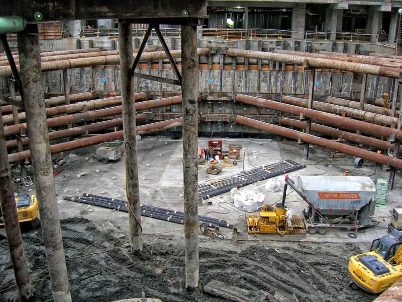

If the Mat foundation is already cracked as Ron Hamburger at SG&H speculated in 2014, then where do they begin installing piles, since coring large diameter holes in the mat "could" make matters worse? The HOA should at least do some Pulse-Echo Testing of the foundation before they get too far into the piling scheme. Having to position & re-position equipment in a basement in order to satisfy a charted installation designed to prevent additional damage to the mat could greatly increase the time & expense. Has Millennium even told them that corrosion control is going to be needed long-term? The ground water is brackish. It isn't particularly expensive but it is a consequence of cracking in the foundation.

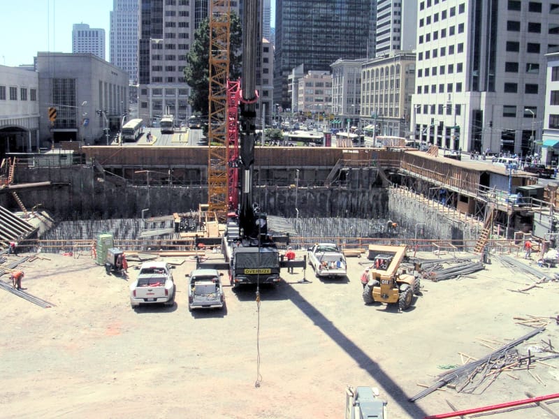

Just to get started, the Millennium Tower is not built on top of fill that is at risk of liquefaction. The basement penetrates the fill.
It looks like The Millennium Tower HOA is moving forward with an objective to stabilized the Millennium Tower. LERA & Swinerton Builders are the team overseeing the work. Documents on file for 301 Mission at the SF Planning Dept. website show they will be coring possibly two penetrations through the 10 foot mat foundation at the north end of the tower, approx mid tower.
They will also be opening up the the wall of the parking structure at parking level 2, cutting two 3 ft by 3 ft openings, in order to determine if the tower has come to rest on the soldier piles of the CDSM shoring wall between the tower & the podium structure. In Treadwell & Rollo's 2005 Geotechnical Report, T&R had recommended that since the CDSM shoring wall was to be directly beneath the mat foundation, the shoring wall should be at least 12 inches below the mat, to avoid interference.
The tower may or may not be resting on the shoring wall. If it is, that will at least give engineers something to think about but if it is not, then they will have to consider the consequences and how much time they have before it does and matters become more critical. The soldier piles were about 1 foot higher than the CDSM shoring. In hindsight one would think the developer's team ought to have given thought to cutting the soldier piles down, since Treadwell & Rollo's second estimate for additional settlement of the tower was still a large number AND they knew or should have, well before the last level of the parking structure was poured, that shoring wall interference could be a factor. As soon as the last struts of the podium were removed the tower settlement accelerated. The building was sinking at 0.020 inches a day.

In the document package at the SF Gov website for the public hearing by the Government Audit and Oversight Committee, initiated by SF Supervisor Aaron Peskin, there is vague mention of the PG&E utility vault and the Millennium Partner's legal team geotechnical engineers, Sage Engineer's efforts to calculate the subgrade modulus of the soil beneath the vault. Later in the SG&H 2017 supplemental seismic report, it is less clear, stating Sage is working on providing the subgrade modulus for the "soil supported" cantilever slab at the south end of the mat foundation.

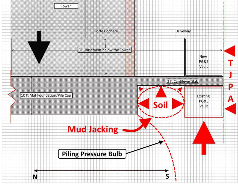

It would be easy for most people to be confused as to what is being discussed in either instance because the B1 basement of the tower was also constructed with an almost identical PG&E utility vault directly over the one that was buried beneath the former 129 Fremont St. before the properties on the block were merged into 301 Mission for the condo project. Sage Engineers & SG&H might want to consider 4.3 to 4.6 x 10-6 as a modulus. Not that I have any basis for suggesting a proximate soil subgrade modulus but I think that might be a reasonable approximation of the Young's Modulus of 5000 psi compressive strength concrete.
The subgrade modulus is indeed a tricky number. The shoring wall for the Transbay terminal is directly along the south (100 ft side) of the PG&E vault and is 90+ feet deep, followed by the buttress wall extended to bedrock, while the CDSM tower/podium shoring wall is 80 feet deep & directly at the east end of the vault, the north side of the vault has 10 to 15 feet of open soil (under a portion of the cantilever slab/B1 Basement) between the vault and the mat foundation and the mass of the soil enveloped by the piles below the mat. Then only portion not completely influenced by confinement is the west end facing Fremont St. here the shoring wall is no where near as deep, perhaps 35 to 40 feet SF Datum.
Using a round number of 100 pcf for the soil removed for the old vault and that of the new tower basement, the soil supporting the old PG&E vault is about 2.5 to 3 million pounds light of equilibrium. If one was looking for a reason why the building was tilting to the north..., a type 3 lever & fulcrum (correct me if I'm wrong) might have something to do with it. "Outrigger/Cellular Box Grade Beam"~®" any suggestions for a more elegant name?
Speaking of equilibrium, once the excavation for the tower basement was fully compensated by upper floors, the building was "by weight" perhaps only 3 stories tall when it started sinking.
One really has to wonder what is being done to resolve this issue since PG&E needs to show due diligence in defending their easement rights. When ARUP inspected the basement of Millennium Tower, they were not granted access to the new PG&E vault in the B1 basement. When one considers that half of the 103 crack monitors are positioned on this end of the building, where the 3 foot cantilever slab joins & prys away at the mat foundation, you have to wonder what the condition of the concrete inside of the vault looks like. There was some strange activity along the 301 Mission/TJPA property line back in March 2017. The underground work looks like it extends beyond the 5 ft TJPA/301 Mission easement but there doesn't seem to be a permit at SFPUC, SFDBI or SFDPW. I would hate to think the TJPA & Millennium were doing corrective work through back channels without the public knowing who is paying for what.
The screen wall in the photo approximately represents the limits of the 5 ft TJPA easement onto the 301 Mission property line.

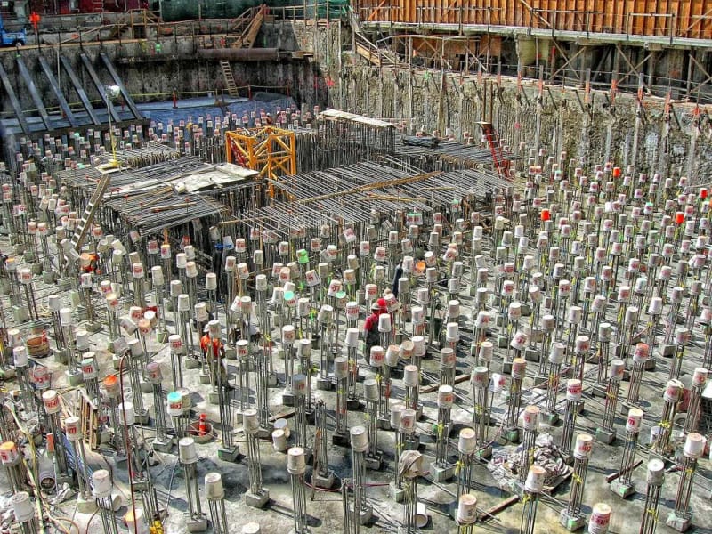

If one takes a look at the pile driving record for the tower and maps it out in excel it really doesn't look too bad. There are vulnerabilities (soft piles) and the mat of the heavy tower does deflect where these piles are located but it is tough to conclude that these appear in sufficient numbers, in group to explain the westerly tilt. At least not without some precipitating cause. Treadwell & Rollo indicated in their letter responding to an inquiry by SFDBI's Raymond Lui, that the extended dewatering of the soil during excavation might explain the settlement, it seems that would be at least one possibility. Fremont St & Mission St both appear to have settled at some point proximate to the timeline of the project and Webcor Builders took out a SFDPW permit to reset manholes on Mission St in 2009 while closing up the project. The manholes on Mission St have been paved over & later reset at least once again since 2009.
What about the shoring walls of the tower? Do they contribute to the tilting? The shoring walls on Mission & Fremont are comparatively shallow, perhaps -35 to -40 feet deep from SF Datum(the base of the tower mat is -24 ft). The eastern shoring wall is sandwiched like a keel, between the tower & podium is between at 80 & 90 feet deep and backed up by the 57 ft deep x 5 level basement parking garage. Finally the south end of the tower doesn't have a shoring wall but does have a concrete bubble beneath it bobbing on Young Bay Mud.
In one of my early posts I pointed out the 40 or so, "strong-backs", for lack of a better name, that overlay the top of the soldier piles on the tower/podium shoring wall. I assumed they were tied to the tower mat foundation and welded to the soldier piles to provide additional cantilever support during early excavation. Later I realized they needed to float, in order for the building to be allowed to settle evenly. So were they floating or were they welded to the soldier piles? The tower was at 42 floors when the last of the cross bracing struts & strong-backs were removed. The lack of soil directly behind the upper tier of lagging caught my eye early on as well but I don't know how much to attach to this. Did the soil drop from the bottom of the mat foundation as a result of aggressive dewatering? The following photo is from end of May or early June 2007. The building had settled about 2 inches.

Then again the Transbay excavation itself can only effect soil at a given distance from the excavation. The excavation was 60 feet deep. At 30 feet if you draw a 45 degree angle back up and towards the tower, it intersects the side of the 10 ft mat foundation. That is why Millennium bangs away at dewatering because the areal effects of dewatering can be larger. It is just that there was so little rain fall during the Transbay excavation, it may be difficult to point to groundwater gauges and blame the TJPA. 40% of downtown San Francisco's ground water comes from leaky sewer pipes. Welcome to the Golden State!

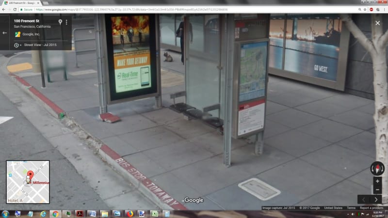

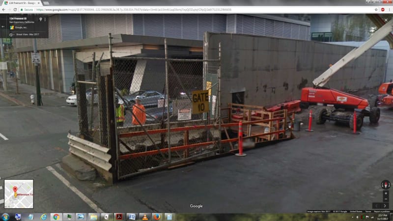

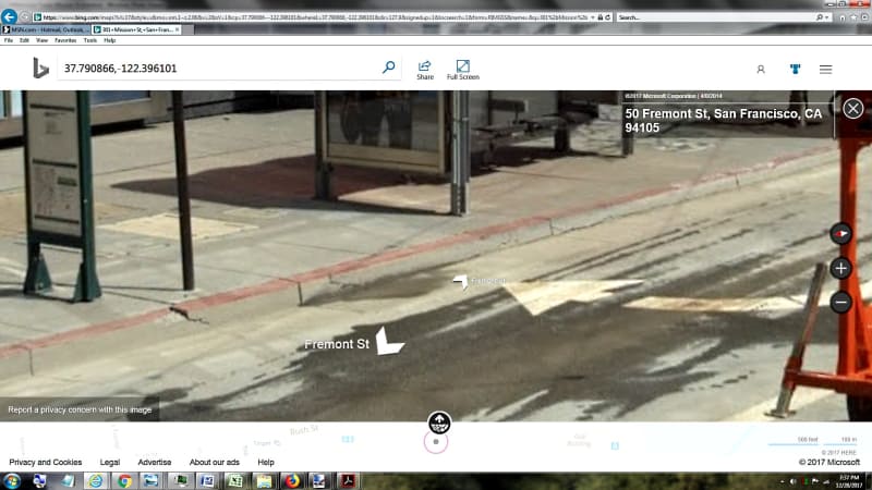

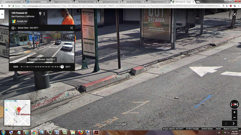

In 2014 the City of SF replaced the sewer line in Fremont St, claiming it was old and had probably needed to be replaced for some time but in 2011 in preparation for the Transbay Center project, utility lines were run immediately adjacent to the sewer line and if it was in such a bad state, it would have been dealt with then. It is more likely that the sewer line was damaged by the rotation of the Millennium Tower. Here is an April 2014 on the Microsoft Map page suggesting rotation, more are found on Google Maps in Nov. 2014 & later. The curb in front of the bus stop on Fremont St was in a preliminary state of failure. Even for the curb to be in this condition in 2014 took at least a year or two for this degree of deterioration to manifest. It has progressively been snapping like a candy cane for the last 4 years. It begs the question, what do the people at the SFPUC & SFDPW know and how long have they known. Has anyone been hurt at this bus stop? Why has it gone untended for so long? The building appears to be plowing a 35 foot wall of fill and mud in front of it.
April 2014
Nov 2014
July 2015
Oct 2017

SG&H describes the piles as having 8ea x 23ft-6in of #8 or #9, suggesting 12ft-3in could be removed with 12ft-3in left to develop pile capacity. In fact there are 4ea x 23ft-6in of #8 & 4 ea x 7.5ft #9 bars grouted into 17.5ft sleeves. It isn't so much that there are a large number of piles that were cut but that SG&H really fails to explain with clarity how the piles are up to the task or how many are deficient. There was something else that was off about the report but it escapes me at the moment.
