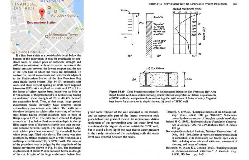

Clearly prudence was exercised concerning the effect of weight of the building and ground pressure on the adjacent basement shoring by the General Contractor, Webcor Builders. Before they began excavation of the parking structure basement they bolted heavy steel strongbacks to the footing of Millennium Tower & then welded them to the solider pile/CDSM shoring to support the upper reach of the Westward diaphragm wall. It does appear that they used used tie-backs lower down on the shoring wall. Blue Dots in photo: Link The piling contractor augured each pile 40 feet from a working elevation of about 10 to 15 feet below grade, so there wasn't a lot of upper pile confinement generated from the pile driving. Since it appears that pile driving started on the North side of the foundation, this would be where the piles with the least confinement & lesser capacity would be located. It just seems that with less skin friction due to auguring that the potential for shorter piles to heave is greater once remaining and/or deeper piles are driven & reach the deeper soil that was undisturbed by the augur. The piles range from 61 feet to 90 feet according to SFDBI Raymond Lui. So perhaps only around 20 to 50 feet of that is below the mat foundation. If you look at the cross section illustration De Simone used for a SEAONC presentation of the project, the scale of the piles beneath the tower is more on the order of 150 feet deep, when they should be just a bit deeper than the podium basement foundation.
The 2003 Final Environmental Impact Report, Page 247 Link included an acknowledgment that dewatering was a concern on this project for which the the City of SF was empowered to enforce a requirement for ground settlement monitoring, special inspections & even a halt to the work if settlement was beyond anticipated values. So when the SFDBI testified that they had no way to compel the developer to include a geotechnical engineer to be part of the PEER review, they are not being completely honest. The dewatering/ground settlement monitoring - special inspections could have compelled the developer. It seems SFDBI passed on this Special Inspection, otherwise they would have (?should have?) known a month after the tower foundation was poured that the structure was on the move and long before the podium basement excavation commenced. To later sign off on an occupancy permit, having failed to implement a monitoring scheme or failing to "INSPECT" the special inspectors reporting is just seems like double negligence. Perhaps too much myopia from staring at plans all day?
