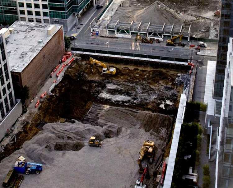

Photo of full excavation next to Millennium Tower - Link
In photo (B) note the high concentration of soldier piles on the left side of the photo. In photo (C) the soldier pile are capped with a steel beam & rakers tie to a stepped perimeter wall. What is different about this section of the shoring?

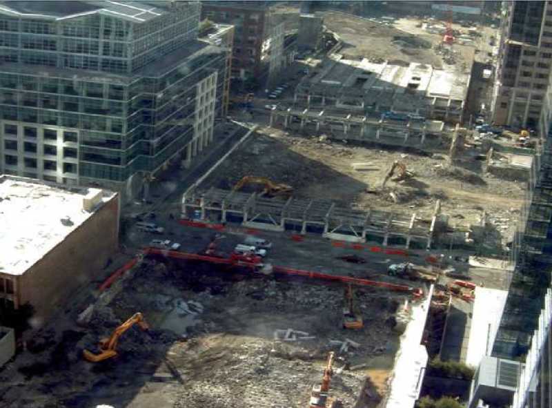

In this Old Tranbay Terminal demolition phase photo you can see that ground water is somewhere around 7 to 12 feet below grade. Millennium Tower is to the right in the photo. The area was used for staging for most of the Transbay Center project. Soil stabilizing fabric was laid & a waste slab poured.
