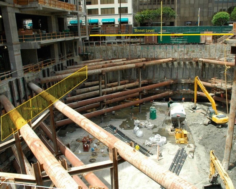

Here is a link to a cross section of the soil conditions commissioned by Transbay Joint Powers Authority TJPA for the neighboring Transbay Center. Link TJPA are a greater bay area, regional authority, so you can imagine the other parties would love for the Transbay Center to be partly/mostly to blame for the Towers settlement & tilt. Considering the circulation of water in & out of SF Bay, the ground section should largely be indicative of what lies beneath the Millennium Tower project. The Tower takes up the block between Fremont St. & Beale St. Horizontally flip the building section below, to overlay the soil cross section in the above link to get an idea what is going on.
The parking garage basement of the Mid-Rise Tower was a 75 foot deep excavation. The garage foundation looks to be sitting on a lens of clay while the Tower foundation is on sand. The High Rise sits on 950 - 60 to 80 foot piles with a 10ft thick pile cap with a 35ft to 50ft deep excavation. Unknown is if the length of the piles is quoted as from original ground, top of the pile cap or from excavation grade.
Here is a link to a paper on the structural design of the tower. It doesn't mention the extensive use of GFRP. Link You can see the GFRP in the connection of the Steel Link Beam; here Link & again here Link
This link from CRSI gives some good details about the overall project. Link The first photo on the page gives a good idea of the concentration of piles under the tower. The 4th photo in the series is the podium/mid-rise basement/parking garage. The basement/parking garage photo is from around Summer 2007 and by this stage the very heavy Tower was topping out. The basement used an integral waterproofing admixture, so there isn't anything to stop water once the cracks grow too large. Here's my best 'eye-ball gestimate' of where the 10ft thick pile cap is in relation to the garage excavation. Since the building is leaning away from the garage, you have to wonder if this is when the tilting started. The tower foundation is supposed to be designed for 14kpsf. Wouldn't this be a vulnerable time for the tower to take on a slip circle tilt? If 7ft diameter concrete piles 200ft deep & anchored in bedrock on the South side of the property aren't preventing a Northern tilt, then how is a 75ft deep concrete box on the East side of the property, possibly built on top of a clay lens, suppose to prevent the building from tipping to the West?

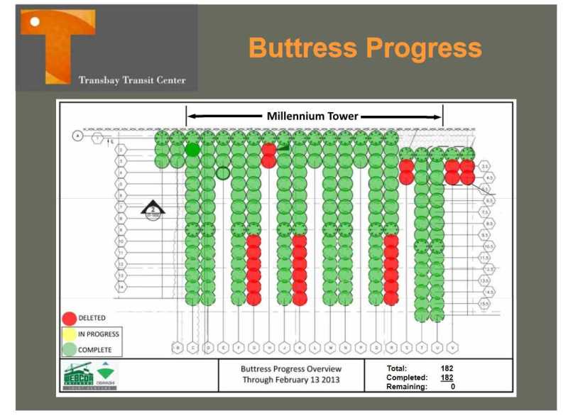

The Tower was completed in 2009 and the Transbay Authority, TJPA began excavating next to the Tower in 2011. Before doing so & exclusive to the Millennium Tower/TJPA property line, TJPA took the preventative measure of drilling 181 7-foot diameter overlapping concrete piles all the way to bedrock at a cost of $58 million. Link The Transbay Center excavation is 65ft deep and runs 4 blocks, including along the South side of the Millennium property, with both the Transbay excavation & Millennium Tower project ending at Beale St. Link According to Millennium Tower's attorney (HOA?), the Transbay site has dewatered 5 million gallons/month for most of its duration & the water table has dropped 20 feet. As the TJPA states, their hole in the ground is the size of 120 3 meter deep Olympic sized swimming pools. Then again thier dewatering is enough to fill over 79 of those pools to date. Still, the HOA at Millennium Tower should be worried when the TJPA finally stops dewatering because those cracks in their basement garage are going to be fountains when the water table is recharged. If the dewatering is affecting the clay maybe the Tower will rise back up when TJPA stops dewatering? [bigsmile]
The tower had sunk 12 of its 16 inches before the Transbay Center excavated next to the building. Refutation from the TJPA: Link As TJPA sees it, the Tower is just too heavy & sinking into the mud. They are probably right. The Old Bay Mud may be behaving like a pseudo-plastic and yielding gradually, while the garage sits on a (fulcrum) lens of another clay deposit and the pile cap of the tower is squishing the water out of a sand pile.

According to one observation by a geotechnical engineer, sorry I didn't save the link, one problem is that the Transbay Authority, TJPA did too good of a job with their secant pile wall. The wall does too good of a job of resisting earth movement and without similar resistant walls on the North & West sides of the Tower, North & West is where the ground is shifting.
The Transbay Authority didn't just build a wall, they heavily buttressed the wall. This is why Millennium Partners & Millennium residents focus on dewatering, because the wall works. Millennium residents also accuse the Transbay Authority of attempting to hide the shifting but it may be that the TJPA was unaware of the preexisting condition of the Tower's accelerated settlement when they entered into an easement contract with Millennium Partners and were alarmed at what they were seeing from early monitoring results. My guess is TJPA approached Millennium Partners and Millennium Partners wanted to keep the situation private.
