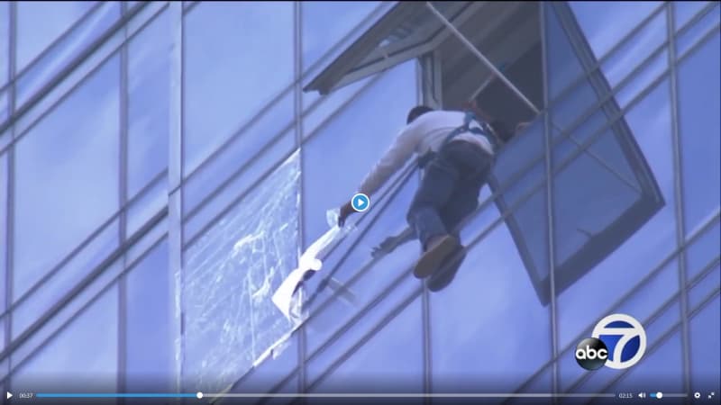

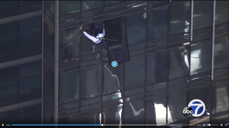

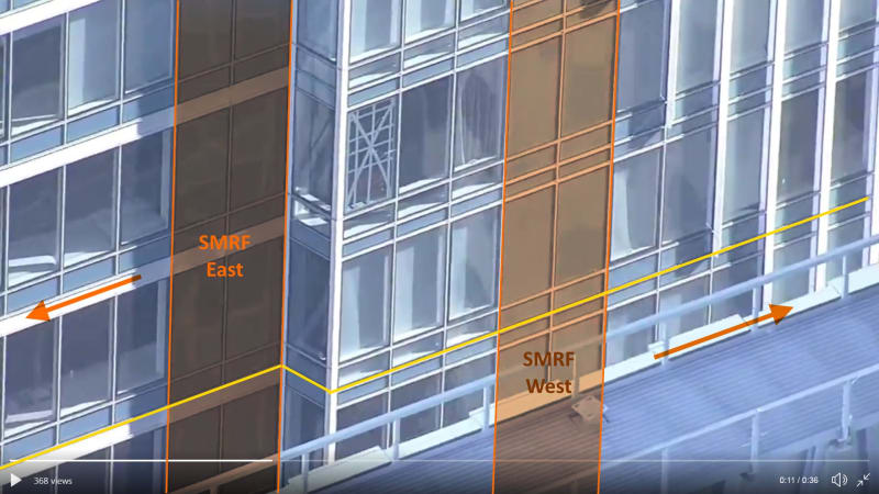

No doubt most of you here on Eng-Tips / Engineering Failures & Disasters Forum have heard or read in the news about the cracked window on the 36th floor of the Millennium Tower. The SF Dept. of Building Inspection was none too pleased to hear about the cracked window by way of an inquiry by a News Reporter asking for comment. They followed up with a dire letter, requiring a laundry list of inspections & reports & sidewalk protection with the possibility of issuing a Yellow-Tag on the building if the Millennium HOA failed to exercise diligence. It doesn't help that currently the Window Washing Crane for the tower is out of service and the part is on back-order. One of the news reports now gives the total depth of settling as 18 inches. Two more than a year ago.
Video: Link
Yellow Tag: Link
Crane: Link
The crack may just be a result of a defect but it may also be true that the defect was triggered by the stress the building is experiencing. While unlikely to have any had any impact on the window failure, the crack is directly above the location in the basement where the pile connection test is/was taking place.
I have pinpointed the location for your curiosity.
The window is on the outside corner of a flat slab and is the outside pane of a double pane window.
The window is on the north face towards Missions St. This is the direction with the 2+ inches of lean.
Attempts have been made to inspect the window using a drone but the drone lost its GPS signal & crashed 3 times. They will now have a field technician/engineer repel down the side of the building to inspect & secure the window with tape.

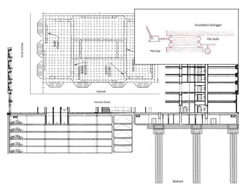

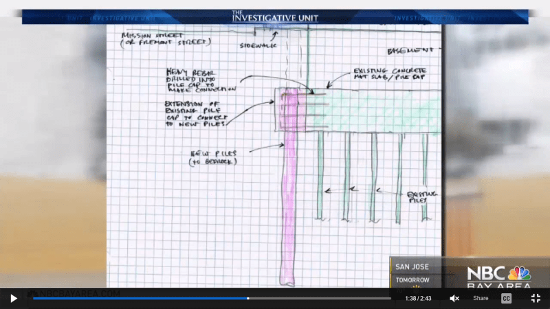

There is also another building stabilizing scheme being mulled over. One that approaches the work from the north & west perimeter of the building. It involves installing piles down through the city owned sidewalk and supporting the building on an extension of the foundation.
Video: Link
This isn't much different than a scheme I toyed around with last year.

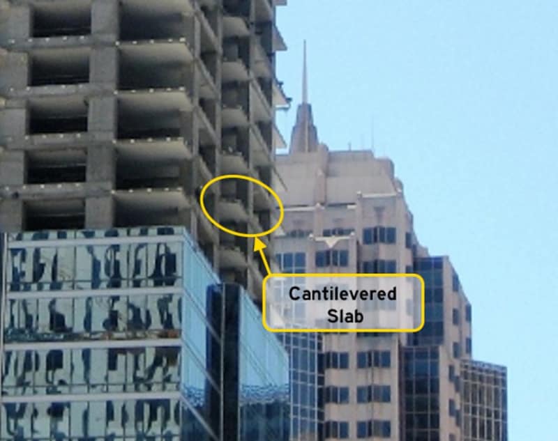

It just puts a lot of stress on parts of the building that might just cause other problems. For instance the 3 foot thick cantilever slab off of the 10 foot thick mat foundation on the south end of the building is already under great strain. It doesn't help that the Older PG&E vault below the 3 foot cantilever slab, likely is holding up the southwest corner of the tower.

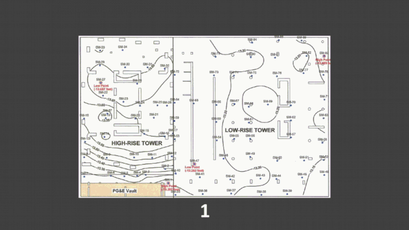

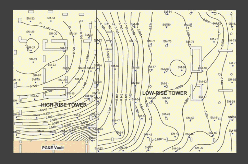

Contour Elevation gif 2010-2014
Floor Elevations gif 2010-2014

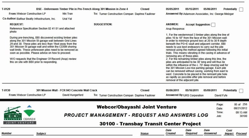

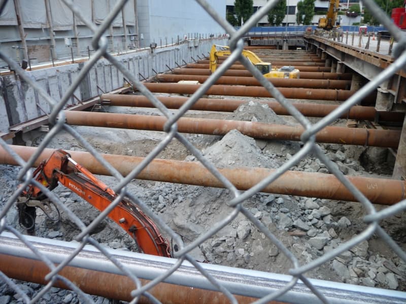

As extensive as his research was, he may have missed the early tests done on timber pile extraction and settlement. The old Transbay Terminal adjacent to the Millennium Tower had an 11 to 13 foot deep basement. Demolition of the old terminal would not have represented any great change to the soil beneath the terminal. More so because it was incrementally demolished and back-filled almost to street level.

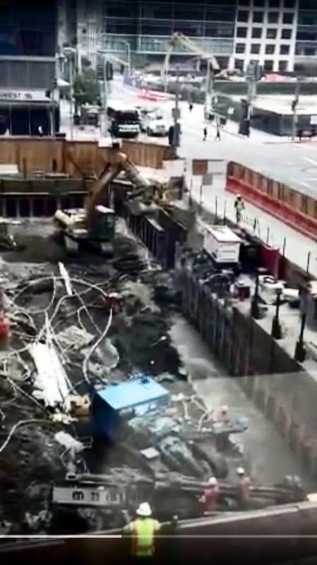

Testing:
With ground cleared of the old terminal debris - on the west end of the TJPA, they tested a number of CDSM shoring shoring wall schemes, while on the east end (Zone 4) aka Millennium Tower zone, they performed a timber pile extraction & ground effect test. An area of piles was select and ground elevations recorded & instrumented, then a 30ft to 40ft pile was extracted and areal ground subsidence recorded. They also performed this test while quickly following up with tremie placed @50psi bentonite/concrete. I believe the method chosen for removing the timber piles was that piles could only be removed one at a time and the hole filled with tremie concrete before the adjacent pile could be extracted. When the pile extractions were done adjacent to structures with shallow basements/footing or other sensitive criteria, they vibrated casings in place, extracted the piles, filled the casing with concrete & extracted the casing (one at a time). Indeed, this casing method was used on 3 timber piles adjacent to the buried old PG&E Vault
between the TJPA & Millennium Tower before the CDSM shoring wall was placed.

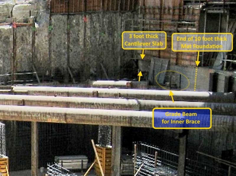

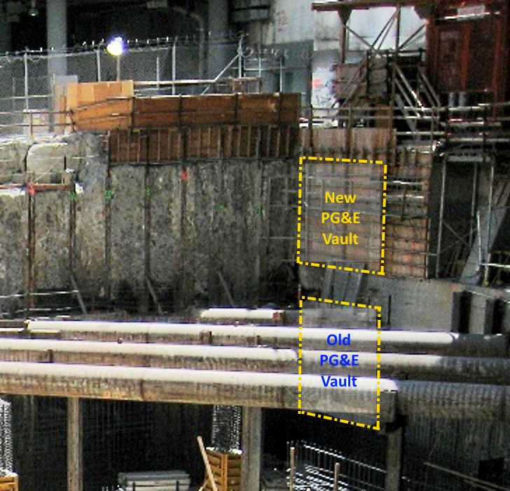

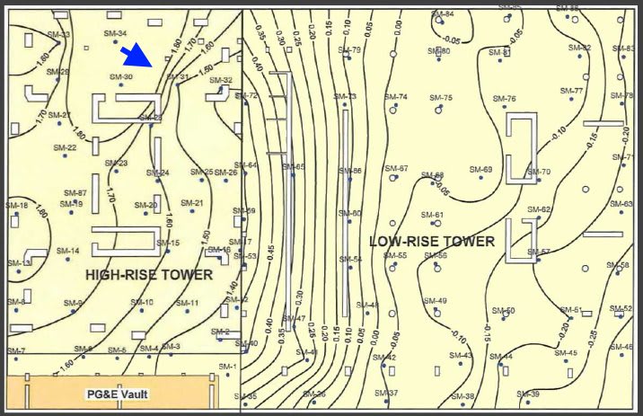

In Carl Chan's Millennium Tower Supplement, he identifies an area beneath the tower as an "abandoned shoring wall" this is actually the 25ft(wide) x 3 ft (thick) Cantilever Slab that extends off the south end of the tower foundation & flies over the older PG&E Utility Vault that remains buried between the tower & the TJPA.
It is confusing because an identical PG&E vault was built directly over this one, in the basement of the tower on level B1. From the end of the southern end of the tower foundation a section of ~grade beam~ is incorporated into the foundation to accommodate the innermost corner brace. There are drawings showing the shoring wall stepping up to fill the space below the 3 ft cantilever slab.
The time period in the fall of 2010, that Carl Chan denotes as a period where the tower ceased to sink is actually noted by Arup as a time when the tower briefly began to settle back in the opposite direction and can be seen in the contour .gif posted above and identified by this signature slide. This is when the tower returns to its north-west settlement.
It takes place early in the TJPA's monitoring of the tower at a time when they were recording every 30 to 60 days. The tower most definitely had not stopped shifting. About the time the tower returned to its West-North-Westerly tilt there is an anecdote that an occupant in the tower heard a loud bang and felt the building shake. Perhaps this is when cracks developed in the north-west corner on levels 4 & 5 of the parking structure. This corner also represents where Webcor Bldrs. had water intrusion problems, as shown in the photo (fig. 3, pg. 3) in Carl Chan's Millennium Tower Supplement. It is worth noting that the transition zones in the different soil layers are punctuated by crust layers that can yield more resistance that the the same soil layer below the transition. The depth of the crust layers are fairly easy to identify in the 4 indicator pile tests found in the files the city has provided during the Oversight Committee hearings. There was concern about penetrating the crust layer as the pile capacity could drop.

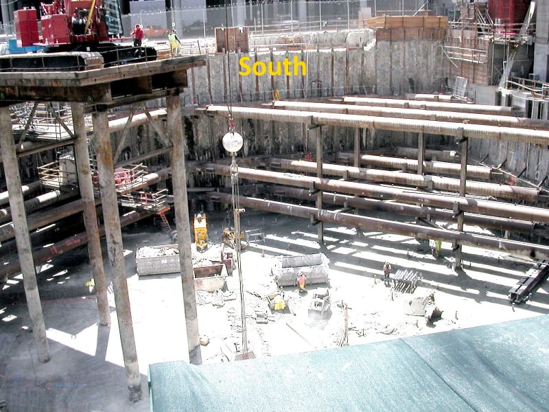

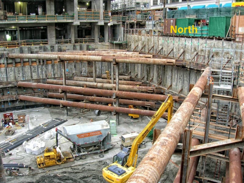

Returning to Carl Chan's observation of the podium excavation shoring, one has to wonder how much stress the bracing was under. It appears that every panel of the entire east CDSM shoring wall showed signs of distress, as evidenced by the degree of water intrusion. Meanwhile there is virtually no water intrusion on the shoring wall beneath the tower.
East Shoring Wall:
North Shoring Wall:
South Shoring Wall:

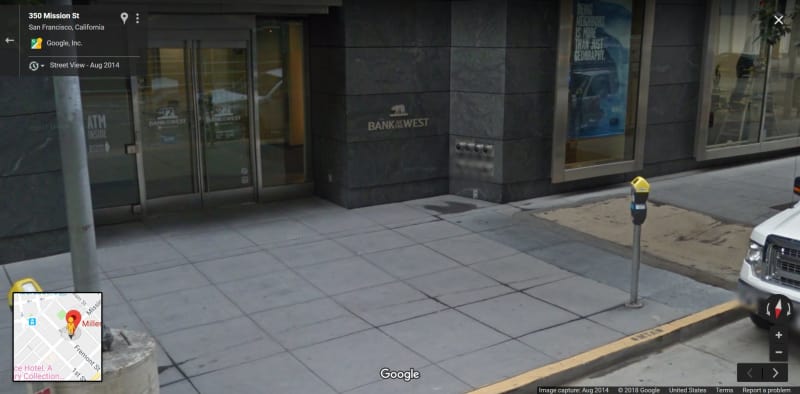

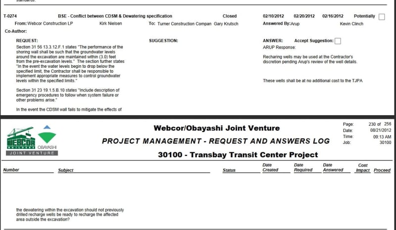

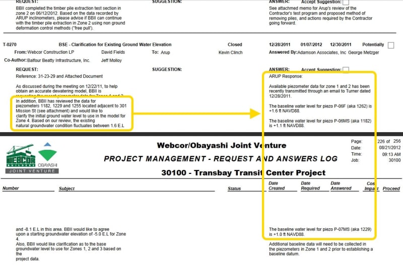

When one goes looking for an outside groundwater influence that may have accelerated the sinking of the tower, one has to look at the work that took place at 350 Mission St.(Webcor Bldrs.), before looking to the TJPA. 350 Mission St. began dewatering in May of 2013. They certainly didn't install a CDSM shoring wall 105ft deep into Old Bay Clay like the TJPA. While the TJPA started dewatering in Zone 4 shortly after 350 Mission, just how much "Areal Effect" could this dewatering have with a CDSM shoring wall 105ft deep into Old Bay Clay backed up by a 7ft thick secant buttress wall drilled 260ft down & socketed 10ft into bedrock.
350 Mission End of April:
TJPA Zone 4 - Aug 10 2013
The specification for water draw down outside the TJPA excavation was -3ft based on established piezometer readings, the dewatering contractor was required to recharge the groundwater if the levels dropped below -3ft. The big "IF" is whether this was adhered to.
Dewatering:
Window Update:
Permits were issued to remove wall & window sill materials in units 35B, 36B & 37B to inspect the curtain wall. The earlier Fire-Stop problem was in 31B and is at the same vertical building line. The section of floor slab is between the two sets of SMRF's which are slightly offset, accounting for the recess in the building facade. The Window offset is immediately adjacent to the east inner SMRF.
Reinforcing the External Pane of 36B [surprise]

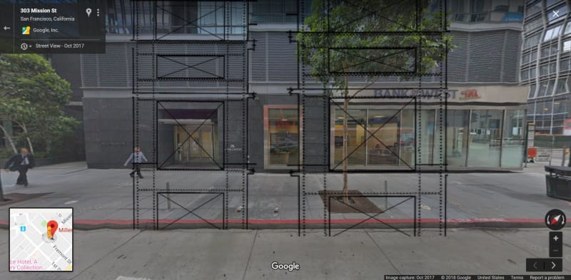

There have also been problems at street level. The sidewalk in this area has been opened up, excavated & replaced. The towers external fire hose connections are located at the base of tower at this building line. There is also a water spigot that has a history of leaking. The HOA in 2016 commissioned the installation of geotechnical instrumentation in the sidewalk in this location.

Do you have any other information on the old PG&E vault? What was its function? What is holding it down?
