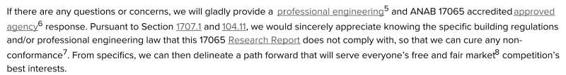

From the cover sheet:
Sounds like a group that expects to be challenged and had a lawyer craft this verbiage to shield them.

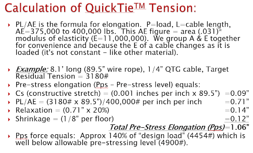

Something else I am still hung up on too is how much tension the anchorage will actually experience and how the pre-load/post-tensioning amount is determined. The TER says that the tensioning amount is determined by the RDP (registered design professional) which I believe refers to the delegated engineer designing the cable system in this case (which is the manufacturer). The TER says the pre-tensioned level shall not exceed the allowable tensile capacity of the cable assembly. The only info I received from the manufacturer about how much pre-tensioning to expect was a screenshot (shown below). The majority of the cables they have specified for this job have an allowable capacity of about 6.5 kips. The submittal/delegated design has several cables loaded to 100% of this capacity. If the cable needs to be pre-tensioned approximately 140% of the design load (6.5k in this example), the cable would need to be tensioned to 9.1 kips. This number exceeds the allowable tension capacity of the cable assembly and violates the TER, right? So does the anchorage calculation need to use 9.1 kips instead of 6.5 kips (these would need to be converted to LRFD first of course)?

Seems like a shrinkage take-up device wouldn't even work on a system like this. The system relies on continuous pretension, no? So when the wood shrinks it loses all pretension. I guess then the takeup device could take out any slack, but I can't imagine it would be able to maintain the 6.5k over the life of the structure.
Also, if this thing is pre-tensioned to 6.5k, the compression studs would have to accommodate that pre(compression) plus the compression due to overturning. That'd be a ton of studs (which will be butchered by the electricians installing light switches and what have you.

dold - Yeah, they don't use a take-up device at all with the cable system. They are relying exclusively on "pre-loading" the cable. The way they explained it is that the cable is over-tensioned (~140%) and as the building shrinks the "pre-load" reduces until it has about 5% sustained tension (to address longer-term shrinkage I guess?). Yes, there are way more studs required for this system compared to others.
