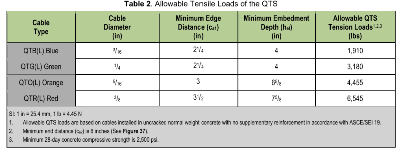

Using ACI 318 equations to check the anchorage capacity, I find that the assembly's allowable tension capacity is about 60% less than the manufacturer’s published values, primarily due to concrete breakout. This calculation includes product-specific variables and factors from ACI 355.4 tests, accounting for any proprietary epoxy behavior, which are published in the ESR.
I believe the proposed system’s anchorage must be checked using ACI 318 provisions, as the design closely matches the scenarios covered in the standard. The difference between the published assembly capacity and calculated anchorage capacity is a significant concern that I want to resolve before allowing the product to be used in my building. The testing agency and the manufacturer are telling me not to worry about it since the submittal and the TER are both sealed by PEs in the project state. They claim that since it is a delegated design, I don’t need to worry about how it interacts with my building. I would like to reject the entire system and stick with the original design, but the contractor really wants to use the cable system.

To address your questions about the concrete breakout:
1. Somewhere buried in their documentation I found a conversion factor of 1.62. I have seen this on other resources as well and I think it's logical. (0.9D+1.0W)/(0.6D+0.6W)= 1.62 (assuming 30% dead load and 70% wind load split). So taking the LRFD load combination divided by the ASD combination. Then multiply the ASD value by 1.62 to get to an LRFD level load. I often just take the ASD wind load divided by 0.6 (ASD seismic by 0.7) which is probably slightly more conservative.
2. No. I wish. See this screenshot from the TER. Footnote #1 says "no supplementary reinforcement". It also says "uncracked", that's a whole additional can of worms. And it says "in accordance with ASCE 19", which is titled "STRUCTURAL APPLICATIONS OF STEEL CABLES FOR BUILDINGS" and makes no mention at all about concrete or anchorage design...
Ya i got too curious after I asked and found this table and its footnotes. Its a hunk a junk if you ask me.
Did you treat the concrete as cracked or uncracked in your anchorage evaluation? Now i'm just really curious.
Aren't all anchors in tension required to be "cracked" with no exceptions? in fact, I don't ever use "uncracked" as I just don't see how concrete can be considered that if under any kind of tension loading.
@Aesur - I also always use cracked. The line of reasoning I have heard to demonstrate the concrete is uncracked is either: Anchor in the compression side of an element that is in obvious compression in perpetuity, or based on same hairbrained analysis of the cracking moment (just a guess if you ask me).
I don't think we are really talking about the anchor itself being in tension, but rather the concrete/rebar composite element.
driftLimiter - I did my calculations as uncracked just for comparison purposes with their "allowable load" just because I know they would try to argue with me about the difference. I always consider cracked for my anchorage designs. Even assuming uncracked to match them, it was still about 60% off.
Aesur - I agree. I don't think you are allowed to consider uncracked for something like shear wall overturning anchorage. I considered cracked my original design.
And that’s without considering the sustained tension reduction factor, which is a drastic reduction. I don’t see that considered in any of their documentation, so in my mind it doesn’t meet code. At least for the adhesive anchor version. Again, I would not even entertain a post-installed anchor for this system.

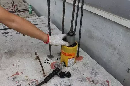

I always feel the way they test these anchors are sketchy. You are essentially pushing as much as pulling. The pushing force is essentially confining the concrete around the rebar. How is this a reliable test? The supports need to be far away from rebar or at least outside the ACI breakout cone. [URL unfurl="true"]https://res.cloudinary.com/engineering-com/image/upload/v1720963676/tips/IMG_0060_ncf4lo.webp[/url]
@Doublestud That's a test for bond. Basically whether it was installed properly. It doesn't test concrete break out because not the chem anchor manufacturer's or installer's problem. Also would need to test the whole group not individual anchors. Never seen any commentary on whether confinement in the test increases bond though.
