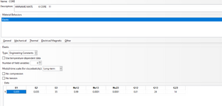

I am performing a linear buckling analysis of a sandwich structure, specifically a tapered cylindrical shell with reinforced patches. The face sheets are modeled using conventional S4R shell elements and are tied to the core vie TIE constraints. For the core, I used two different approaches:
  1. Solid C3D8I elements (4 elements across the thickness).
  2. Continuum shell elements.
However, I observed that the linear buckling analysis produces significantly different results between the two cases. For instance, in case (2), the critical buckling load is three times lower than in case (1), and the buckling position is also different for the same applied load. What could be the reasons for these discrepancies?

Yes the continuum shells are only for the core and again are tied to the face sheets (S4R). For both cases, the core is anisotropicand I assign material orientation via "Material Orientation Modulus"

Looks like it is a core shear crimping buckle mode. Which is why it is core element sensitive. Make a cut thru the thickness thru the buckle pattern area lengthwise, and show the mode shapes (zoom in on the buckle area).

shear crimping is going to be very difficult to predict with a FEM, as it is a very short wavelength buckle mode. do a search - there are lots of papers and docs on the subject going back 50+ years.
you probably need to use a higher density core material with higher shear stiffness; try increasing G13, G23 by 10x and see what results

Thanks for the advice. But still I don't understand why these two modelling approaches provide different results. And which one is more reasonable
The problem is that you don't have a reference solution so you don't know which approach is closer to the right answer. Multiple layers will be more accurate and thus they could help you find out how far you are from the correct result. You could also look for some benchmark problems that already have reference solutions.
The face sheets could also be modeled in different ways. Abaqus has a skin feature making it easier to define such reinforcing layers.
Which modelling approach is more reasonable/accurate? Well, you need to calibrate the modelling approach and input properties to some data in the literature or in-house. Research "core shear crimping"; there are recommended closed form equations, but beware it is still after many years somewhat controversial and there isn't agreement on the correct equation. Then make a simple flat plate model, axially loaded in-plane on one side, reacted on the other side, free to translate in transverse direction. Size the panel to be critical for shear crimping (adjust the panel size, facesheet thickness, core thickness, core stiffness, etc.) and run an eigenvalue analysis and compare to your selected crimping equation and/or test data. Once you get the flat plate modelling approach to work, then apply that approach to your larger model.
