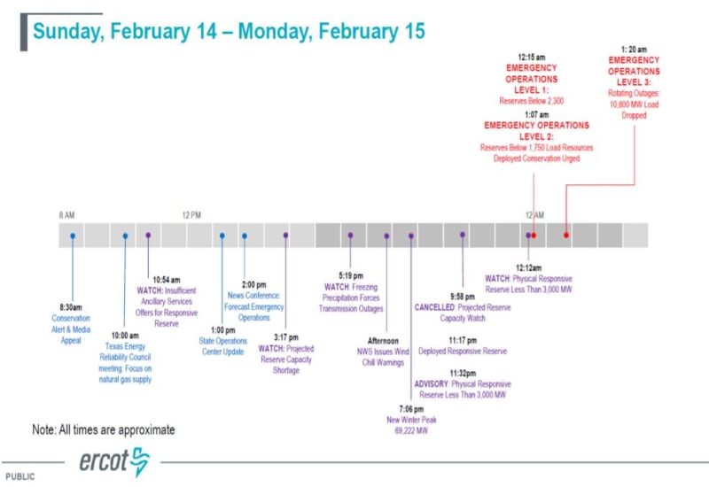

Trying to get back to the technical part of this discussion.
Unfortunately, I can not come into ERCOT's website so the only information I have is from second sources.
We have found that ERCOT did end up in a very difficult situation due to previous decisions outside there control.
But something I have seen and thought about that could have made the situation better is that at 7:51 PM on February 14, ERCOT got ok to exceed the emission levels if they went to Energy Emergency Alert 2 or EEA 3.
According to NERC's regulations, EOP-002-3.1 what is written only "guidelines"
Energy Deficient Entity foresees or has implemented procedures up to, but excluding, interruption of firm load commitments. When time permits, these procedures may include, but are not limited to:
Whether ERCOT has agreed to follow this or not, I do not know.
It also seems that their own guidelines are a bit different according depending on where you look.

There is no mention of reserve levels must be below a curtain level before alerts can be issued and in their own checklist they are only written as comments.
EEA1 are when operating reserves drop below 2,300 MW.
EEA2, the operating reserves are less than, 1,750 MW
Regardless, it is not possible to write rules in stone for situations like this, because the variables are infinite.
What could then have been done differently.
If they had chosen to issue EEA 1 and EEA 2 already during the day instead of waiting until 00.12 and 01.07 15 Feb, they would have had access to more energy.
The EEA3 come at 01.20 15 Feb
And possibly the nuclear power plant would not have tripped.
I do not know if I read anywhere what caused this?
During the day, there had been reports that gas wells had stopped working.
They should reasonably have had access to sufficiently good weather reports 24 hours ahead to have known that it would be colder.
So in my opinion they hade the input data to se this coming.
It was only 1 hour and 8 minutes between EEA 1 and EEA 3
So why did they wait to perform EEA 1 and 2 and not issue them earlier?

It is possible that the rapid rise of alert level occurred because something that ERCOT did not expect to happen did happen sometime between level 2 (providers are permitted to reduce power load by interrupting supplies to commercial and industrial users) and level 3 alerts. I can easily imagine that was the same time when some gas producing and processing facilities went dark. It was reported that at least some of these facilities were not considered to be critical parts of the infrastructure making it possible to curtail their power supply. Oops!
It might be so, Oooppsss [ponder]
But that does not explain why they didn't go to EEA 1 at 08.00 and EEA 2 at 09.00 Feb 14, then they would have hade the possibility to call in more power over emission rates and hade more of there own left to use.
And hade bought them self more time to handle the situation.
They would even have hade time to realize that this Oppss !! hade happened and done something about it, if there was an Opppss.
All this EEA:s are there to never get to EEA 3 so with the knowledge of more cold weather, already freezing gas wells, more power needed for heat, it should have been an easy decision.
How musch it would have helped in the end I do not know, since it is not easy to find any numbers of how much power would have been taken offline at the EEA 2 alert and it only hade a duration of 13 minutes before EEA 3 came.
So how the guidelines for when alerts are to be issued is to narrow.
