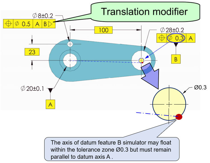

Please correct me if my understanding is not right on this case.
The translation on this case does not “translate in both directions” as OP said, and it does not mean to move along the X-axis only, instead the axis of datum feature B simulator may float within the tolerance zone Ø0.3 which is specified and established by datum feature A (as shown below), the most important is the axis of datum feature B simulator must remain parallel to datum axis A.

SeasonLee,
You are right that the axis of datum feature simulator B must remain parallel to datum A, as it is always the case. The translation modifier means that the distance between the datum feature simulators (100) is adjustable to accommodate for the position deviation of datum feature B relative to datum axis A. It should be adjustable at least in the range of 99.85-100.15 due to the ø0.3 position tolerance (practically it doesn't really matter if the range is greater and goes beyond these limits).
Since the datum simulation for B takes place before the rotation around A is locked, the direction of translation (or adjustment) as shown in the image is not really meaningful (it is shown translated below the horizontal line connecting the holes but could have been rotated otherwise). The axis of datum feature simulator B can rotate 360° around datum axis A. Only after the simulator for datum B is engaged with datum hole B, the directions which are horizontal (Could be X) and vertical (could be Y) in the image, are defined by the established datum reference frame, and are meaningful for the orientation of the part that is constrained relative to it.

SeasonLee,
Here is another way to look at it (maybe simpler):
Since the datum reference frame is established by the datum feature simulators and datums, the direction of the plane connecting datum axes A and B defines X. Then, any translation is in the X direction, by definition.
Yes, this is what I said "to move along the X-axis", my understanding is this is only one of the possible translations, as long as the translation happened within the tolerance zone Ø0.3 is accepted.

The image in the 27 Jan 23 05:41 is misleading. The mutual axis between A and B is always exactly aligned in the [A|B} datum reference frame. The ability for datum feature B to take up space is solely due to being closer or farther from [A] and tilting out out parallelism to [A]. It cannot be entirely shifted in any other direction.
Only if the features in the diagram were held in some mutual alignment to another feature that controlled orientation (rotation in the plane nominally perpendicular to the features used as datum features [A] and ) could the situation be as shown.
Even then, once the evaluation as [A|B} is done that rotation fixation is gone and A and B are exactly aligned no matter where they were in some other datum reference frame.

Thanks for your comments.
Would you mind to show us a scketch or diagram how this translation works, I am glad to learn where I went wrong.
