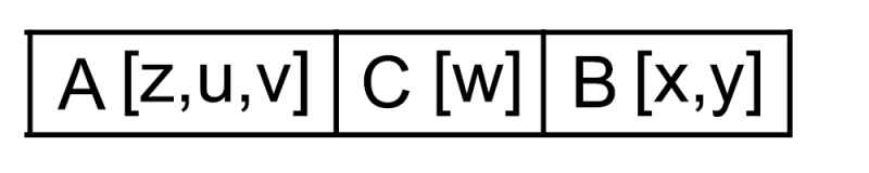

I hadn't even thought of changing the order. So the equivalent customized DRF for the translation modifier example in 4-4 would be |A[z,u,v]|C[w]|B[x,y]|. I suppose you're right - that would achieve the same constraint.
In that case, Datum feature simulator B would be required to be centered to datum C. Which will eliminate the offset adjustment between simulators that is allowed by the translation modifier and its intended effect on the controlled features.
This will not result in the same type of constraints.

Below is explicit and identical to the translation modifier in Figure 4-4 , for the planar face as datum feature A, the hole as datum feature B, and the slot as datum feature C.

For what it's worth, for the part similar to the one shown in figs. 4-3 and 4-4, this is how I would envision two design cases in which the usage of the translation modifier would and would not be the correct choice. Of course this is just to show the idea - real assemblies could look totally different.
Apart from that, I still fully agree with Burunduk that the proposed alternative DRF |A[z,u,v]|C[w]|B[x,y]| is not equivalent to |A|B|C>|. The note at the end of 7.5.2 in Y14.5-2018 is, unfortunately, an example of how things should not be worded in this and any standard. It is super ambiguous for the reasons Burunduk provided. Additionally, one of the customized-DRF-related figures in the standard, 7-57, shows that the two TGCs playing role in the customization of the DRF are at basic distance with respect to each other. So does it mean that now users of the standard are free to arbitrarily choose which of the rules for TGCs given in 7.5.2 are applicable or not for customized DRFs?

Only if one ignores that the first example has a datum translation and the second allows changing the datum orientation relative to other datum feature references can one conclude that customized datum references don't function.
I am not sure what "entirely different" exactly means to you, but in my opinion the two procedures, assuming I am reading them correctly, will result in different part-to-TGC relationships, therefore they might lead to different position error readings for the two holes.
The pictures below assume that the TGCs of B and C are always perfectly located to each other.
