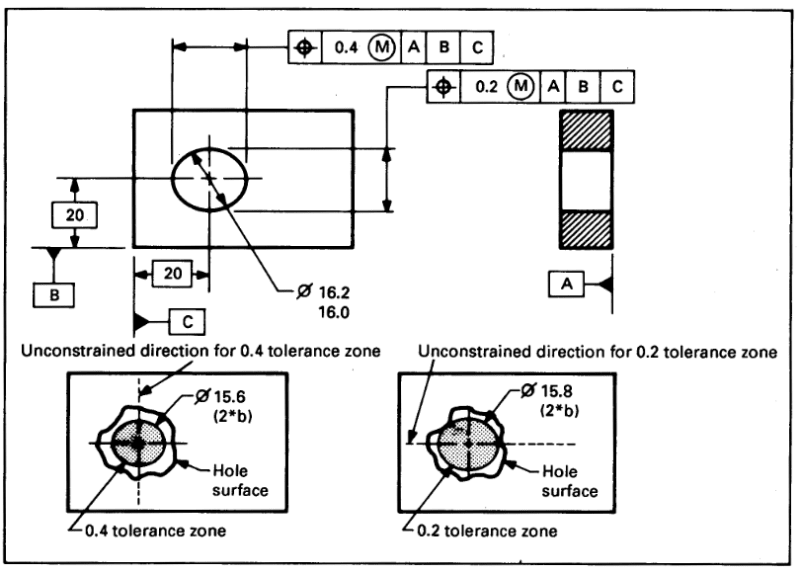

3DDave at 1 Feb 23 19:09 said:
More variation can be allowed in the radial direction and less, typically, in the tangential direction, which, if it was on the drawing, would allow the tangential control to be the datum feature solving the problem and accurately describing the use.
Since you cannot attack the claim you nitpick the language. Now that I have explained it and you clearly understand what I meant you repeat the language attack.
I've previously written that bi-directional tolerancing resolves the problem for practical mechanisms. Look at Tec Ease to see if they did an example of how that works. They do have some great cartoon depictions for beginners to follow.
Now, since you are using a pin, why did you fail to use a projected tolerance? Same reason you don't want to admit that you don't understand that a fit with a slot isn't a diametral fit.
Perhaps this will help out:
Does the word "unconstrained" make any impression? This same figure should also be in the 2019 release of Y14.5.1, which you should have a copy of. I had the crappy draft copy with many of the words blacked out by the "watermark," so I didn't get the released version.
The figure you now provided further reinforces my suspicion that it is not only a language issue that you are having, it is confusion between the processes of controlling a feature and using it as a datum feature. The "unconstrained" elements in this figure are virtual condition gages for the position controls of the hole, not datum feature simulators. Had this hole been labeled as datum feature D and referenced for some other control as a secondary datum feature (either at MMB or RMB) after C primary, the datum feature simulator for datum D (either fixed size or adjustable) would still be required to be stationary at the basic distance of 20 from simulated datum C. That would be the case regardless of which feature control frame the datum feature symbol D is attached to, or if it is placed directly on the hole outline. The only way to unlock that basic location of the D simulator would be using the translation modifier. Look at Dean Odell's YouTube playlist, maybe he has a demonstration of datum simulation principles that you can relate to more easily and learn from.

The bidirectional tolerance of position separates the location control to two different directions of dislocation controlled by different tolerance values. In the figure, it unconstrains the location of each of the 2 virtual condition gages in the uncontrolled direction for each control. This correlates to two parallel-plane type tolerance zones for the resolved geometry interpretation, that combine into a cuboid tolerance zone limiting the axis of the actual hole around the true position.
As I tried to explain, this has nothing to do with the requirements of datum simulation when the hole is used as a datum feature, therefore it doesn't "solve the problem" (as you claimed) which the translation modifier deals with.
If this doesn't help, ask an experienced co-worker that understands Y14.5, and fixtures and gages, to explain to you the difference in the function of a fixture element to simulate a datum and the virtual condition gages for a bidirectional tolerance of position evaluation.

Unless otherwise specified, the true geometric counterpart and datum feature simulator is of the inverse shape of the datum feature. For a hole, the datum feature simulator is a cylinder and the datum is an axis. A bidirectional position tolerance doesn't change that. In figure 10-30 of Y14.5-2018, the bidirectional position control defines a 0.04 width of a ring shaped tolerance zone. Had a datum feature symbol C been attached to the 0.04 position tolerance FCF, and a different tolerance of position for some other feature would reference A,D,C - what would be the shape of datum feature simulator C, and what would be datum C? According to your logic, it would not be a datum axis. So what would datum C be, would the rotation about datum D be constrained by datum feature simulator C, and how would it differ from a case where the datum feature symbol C is attached to the 0.2 position FCF or the 0.04 perpendicularity FCF?
