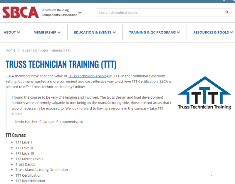

Ron, it would be helpful to understand the Alpine training for techs. Residential truss suppliers are my least favorite gang to deal with. The industry is the most cost conscious group I run into, and trades these days pay little attention. I had always wondered what info the truss eng is provided, and this has been helpful to clear that up. I suspected it was not much given what they are paid per truss design.
Ronthe Redneck said:
I don't have time to deal with all the statements made here.
Take your time. Threads don't get closed here until months of inactivity have passed. There's really no pressure to be responding in real time.
Brad805 said:
...it would be helpful to understand the Alpine training for techs.
Back in 2000-ish, the training function was sort of delegated to the Wood Truss Council of America (now SBCA) in the form of 4-day, in person courses held mostly at hotels and, sometimes, on site for the larger fabricators. Most of my job at WTCA was in developing, refining, and delivering TTT1, TTT2, and TTT3 from the list below. I've stayed at a ridiculous number of airport hotels in the continental US.
I would absolutely love to share the content of TTT3 with the gang here as that was my baby and there was some great stuff in there. As you can imagine, however, I don't need any additional intellectual property suits this year. Maybe in 2023.
