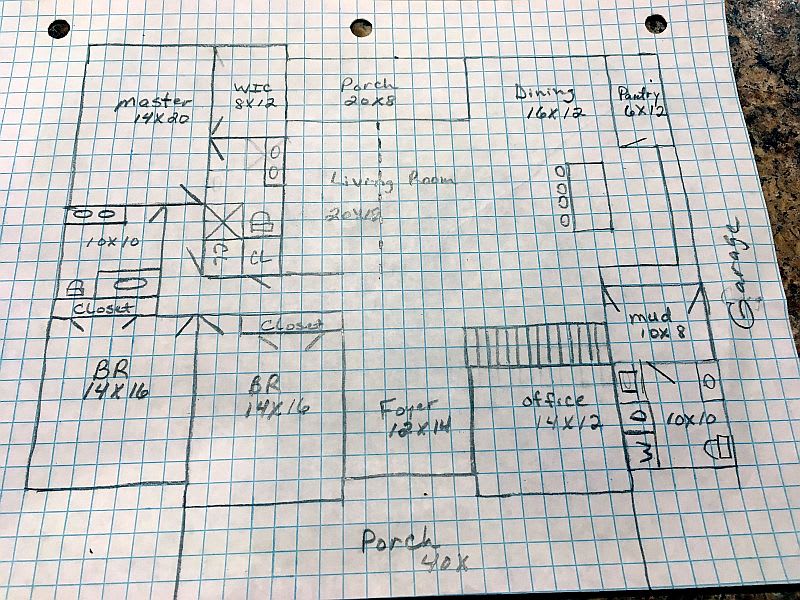

Jumping back to the wonderful plans we often get - Here's another example:
This customer is building $300,000+ houses from sketches like this.
This afternoon I was thinking about a job we once did. One of the salesmen turned in an order for an addition to a commercial building. He didn't give me the plan, but wrote up what was needed. There was only one truss type.
He asked for a sealed drawing of the truss, and I provided it. The contractor, architect, and EOR all approved the drawing with no exceptions noted.
After the trusses were built the GC called in one day and told me the trusses were wrong. I told him he had approved the drawing, so they were his. He went ballistic.
I asked for and got a set of plans. The salesman who wrote the order screwed up badly. The span, overhang, pitch, and heel height were not correct. I have no clue how he came up with what he did.
The architect and EOR said they had no liability, as they only review for general conformance with the design documents.
The GC went over my head and went to the owner. After much discussion we ended up eating the job and replaced the trusses at our expense.
As a result of that - And of other similar stories - I have little faith in the review process. Doesn't seem to me like anyone really puts much effort into it. (Although there are exceptions)

RontheRedneck, my comments were not intended to be demeaning toward you, but I stand by my characterization of the delegated design process for wood trusses as sketchy. It sounds like you perform your role within the process quite competently, but you yourself have provided us with several examples of a sketchy process including such practices as plans sketched on cardboard boxes and trusses ordered based on verbal descriptions when plans prepared by an engineer were available.
And again, I was not trying to insult or belittle you by saying that I interpreted your comments to mean that your work is primarily for residential or agricultural buildings that do not require any engineering. You told us in your OP that 95% of your truss designs do not require an engineer's stamp.
Trusses ordered by owners or contractors for projects that have not been designed by an engineer of record are not part of the delegated engineering design process with which many of the posters in this thread are familiar.
None of this surprises me, but the general public might be surprised when they see how the sausage is made.
As far as the "EOR is always found to be responsible" comments go, I doubt that this is the case. The EOR will be held to the standard of care.

Always gotta ask for a plan. Seems this case the sales guy made the mistake. How would the engineer know its wrong if he or she never sees the plans and just stamps the output? Architect approve a truss drawing-LOL! Contractor should have done a better job too, but he or she could be relying on the professionals to get it right.

JStructsteel - You said "How would the engineer know its wrong if he or she never sees the plans and just stamps the output?"
I'm not talking about the engineer at Alpine - I'm talking about the EOR. If the contractor, architect, and EOR aren't even going to look at shop drawings, what's the point in sending them?
That's why I said I have little faith in the review system.
