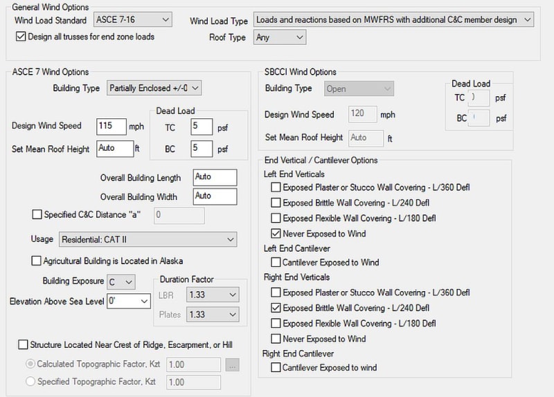

I'm wondering the (successful) methods of reporting your lateral loads applied to roof and floor trusses. Is it worth the hassle to indicate (Wind ASD) or (0.6W) etc. ? Has anyone had the pleasure of the truss designer heeding these, or is it easier to just write the value in 1.0W and tell them it's Wind.
Also curious about the application of omega... anyone know if they'll apply this if they know they've got a seismic load?.. :|

Nate, I've never seen a truss designer pay attention to the wind loads. Speed, exposure, etc.; yes. Their software figures out the wind loads and automatically applies them. Nobody is manually entering those.
Don't know about seismic - never had to worry about that on a truss before.

I got a screen cap from our truss design program. This gives you an idea what options are available to us. Just thought some of you might be interested.
I always try to use the settings called for on the plans. But I do sometimes miss something. Everyone seems to be in a huge rush for everything, and we're always pushed for time.
And honestly, I see it as largely a waste of time. Wind design mostly affects hold-downs. And they're rarely installed correctly if they get installed at all.
It also sometimes means more CLBs on the webs. Those are also not always installed, and rarely installed correctly.
I'm more concerned about making sure the correct trusses get to the jobsite. People don't always know what they want. Plans are not always drawn clearly. And customers often change their minds. So IMHO there are more important things to worry about.
