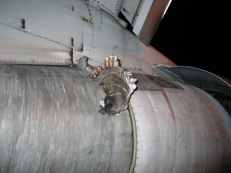

This is a disk failure. I can only presume they were at a low power setting when it went and no where near max N1.
Like it or not that cutting loose at 13000 rpm is not going to get stopped by 8 layers of Kevlar weave mat. Or if it is then it will cave in all the structure around the mat and you would have less damage if you just let it puncture its way through.

Sigh. There is no kevlar wrap on fuselages. There is a fan case around the low speed fan, which is the brown component in the pictures of the failed engine. Fan cases often contain kevlar fibers. Normally the fan cowl covers that area, but it came off, even though it is not supposed to.
And the missing window area on fuselages is where the fuselage barrel sections are joined. Nothing to do with engine location. The exception is some turboprops that have a reinforced fuselage area in line with the propellers, since there is no fan case.
