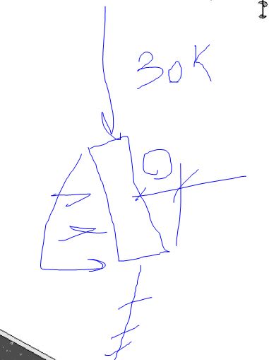

My situation shown below. This is making me pretty unpopular with the helical pile supplier and the only "outs" that I can think of are to:
1) Use the 2" mud slab like a regular SOG to resist lateral loads.
2) Use the backfill around the base of the wall to resist lateral loads.
Thus far, I've not been willing to do either of these things owing to concerns over of quality and permanence. How do others feel about this? Am I being too much of a hard ass?

Unless you need to tie the piles in two directions for a code reason, can you not simple get them to size the pile for the lateral load?
I can try but I'm not confident that I'll be successful in that since, as mentioned above, it seems like lateral on a bare pile is good for about 1k. On an encased pile, about 5k. I've got 16K coming in per pile from basement wall pressures alone. That doesn't even consider the three, lone shear walls that are holding this glass monstrosity up. I'll be reaching out to the pile supplier this afternoon to see what they think of all this.
Brad805 said:
You even if you need a buttress at each pile it would not surprise me to find that was still cost effective.
Really?? I figured just the formwork alone for twenty of these thing would cause the builder to go nuts. Screw it, I'll run it by them to see what they think. Part of the problem is that much of the surrounding area has pretty good soils somehow. It's just the top of this damn hill that apparently has these nightmarish, collapsible soils that are causing lawsuits. This discrepancy of perception is part of the problem for sure. The builder just told me that the original owner of the side decided to abandon his construction plans and sell the lot. They speculate that the cost of the foundations may have sunk that venture.

Just to dial things back a bit, the crux of my question is really just "Is crawlspace on helical piles weird? Am I nuts to not want to use a mudslab for lateral restraint?". I've done helical piles with no basement or crawlspace. And I've done helical piles with a full basement and slab on grade. Just never this particular combination. And I don't want someone stumbling across this thing and saying "OMG! Crawlspace with screw piles! Those walls are just going to roll over, what were you thinking???". If this is actually normal, I'll roll with the punches.

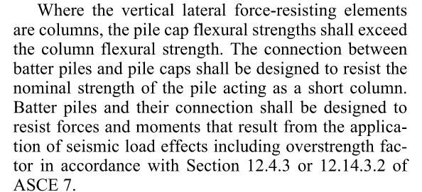

You get penalized for using battered piles in high seismic. This is from IBC 2015 for SDC D to F.
I think a crawl space on helical piers is a little odd and I would try to use a key to get the passive needed. I wouldn’t rely on a 2” mud slab as a compression member.
Thank you much. Does nominal strengh of the pile acting as a short column equate to the [As x Fy] capacity of the pipe do you think?? Might need those buttresses after all.

The first is that the lateral load seems high for a 4' crawl space. Is 1200plf correct? I mean at 120pcf or so (might even be lighter) your overburden at 4' is 480psf.

Slab on grade say 4" thick, No. Mud slab, Cringe, tough call. I'd really want to specify something I could rely on. However, see this calc for some wild way (feel free to comment) to compute capacity and make it seem like there is actually a fair amount of capacity.
My first choice would be to span the footing laterally (not too worried about deflection and also knowing there is a mud slab).
I would think that the helical contractor would rather put in a few diagonal piles instead of a grouting the top. At 1200 plf, even grouting the top won't get you much b/c if the soil is bad enough to need helical piles in the first place, then you won't get much lateral resistance.
