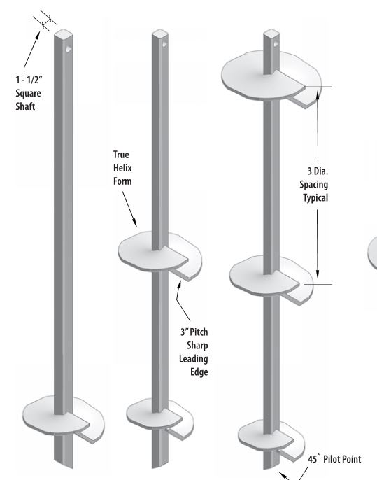

Updates based on conversations with the pile supplier:
1) It seems that we'll be using 1.5" square pile shafts rather than 3" pipe sections. This initially made me want to projectile vomit but I've mostly made my peace with it now.
2) As one might anticipate, those 1.5" shafts can only resist lateral loads via a single resistance mechanism: battering. So, wherever I can't mobilize passive/active soil resistance, which is most places in my opinion, my lateral loads will be resisted by battered piles. Batter batter batter.
3) The pile supplier's engineer took my question about the capacity design of the pile connection to his network and their interpretation is a bit different from what we've been contemplating. Rather than As x Fy, they take "short column" to mean a pile that is not governed by buckling but, rather, will have its connection force limited by the geotechnical capacity of the pile. This concerns me a bit in that, for capacity design purposes, I do not feel that I should be using the pile design capacity that I'm using for gravity loads and which is surely governed by settlement. I'd expect the true, load carrying capacity to be much higher. The piling engineer has mentioned torque values and how that establishes piling capacity. I'm having trouble understanding how that gets me to a true maximum capacity in a seismic, capacity design sense. That probably just reflect my own lack of familiarity with helical pile design. If anyone feels up to the task of enlightening me on this aspect of things, I'd be grateful to hear about it.
4) The piling engineer also suggested that just doing a basic, AScE overstrength design, rather than a true capacity design, might be a good fit here. I agree and may well take that approach if I can verify that doing so won't run me afoul of any code requirements.

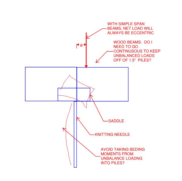

So, with these 1.5" piles, I now also have the more mundane concern shown below. Any thoughts on that?
I don't know much about helical piles or how they behave in/after seismic events so I am useless on the educational front. However, I can point you in the right direction as a professor at my Alma mater was pretty big into it. You'll want to take a gander at the work of Professor El Naggar. When I was there he was quite approachable and I'd recommend reaching out with your query.
You might find this bit interesting (seems like flimsy is best in these situations):
Seismic performance of helical piles said:
El Naggar and Abdelghany (2007a, 2007b) sought to quantify the amount that the ultimate axial compressive capacity of a helical pile reduces after a seismic event simplified by axial cyclic loads. They subjected three plain helical screw piles (HSP) and four grouted helical screw piles (GHSP) in cohesive soils to 15 load cycles of the same frequency, which was determined to be the average number of ‘effective’ load cycles of an earthquake. The ultimate capacity was determined using torque correlations and compared with the axial compressive failure loads of the final tests. Based on the results, it was concluded that after being subjected to 15 cyclic loadings the ultimate bearing capacity of the HSP decreased by 5%–10% and the GHSP by 18%.
Ditto said:
Using observations from damaged pile exhumations from three earthquakes, Miura (1997) concluded that a ‘pile with higher rigidity will be damaged faster than a pile with lower rigidity when they are subjected to the same ground motion,’ and that ‘[a flexible pile] is better than a pile with higher rigidity.’ By all anecdotal success stories and case-history accounts of foundation performance under seismic load, flexibility due to the material property of the pile and possibly the looser soils within the zone of influence caused by installation disturbance, is one of helical piles’ greatest assets
Ditto said:
The lateral deflection of piles is caused primarily due to the plastic deformation of soil. Even so, it has been found that helical piles recovered most of the deflection during unloading, indicating minimal structural damage (El Sharnouby and El Naggar 2011b).
I have a soft spot for Helical Pier issues. I've taken a few deep dives into the subject.
KootK said:
Philosophically, I disagree. You could make that same argument about checking only bearing on the concrete at a conventional, column supporting pile cap. We don't do that though. Instead, we check punching shear. And, in the context of my situation, I see grade beam shear as the analog to that. I spoke to this a bit, previously, with this question:
OK, I've got it now. So yeah, I disagree with myself and agree with you. I was imagining a Chevron situation as you mentioned to avoid the shear situation. I'm also thinking that the shear wouldn't be that high but even with 1.5" square you're probably around 100kips, so yeah, that's high. But if you have a 36" deep grade beam, it might just be a few stirrups in that area.
Hate to say it, but my first thought is that I agree with you here. I'm thinking of a very short load where the column is not buckling. The soil might "give" (i.e. settle), but it's not really failing. It's like asking, will the soil give enough or would that pile punch through the GB first?
There was another guy who was very helpful with a couple of my previous helical pier explorations. I'll see if I can find his contact info.
Ah, torque values. A lot of helical pile suppliers will swear that's all you need. Through quite a bit of testing, they've determined a relationship between torque applied to the pile during installation and the load capacity. It's all empirical. And it's great...unless it isn't. Hit some debris? Torque value could hit the magic number. Hit a lens of stiff soil in a column of junk? Torque value could hit the magic number. So, for critical applications, it's important to have good boring logs and a geotechnical engineer to provide guidance. With that information, the geotech can estimate where the pile should be - so if you hit your torque rating 15' too short...you may stop and question it. The torque rating also does zero for settlement issues. You could hit a nice, 'competent' bearing strata...that just happens to sit over 12' of peat.
I think your concern about eccentricity induced bending is very valid, especially where your pile is cantilevering in the air. Maintain continuity where you can, design for eccentricity where you can't.
Is this separate than the foundation questions?
This feels like the "do you need to consider bending moments when a steel beam frames into a steel column with a simple connection" type of deal. I suppose you could take "e" as 1/2 the required bearing width and that would hopefully be small. There are also some tolerances that the piles are tested with to account for some eccentricity, but this doesn't seem to be that type of eccentricity.
