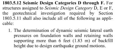

I am not clear on the seismic forces acting on the foundation. Should 1200 plf read 1200 psf?
In any case, a 2" mudslab cannot be considered suitable to resist seismic forces. The footing could be reinforced as a horizontal beam, but for a straight wall of 55' length, tie beams at midpoint or even third points might be considered.
BA
Unless you have an overly conservative geotech directing you to apply seismic earth pressure, I would not consider it a real force. The studies are pretty clear that for walls up to 12', seismic earth pressure does not affect the design. That said, slab friction can rarely restrain any retaining wall.
IBC requires seismic loads to be provided by the geotech in SDC D to F for walls with 6 ft or more backfill.

About half the geotechs here comply with the letter of the IBC and specify that seismic earth pressure may be neglected. As long as they considered it and recognized that for walls under 12' it is not a reasonable concern then they have complied. The rest just cause the clients to dumps tens of thousands of dollars of concrete into the ground unecessarily.
So do the geotechs in your area also take responsibility for whatever structure may be sitting on top of that wall that is also experiencing seismic movement that may be imparted onto the wall at the same time? I don't see how them not providing it to the structural engineer that is designing the wall is within the letter of the IBC. We are responsible for the seismic detailing of loads with overstrength as I noted above.

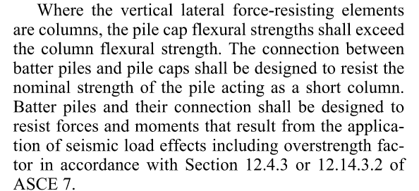

So coming back to the provision below.
1) Would anyone be willing to say that provision doesn't apply to my situation? Considering some examples:
a) Clearly, for a moment frame column foundation, it applies.
b) For a shear wall system on a pile cap where the piles are not under the walls, I would certainly hope that it appies.
c) For my shear wall on grade beams system, does it apply?
2) If I have to apply this provision, how far do I take it? What qualifies as the "connection"? If it's just concrete bearing at the piles, no problem. I'd planned to extend this to include punching shear through the grade beams which is a bit trickier to deal with. Should I stop there? Consider some flexural stuff for the grad beams?

KootK,
If your concern now is in regards to stability; IBC 2021 1810.2.2 Exception #2 applies and alleviates your situation.
Take a look at the second paragraph of that section as well - in regards to utilizing staggered piles. If the exception provides a code exception, you could consider staggering the helical piles as much as possible along the length of the wall to provide some form of mechanism against the roll-over concern. With a 22 inch wide footing it seems you can reasonably stagger those helical piles. You would then have a torsion effect as your stabilizing mechanism, which you could reinforce with ties if need be.

Is your question "If I use battered piles, can I get out of the IBC connection provision?"
My question to your question would be - what are you using the battered piles for? To resist overall sliding of the structure due to base shear or to resist out of plane loads due to lateral earth pressure? or Both?
Are these piles battered in the plane of the wall? If so, I'd think that getting the connection to develop the strength of the short column would be fairly simple as it is just bearing on the concrete at that point. If there is tension/uplift then that might be more difficult. If the piles are battered perpendicular to the wall, then that's a different story.
I think what EZBuilding is referring to is the stability of the pile itself (i.e. braced vs flagpole condition).
RFreund - the code section I reference is in regards to stability of the entire foundation assembly - not just of the actual deep foundation element.

As I remember, the reason for the strength overdesign in high seismic is to make sure that the inelastic flexure happens in some other member before the connection strength is exceeded. Actual seismic forces experienced are higher than the elastic design. In your case, I don't see where you can argue that you have that ductility near the battered pile to pile cap connection.
