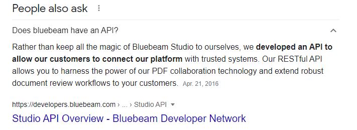

What we need is someone like Celt to use his API skills to create a rebar detailing app to function inside bluebeam. That would complete the loop along with the photo linking that pharmEng mentioned.
It would be cool to link in dynamic cells like Excel or even Excel itself into bluebeam.
For example, linking a bluebeam text box to a specific cell within a worksheet.

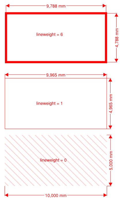

On the topic of bluebeam... I raised an error to their tech support last year.
It seems measuring between the snap points using Snap To Content is affected by lineweight. It doesn't snap to the centreline, see screenshots below.
Yeah i've noticed other similar things, I would not use the dimensioning for mission critical things, as always seems to have small differences from the source.
Did they ever fix it? (I'm on 2019, which is no longer updated).

Logan, photo linking can be done with a number of different apps on the market, but the cost per seat is not great for those of us not doing it day in day out. The ones I looked at seemed to be targeted to enterprise clients or large construction contractors. I have worked with a few contractors that are using them and seems to be a nice feature. Last I looked it was a while ago, so maybe there are others now. I suppose one could make it themselves, but you would need to be careful to avoid link problems if not embedded into the file.
Using the API link I think one could create scale drawings of rebar within Bluebeam. Trenno's idea of doing it via excel would work. I would like a little dropdown that would create scale sections of beams/columns/walls.... I don't have the programming skills for that myself. Here is a sample python script DWG via Python. Change a few variables and it creates the drawing automatically.

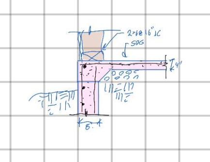

Is that an S7 with the S-Pen? I'm demoing one of those right now. I'm really just looking for the ability to freehand sketch to scale like I can by hand. Preferably, with the ability to make it appear as though I've used a ruler here and there. I did the sketch below just now in under 60s. It doesn't show below but, on screen, the graph paper has gradations between the major lines which I'm able to adjust for different scales. I'll check out Autodesk sketchbook too.
As a heads up Sketchbook is no longer part of Autodesk and unfortunately no longer free for the advanced tools like ruler, french curve, etc. unless you already have the autodesk variant installed.
Try out Medibangpaint its free and has a ruler tool you’ll just need to roll your own graph paper background, Link
