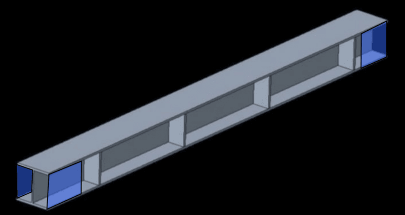

You can box in the wide flange on both or one side of the beam. Run a plate full length on the beam (or in the length where you see torsion) from the top flange to the bottom flange to make a box section. Then you still need to get the torsion out at the ends.

Plates need to go on the outside, ie parallel with web, ie close the section.
Do all others agree the description above by Tomfh about strengthening the steel beam against torsion by literally welding a whole one piece plate parallel with web on the outside and close the section? The thickness of the whole one piece plate will be same thickness as the flange. Will this create same torsion strength as hollow section of the same size (if both sides would be whole plated closing them)?
In torsion of I-beam. Is it due to the thinner web that is why the top flange can rotate downward or is due to the boundary between top flange and web that makes it want to rotate?
Yes. This is essentially the best solution to retrofit the beam. And yes if you use the same thickness as the flange it will essentially give you the same torsional stiffness as a hollow section of that depth. (Though depending on you torsion requirements you might be able to get by with thinner plate or even some plate staggering.)
I'd suggest that other commenters haven't jumped in to reiterate this idea because it is clearly the best solution and doesn't need further elaboration.

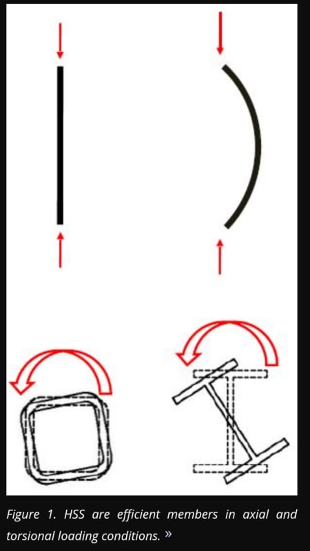

Many ways to explain this. I'll try. In a similar manner to beams where bending is resisted by have a tension and compression side separated by some distance. Where the greater the distance the great the resistance. Torsion is resisted a loop of shear separated by some distance. And I-Beam has forces this loop trough web with very little distance between the loop paths. Circular or square hollow section doesn't have this issue.

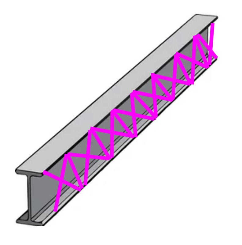

What would happen if you used trusses on the sides made of angle bars instead of whole one piece plate? It's very difficult to transport whole plates.
I think it is about time that you go do your own research and calculations to get a solution you are confident in. Otherwise ask somebody in your organisation or hand off the problem to somebody else.
What you are proposing seems less practical. If whole plates are difficult transport then cut them up. Either way you'll still come back to having to calculate the torsion capacity of the member yourself rather than just throwing out ideas to the ENG-TIPS community and seeing what sticks.
Yes, best to turn a wide flange into an HSS (closing all its sides) as it's easier to compute the torsion capacity of an HSS than trusses. Thanks.
Yeah, the truss would work but spliced lengths of thin, continuous side plate are sure to be more practical to build. Are there no beams framing into the sides of the member being reinforced that would interfere with the side plates?
