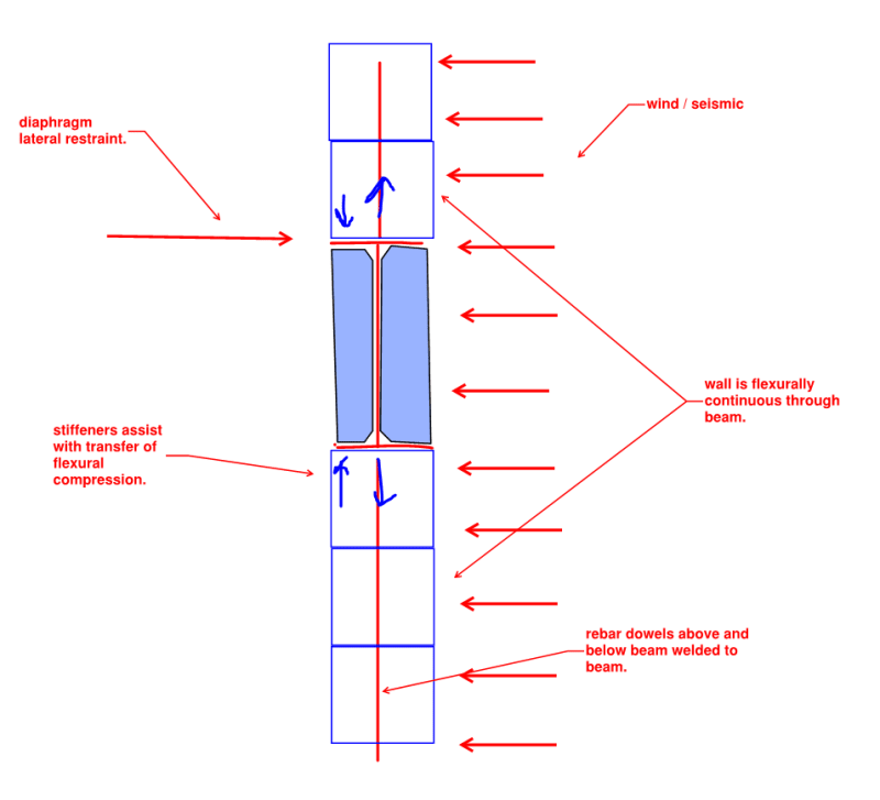

can putting such stiffener plates inside the web and flange (illustrated above) produce restrain against torsion? What is the formula for the spacing of the plates?

So given the w8x21 is very small, and has poor torsion, how do you strengthen its torsion if not for plates or trusses. You are saying the plates are only viable solution?
1) I certainly feel that continuous plate reinforcement is the most viable option on the table.
2) If you scan this thread carefully, you'll see that I've suggested a number of options besides plating and trussing. Presently, I can think of no other options.
@planc:
Now that we fully understand your situation, I think that the solution is quite simple. Per the sketch below, you can make the wall flexurally continuous across the beam such that the beam has no meaningful torsional requirement (granted the rebar welds are atrocious). With this solution, the stiffeners would indeed perform a useful function. This may well have been what your local engineer meant in the first place when they told you that there wasn't really a torsion issue to be concerned about.
As shown in the above roof plan. The roof is thin metal sheet and has no diaphgram or brace to the left and right side 5.5 m span Ibeam (upper left which is the concerned now) that will support the 39" parapet. The small horizontal elements at middle are only sagrods that connects between purlins. And there was an thin aluminum gutter on the side of the Ibeam which can't restrain the ibeam. The rafters are connected from center ridge to the columns only. BAretired taught me the importance of distributing the rafters to the Ibeam to restrain it from torsion. But the advice was given after the structure already built.
So it is due to this lack of diaphgram or brace whatsover that needs torsional reinforcement so the ibeam can independent resist itself without brace/diaphgram restrain. And it needs to be done now before tenants would occupy it for the next 10 years.

@OP: I feel that the trussing idea needs to be abandoned given the size of your beam. It's just not viable for something as small as a W8x21. I was imagining something much larger when I proposed my trussing scheme.
This thread is entirely relevant because the wall below the I-beam and the I-beam bottom is not aligned!
This is because the columns were not aligned during construction. When the Ibeam was put 5 years ago. It was made straight like the green (where the blue now is the wall). The mid part where the center column is farther by 2.5" is where there is greater distance between the bottom wall and the I-beam.
Here is the actual eccentricity. The green line where the I-beam flange appears. Notice the block at the open portion where it is only half the flange width (but all the wall rebars were welded to the flange center):
Or in terms of your illustration. Here is how it actually looks like with the proposed plate on the left or right side (again the mason just bent the rebars near the top of the wall to match the center of the flange):
I will wait to get at least a 1/4" whole plate (or pieces welded together) to cover up all the sides to strengthen the shear as well as weak axis strength before putting any 39" high parapet, or abandon the parapet altogether. But I need to know one thing now. Why does the trussing idea needs to be abandoned for something as small as the w8x21? Why not viable?? Is it because the truss sections need to be so big as to be close to the whole plate? This is the last question, I need to know your valuable answer to either put a whole plate or abandon the parapet. Thanks Kootk!
