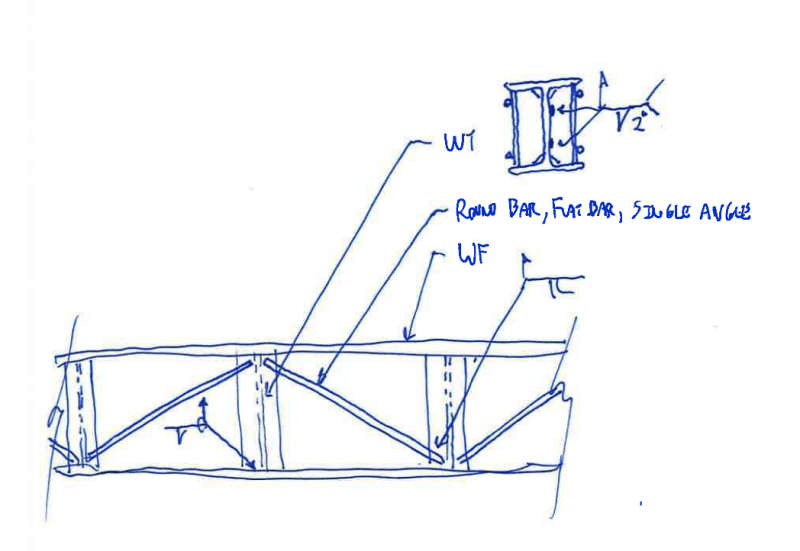

can putting such stiffener plates inside the web and flange (illustrated above) produce restrain against torsion? What is the formula for the spacing of the plates?

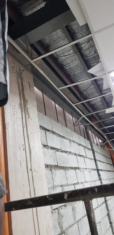

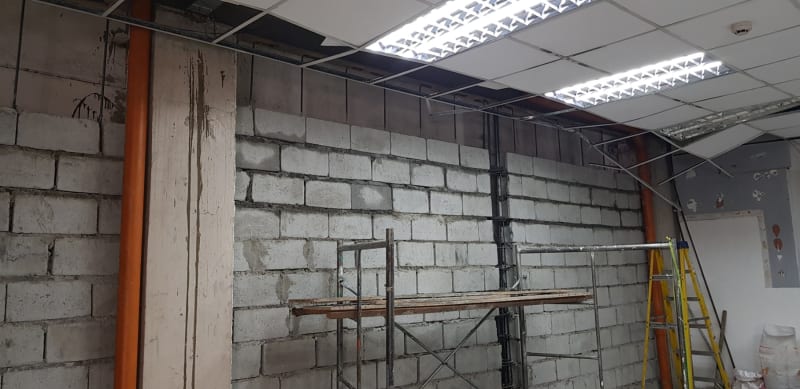

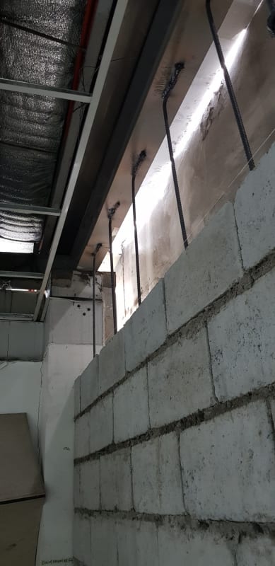

\\\These 6" 700psi nonbearing walls are almost done. But I need to put parapet on top of the I shaped Beam. The ibeam longest span is 5.5 meters. Can parapet be supported above it or do i have to close up the flange with plates to increaes torsion resistance. I don't like my parapet to twist during lateral movement. The original designer said it was designed to resist torsion. But BARetired didn't agree. Would getting plates to close them of is just for extra precaution. Then no problem implementing it. I am an engineer and owner of the building.

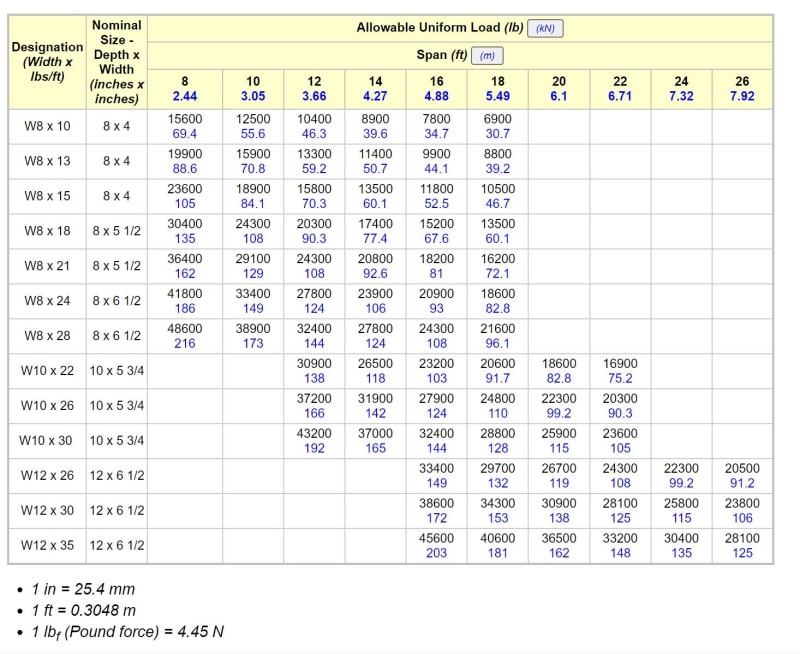

What is the uniform load at 18 feet span (5.5 meters). Is it really 70.1 kN? Since my parapet load would only be 2.73 kN.Much less than 10%, the wall won't rotate and fall by becoming horizontal?
My designer can't give me further details as he doesn't know how to manually computer. He just got them from Etabs and can't say further. I'm just verifying the concepts and torsion performance of the 2.73kN/meter parapet above it. Come on. Help me one last time. Compute the 2.73kN/m wall along 5.5 meters (18) feet between support. Can small vibration in flood or moderate seismic sway it enough to initiate moment magnification that would shred the entire w8x21? Thanks.

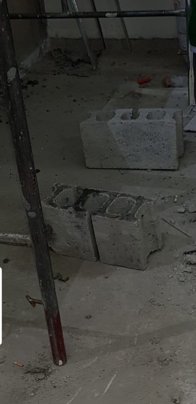

I just came here to comment on the masonry work, good thing there are no architects looking at these pictures, they would be screaming at the computer right now! Also, why is the vertical reinforcing in the vertical mortar joints between the blocks or is this a trick on my eyes?
Usually spacing between vertical rebars are 24" (600mm) and every 3 layers and they use 10mm.
I bought 12mm and told the masons to use spacing in between middle of each block. He did that right on the first layer but then on the second layer, that's the problem where the rebar is in between the blocks. He was supposed to be an expert mason, but I wonder why he didn't put them at the sides so all cells can be filled up.
Had I shown a picture when the wall was much lowered. And your eagle eye saw it. We could have corrected it. Our structural engineers (mostly) never visited any of their projects. They don't care how you connect them.
But then, in the literature like in the following, people used bars in between blocks in alternate layers.
Could the purpose so the wall shouldn't be too much reinforced turning it into a shear wall? Maybe there is a purpose? or just outright stupidity?
So I can tell the mason how to lay it properly, especially in the parapet.

How is your mason going to install the remaining blocks now that you've welded the rebar to the beam above?
The masons cut the middle and inserted it. He said they do it in all buildings.

If you're going the truss route, then I feel that the first step is figuring out how to construct and detail that. I've presented one option below.
As for the design of the trussed beam, I would be inclined to model the torsional properties of the assembly as a box or space truss, with the flanges represented by trusses having equivalent shear characteristics to the solid flange. As you rightly anticipated, this design exercise will be quite a bit more involved that just doing the basic checks on a built up HSS.

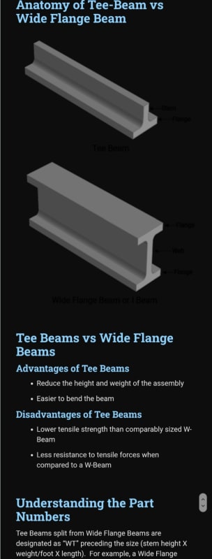

I found out WT comes from hybrid of Tee Beam split from Wide Flange beam.
This is very rare to find, and if our steel company won't cut 8mm 4x8 feet plate. The more they would not be willing to cut an Wide flange into half and then pieces!

I know of no such reference and, given how specialized the application is, I'd be surprised if anything were available in print

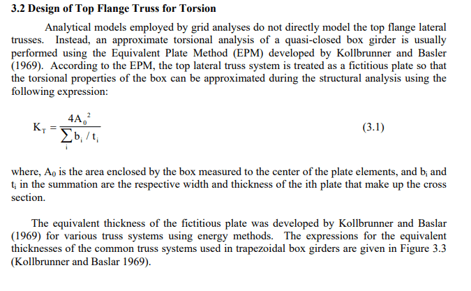

It's done in steel trough bridges (steel U beam with concrete deck). The top is 'closed' with a horizontal truss for the temporary case before the deck is poured. I can't find the reference used at a (very) former employer, but FHWA/TX-07/0-4307-1 appears,at a glance, to cover it (section 3.2).
I think similar would apply to stiffeners perpendicular to the web, just with reduced horizontal dimension of the equivalent box.
Edit: I suppose I could provide a link...
Thanks for that steveh49. I get a lot of mileage out of your familiarity with nifty resources from the bridge world. I'm even one of a very small number of people who owns a copy of the Kollbrunner and Basler book. Fun.
@OP: I feel that the trussing idea needs to be abandoned given the size of your beam. It's just not viable for something as small as a W8x21. I was imagining something much larger when I proposed my trussing scheme.

What would happen if you used trusses on the sides made of angle bars instead of whole one piece plate? It's very difficult to transport whole plates.
I have used the following reference before. The whole book is obviously too big to attach but I have extracted the relevant pages (ignore my handwritten notes).
Kollbrunner and Baslar (1969), Torsion in Structures - An Engineering Approach
I think KootK's screenshot make reference to this.
So given the w8x21 is very small, and has poor torsion, how do you strengthen its torsion if not for plates or trusses. You are saying the plates are only viable solution?
Perhaps we can get the biggest flat bar and just weld every 3" of them with thickness of 1/8"?
