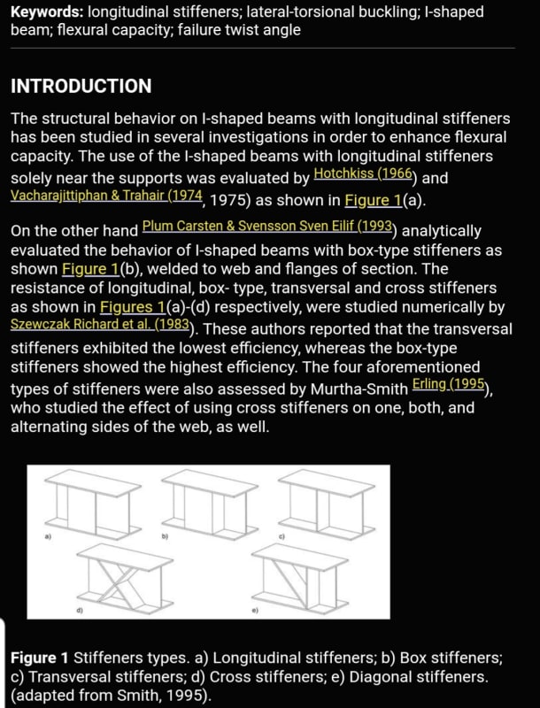

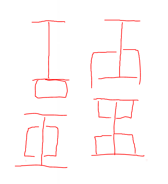

can putting such stiffener plates inside the web and flange (illustrated above) produce restrain against torsion? What is the formula for the spacing of the plates?

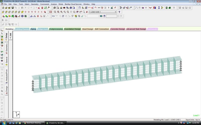

I have found that thread that I mentioned that includes some of WARose's modelling: Link.
The only time I use transverse stiffeners to stiffen a wide flange beam for torsion are when I want to:
a) Take a local load that was applied at the tip of the flange or such and make sure that load (and the torsion from it) gets into the member without local distortion of the cross section.
b) If I'm using those transverse stiffeners to brace back to a perpendicular member than can resist the torsion with its strong axis bending..... i.e. as part of a transverse moment connection.

So you need the web stiffeners presumably to provide supports for the flange where the eccentric loading is placed. Now you use the polar moment of inertia of the beam and mechanics of materials to calculate the rotation and shear stresses due to torsion (AISC Design Guide 9). After combining the stresses with other shears in the beam if you have a failure then your needing to reinforce the section. The idea of closing the section with a longitudinal plate on each side is probably your best bet. I have a hard time believing that the beam with over 10 times capacity for the bending moment is getting such a large torque (from the same load) to fail due to additional shear from torsion.
It seems like you had been advised to place stiffeners for the purpose of supporting the flange perhaps you don't need torsion reinforcement? If that is the only case you need to resist (see above commentary) the spacing of them is based on the flexibility of the beam flange, I think most people would pick a nominal spacing that is appropriate to limit deflection of the 4" CMU above. You could treat the flange as a plate supported on (3) sides and check deflection against limits appropriate for the CMU wall.
And yes closing the sides will increase the weak axis strength but the reason it has been brought up here is to increase the torsional strength and stiffness of the section. Torsion stresses are a function of the polar moment of inertia and there are only so many ways to increase that. All of the ways will also impact your in-plane and out-of- plane strength as well it would be difficult(pretty much impossible) to uncouple these different strengths.
The 39" high 4" thin masonry parapet will be put at center of the wide flange ibeam. Not eccentric. There will be vertical reinforcement inside each masonry block welded to the top of the ibeam (think studs).
The longitudinal side plates reinforcement of the Ibeam (turning it into HSS) is to resist moments induced by wind or seismic that will sway the parapet out of plane back and forth. So what I need in your terminology is torsion reinforcement?

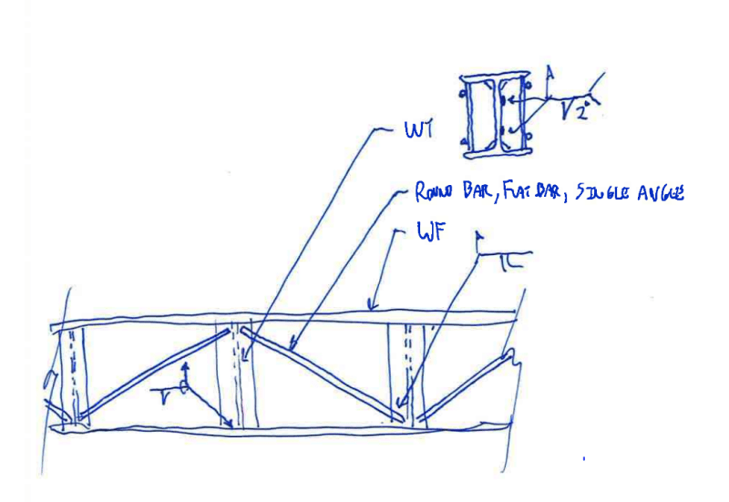

If you're going the truss route, then I feel that the first step is figuring out how to construct and detail that. I've presented one option below.
As for the design of the trussed beam, I would be inclined to model the torsional properties of the assembly as a box or space truss, with the flanges represented by trusses having equivalent shear characteristics to the solid flange. As you rightly anticipated, this design exercise will be quite a bit more involved that just doing the basic checks on a built up HSS.
I don't know what your particular constraints are but there are plenty of ways to reinforce a beam for torsion using non-plate sections.
