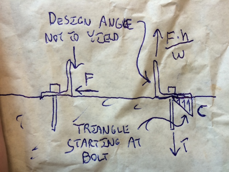

Hey everyone. How structural engineers would treat this problem if they had to determine all forces on all fasteners of a column loaded in the following way on top? (ignore weight)
h=w=10 in. a=b=1 in.
I've consulted several engineers, and each had a different way of resolving a force and of selecting a point of rotation, and in the end the answers of loads on the fasteners were very different. (some ways include prying, others don't) So what would you do?

For this example, if we can determine that the fasteners fail in a non-brittle fashion, and under good service, then any reasonable load path will suffice (the smallest tension will result from the largest moment arm - (13" - c/3). If the fasteners fail in a brittle fashion, or deflect too much, it makes sense to find another element that yields and redistributes the overstresses so that our simplified load path still yields a valid design.
For prying action on steel elements, we assume yielding of the base plate element (angle leg in this case) and verify that the steel will bend and deform before the stress on the fastener can be exceeded. If everything in the connection is brittle then the strategy is to detail the system to minimize load paths (add stiffeners to the angles and, to prevent prying, washers between the base material and the column) and increase the safety factor. This is appropriate when detailing steel for fatigue loads.

For the design of the angle, I would replace the triangular stress distribution with a line load out at the toe.
Find the moment created and figure out the tension required by the top angle. Assuming this is static loading and the load conditions will never change you can then design the bottom angle for the shear forces.

OP said:
Hey KootK, without the fasteners (bolts) between the column and the angle it is easy to assume that the entire force F goes through the left angle as in your picture.
Easy? Pfft. There was nothing easy about it. It was the result engineering judgment honed over a couple of decades of professional practice my friend. I assumed that the shear would go 100% to the left angle because I see that as the stiffest load path, particularly as I suspect that the "box" will be thin a walled piece of equipment that would make the shear connection to the angle on the right hand side comparatively flexible.
That said, if you wish to be more conservative, simply design the bolts in the right hand angle for the tension that I showed and the full shear associated with force F. This should be of little consequence for the design of the bolt or the design of the angle. If you're close to the edge of your concrete, the shear force may need additional attention as it pertains to concrete breakout.
OP said:
You would get a smaller T in your right anchor.
I would never use the application of the force F in the right angle to reduce the bolt tension as I would deem that unreliable and unconservative. Remember, not all of your members will be designed based on the same force distribution here. A model that is conservative for one component may be unconservative for another. In the absence of knowing the "true" load distribution, we compensate by considering multiple distributions and applying them conservatively to the particular components under consideration.

Looks like Koot's finally gotten to the point where he's literally answering questions on the back of a napkin.
The first draft was actually on the palm of my hand. I thought that looked desperate, however, so I borrowed a pen and some garbage.

Thanks for a nice clear drawing :).
I think I'm going to do F*h/w to get pullout and apply it to fastener 1 (its a bit more conservative ...say to deal with some tiny prying)
The shear on fastener 1 will be F/2.
For fastener 2 I will apply Pullout=F/2 and Shear=F*h/w
(I will have some equipment inside that box, so the weight will counteract around 50% of overturning force. So (F*h-W*(w/2))/w will hardly ever be larger than F/2 for pull-out on fastener 2)
