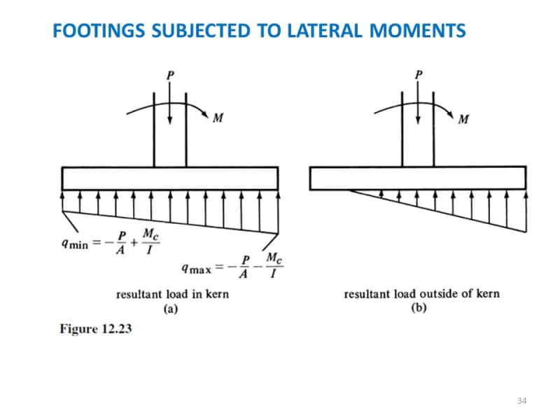

Presumably, your free body diagram is of the plate-concrete interface. In that case, consider that there is only partial contact on a plate without bolts. In such a situation, how do you envision the rotational fixity to manifest? Without bolts creating a force couple (compressive bearing of plate and bolts against concrete, tension in bolts on the side with contact loss), there is no moment transfer and thus no rotational fixity.
The pad footing does not work as an analogy, because that is related to overturning and allowable pressures - not restraining rotation.
PS. The footing case (in its basic form, applied to a footing) involves calculating the stress below the footing with basic beam theory formulas. It has nothing to do with moment transfer from beam-->base plate --> bolts --> footing and the detailing required to obtain such moment transfer.
