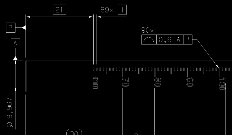

So I've found one of those "sounds simple at first" problems.
I have a part with a laser marked scale, imagine a glorified ruler.
I need to specify the tolerance of the laser marks, specifically three things:
- Absolute position of each mark from end face
- Line Spacing between adjacent marks
- Thickness of each mark
Now the standard method would obviously result in an absolute mess, as the scale is 140 mm long (1 mm increments).
Is there a better way?
I've considered using position and TEDs but I think it is unclear. The most important thing is the absolute position of each line from the end face, so this is what I wish to be inspected, not a bunch of 1 mm increments.
There's ordinate dimensioning but I don't know how that works (oh I'm ISO btw, spice it up a bit).
I feel like there should be a way to start speccing them from the end face and do a kind of "..." ?
Any help would be appriciated.
Here's a pic for reference:
Since you need all marks accurate relative to a reference, what if you make the end edge from which the marks must be located and the edge along the length of the ruler to which they must be perpendicular your datum references, and specify profile of a line to control the pattern of them all?
Position tolerance is probably the most clear and easiest option. Make the spacing between each mark a TED of 1mm. The linewidth can remain a limit tolerance. Attach a position tolerance to the midplane of the line width and I'd suggest using the front or back face as your primary datum, the top face as your secondary and the end face tertiary. I'd probably do the linewidth and 1mm dimension in a zoomed in detail view for clarity.
Ryan.

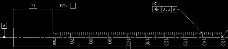

I had a go putting position on it,
see below.
I'm not sure if this is very clear though as I think it could be interpreted as inspecting all the 1mm increments, rather than all the absolute positions.

You're not supposed to place the datum feature indicator on a centerline. If you want the datum to be a center plane, you are supposed to attach it in line with the width dimension.
Also that center plane is not a reference that can be used for location in the length direction.

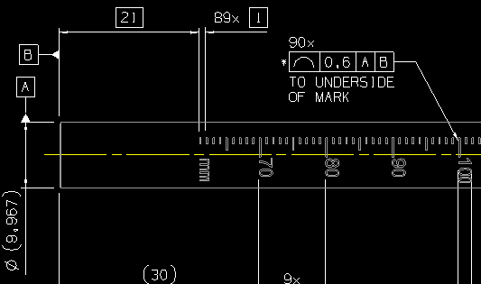

ahh so I should really be putting a datum on the end face too, though it is the the axis (A) that defines the orientation, so maybe the position should be to A B like: |pos|Ø0.6|A|B| ?
I guess inspecting this should give a list of measurements like so:
"61" Line | 0.02
"62" Line | 0.21
"63" Line | -0.10
"64" Line | -0.35
... etc for all lines.
I'm guessing the reported value would be the larger deviation from the nominal in either direction...
- doubled. Because if you get to one of the limits of the zone by offseting half the tolerance value from nominal, it is considered that you utilized the entire tolerance band. So, any deviation is doubled.
Other than that, your new drawing looks OK.
Just note that the profile of a line tolerance doesn't control the length of the marks, so I guess for full definition (if intended) there would be some additional requirements needed.

If I spec it as a position instead would it be the same?
Does this mean all outputs are positive and agnostic of direction?
I'd quite like to know which way the marks are out by, so perhaps, for once, GD&T isn't my friend.
If you're asking in terms of the reported value, then it's similar; you would still report the size of the smallest zone constrained to the theortically exact location that would encompass the element you are controlling as produced. So, you would not understand the direction of deviation from looking at the measured position value, but you would from the additional data documented.

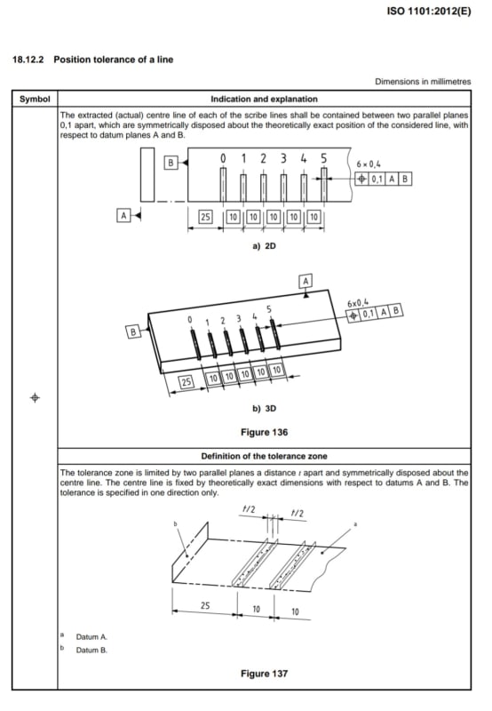

For what it's worth, if the result of a laser mark is comparable to the scribe line, I guess position can work too:
I wonder why they call them lines when they are clearly straight sided slots. I suppose the ISO committee has to pander to the demands of some contributors just as ASME does.
3DDave, Is it even realistic to machine "scribe lines" that are rectangular slots?They are usually made with either a small size ballnose end mill that leaves a slot with a round cross section or a dedicated scribing tool with a conical tip that leaves a triangular slot. If it's milled by a ballnose end mill, chances are that the depth of the slot will be smaller than the radius. I wonder what tolerances they would exemplify for that as part of a figure in a tolerancing standard.
The majority I have encountered are either crap that is roller impression formed or an excellent job of photo-etch.
Somehow typography, which markings are closer to, has managed well enough without geometric tolerances.
So I think I'll go with this for defining the absolute position of each mark.
My question is whether I need the datum A? or would B be sufficient?
I only included A to orientate the datum, but is that making it more confusing?

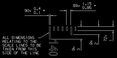

The other dimensions are taken care of here.

You do need your datum A as primary to orient the tolerance zones, otherwise, if you only use B, any out of perpendicularity of the B end face relative to the cylindrical surface will make the orientation of your marks way off relative to the axial direction.
Other than that, I'm not sure you need the 89X 0.85-1.15 spacing since you have the basic spacing of 1 mm under control by the profile of a line tolerance.
