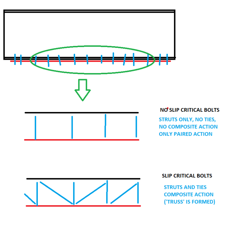

This might be a pretty simplistic and obvious explanation. But it is how I like to break things down in my head if I ever end up scratching my head too hard regarding shear flow. I break beams up into trusses. Or in this case break the flange and cover plate up into a truss. I then chase the load paths.
Here is a PAINT drawing to go with my simple analogy.
I don't think that sketch is an accurate representation of shear flow. Whether the bolts are SC or not, there are still only horizontal components of resistance being provided. However, at the plane between the plate and the beam, you are only resisting shear (which does have vertical components), so the strut and tie sketch isn't really appropriate anyway. The question is how much deflection you can live with, without failure. I would just email the AISC solutions centre, they are very good about providing answers, but it seems odd that this would be an unintentional mistake. My conjecture is that at ends of the cover plate (where it is no longer needed), the strains required to engage the bolts would probably cause undesirable deflections and are also less likely to occur before the beam is overloaded - think of a simply supported beam under uniform load, strains are greater at mid span and go to zero at support, so a cover plate at the ends may never be engaged.
I believe there is a misunderstanding here. From my perspective there absolutely is vertical and horizontal components of resistance being provided by slip critical bolts. The friction from the slip critical nature is a horizontal component and the vertical is provided by bolt tension or direct bearing compression between the plate and the flange.
In the absence of any intermediate bolts (slip critical or not) then then yes you would lose your vertical component of resistance as the plate would hang loose. But that isn't what we are talking about here.
There's no vertical or horizontal component being provided by SC bolts that snug tight bolts don't also provide, only instead of friction the shear resistance is provided by bolt shear. In either case it doesn't align with the truss analogy.
Agreed with the vertical aspect. Hence my truss analogy picture showing vertical struts. But disagree with the horizontal aspect:
But as has been pointed out by others, bolt shear (more accurately bearing) wouldn't occur with the expected differential deflections. You need to have significant ~1-2mm of movement before a bolt in bearing approaches capacity.
I hope my above points might have fully explained my initial post such that we are now in agreement. But if not I'll probably just let this slide as a difference of viewpoint. [smile]
