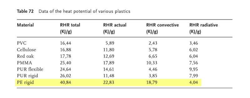

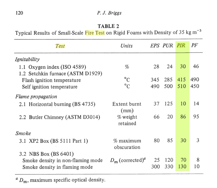

Looking at the fuel load of both the Reynobond ACM Polyethylene panels and the Celotex RS5000 Polyisocyanurate foam insulation, the Polyethylene has a possible fuel contribution 3.8 times more than the foam insulation. A 3mm x 1m x 1m sheet of Low Density Polyethylene weighs 2.85kg. 150mm of Celotex RS5000 weighs 4.98kg per square meter. The fuel consumption of Polyethylene can approach 100%, while the residual weight from combustion of Polyisocyanurate is 85%. So for every 2.85kg of Polyethylene available for consumption there was 0.747kg of insulation.
What is interesting is that neither of these materials could have behaved separately as they did together. Removing an external flame source from ignited polyethylene, the flame retracts to just above the surface of the the leading edge of thermal decomposition. Along this edge, there is a pronounced blue component to the flame, denoting efficient fuel consumption & pronounced "convective" heat generation. Of the 3 types of heat that contribute to a fire; Conductive, Convective & Radiant, conductive heating is the worst. The conductive heat released of Red Oak is only a third of its total caloric heat value, whereas Polyethylene releases almost half its total heat in the form of conductive heat. Add back to the Polyethylene the original flame source at Grenfell Tower and confine it to a chimney like space and it creates very suitable conditions for the Celotex to ignite.
What makes the insulation special, is that once its initial resistance to burning is overcome and the Isocyanate component burns, it releases the other main component of the Polyisocyanurate foam, Polyols. The fire generated by polyols is fast and "vigorous" and like the polyethylene produce large amounts of heat. The burning fridge at Grenfell provided the flame source to ignite the polyethylene and the burning polyethylene created the right conditions for the fire resistance of the insulation to be overcome, where by the burning insulation provided the polyol charged flame that kept the polyethylene in near absolute fuel mode. Throw in the air gap and the aluminum for a 'conductive heat' component, pre-heat the polyethylene ACM in advance of the flames and it really was a worst case scenario. Link

Looks like it was known you shouldn't use solid foam with combustible panels.
The comment about them being 30% cheaper clearly won. Ditto the cheaper outer panels.

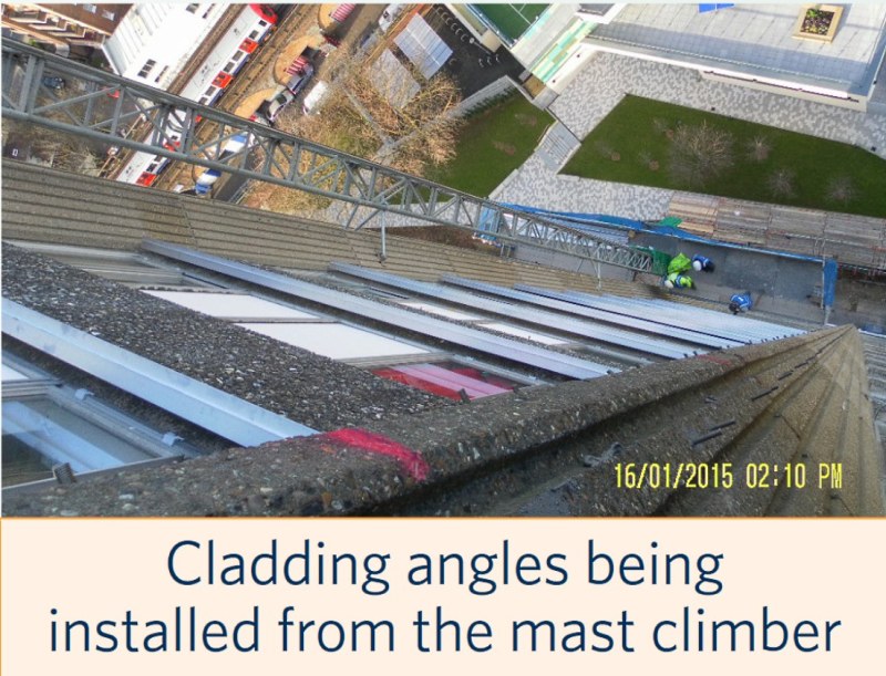

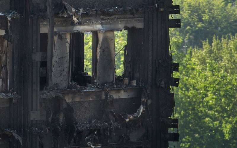

Before fire entered the flats at Grenfell Tower, smoke was seeping through the window casements. In this video the "white' smoke isn't captured by the camera within the flat because of the well lit interior side of the window but the double glazed window creates a filtering effect that reveals the smoke penetration, via reflection on the second, outer pane. Link
So why was smoke entering the flats from the window casement surround? I suspect an air gap was left unsealed when the horizontal surface mounted aluminum L brackets were installed against the exposed aggregate spandrel panels. The new windows were reset outward onto the aluminum L brackets, mounted top & bottom, from the older window's original placement on the concrete spandrel by approximately 8 inches. Add in that the concrete spandrel panels would have had a chamfered edge along with the very rough surface texture of an exposed aggregate (large aggregate) and the matter of fire & smoke compartmentalization becomes a problem, not just side to side but top & bottom. The gap between the window angles should have been filled with non sag cementitious compound. Rough numbers, about 600 cubic feet for all four sides.
