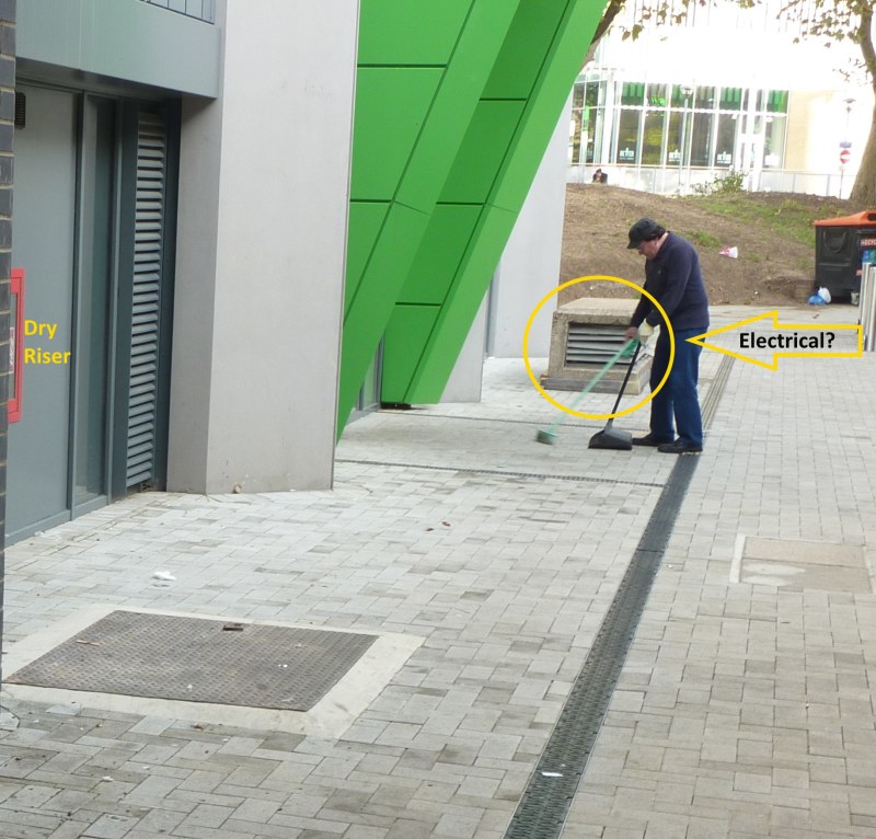

Reading a bit more about events at Grenfell Tower in 2013 which may be relevant to the 2017 fire:
It seems to be the case that the building is supplied at low voltage from the public system rather than having its own HV intake and local substation.
A problem appears to have occured on the supply cable to the building which resulted in a high resistance or open neutral condition either in the cable itself or, more likely, at a joint in the cable.
It would be interesting to know a little more about the 2013 fault, and what was done to repair it, because it seems plausible that the 2013 repair has failed or the same problem has occurred again at a new location. Accurate technical reports don't appear to be readily available, but there are several references to a serious problem in 2013 which could well be the precursor to the 2017 fire.

Seems that way - the symptoms described are certainly similar, with brownouts, surges and a handful of appliance fires occurring. In the 2013 event the failed neutral appears to have occured externally to the building on an underground cable. Cable faults are rare in cables which are correctly layed and backfilled, but poor installation techniques can damage the cable which leads to failure many years later.
I also wonder - in a purely speculative way - whether the cable has a reduced cross-section neutral compared to the phase conductors and the basis that a well-balanced load would not result in a large neutral current. If the load became sufficiently imbalanced then it is possible, in theory at least, that the neutral conductor would be under-sized for the current it was carrying. This type of cable was definitely used in the early 1970's.
If indeed the problem was external to Grenfell Tower, then the cause of the electrical problems should have been recorded. Peter Maddison – Director of Assets and Regeneration, the Head Honcho for KCTMO on the Grenfell Refurbishment project, told the RBKC Council that subsequent to the power failure, monitoring equipment (Data Logger) had been set up. If the data-logger was set up externally, wouldn't this have been done by UKPN, the power distributor or does/can one hire a contractor to perform supply side monitoring? What good would private data logging serve if the issue was caused by UKPN? If the Neutral Fault was external, how did KCTMO's contractor find it, via an in ground vault outside the tower, excavation? Supposedly the root of the problem was finally discovered over a 12 hour period, when all the residents had their power shut off by the contractor.
Leadbitter working on the KALC project adjacent to Grenfell Tower, denied that their work had anything to do with the power problems at Grenfell Tower. Here is a pre-construction site plan that, as near as I can tell, shows the power supply to Grenfell at the South side of the tower, running East, then Northeast across the park, up to Verity Close & on to Silchester Road; bisecting the KALC Project. Link
Surely at some point in the work done on the KALC project the power to Grenfell had to have been a complication. Maybe the original site work was fine and the temporary work around was not. That is, if the site plan & my interpretation is accurate.
When Peter Maddison – KCTMO Director of Assets and Regeneration told the RBKC Council's Housing & Property Scrutiny Committee that some of the residents had confused smoke with steam & the bulk of the Committee bought into this nonsense, it becomes hard to believe the Council was concerned with anything more than being able to distance themselves from the problem and thus the entire exchange between the Council Committee & KCTMO becomes suspect. It seems only the Council Woman representing the Estate took offense with the explanation. Anytime I've been offered mealy-mouthed explanations that stoop to implying utter stupidity by some other party, my confidence in the person voicing the the explanation takes a nose-dive. How does one confuse the acrid smell of an electrical fault with steam?

I am ignorant on electrical but how does an external fault, fry appliances on just the upper floors, over 30% of the flats. Presumably, fry the main electrical riser yet the lower & intermediate floors are unaffected, even though they all experienced power issues? Separate mains?

If the neutral fault occured in the main feeder cable then everything downstream of it would experience the symptoms of the fault - i.e. variable, load-dependent line-neutral voltages. I'm not at all clear on how the building power is distributed but it is vaguely possible that the top third of the building is on one phase, the middle third on a second phase, and the bottom third of the building on the third. Not how I would do it, but not impossible.
A single-line diagram of the building power distribution would be invalauble in ending the speculation, although I doubt one is likely to surface.
