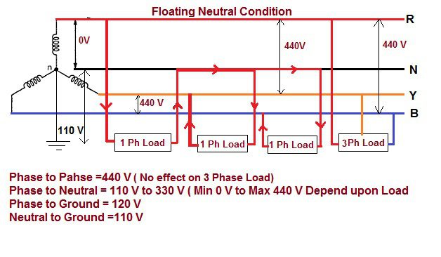

The electrical fault has all the indications of a high impedance or lost neutral connection. The net effect of this failure mode is that the single-phase supply to each unit, which is derived from a 3-phase intake, is no longer fixed at 400/[√]3 = 230V. The voltage appearing at the individual units could range somewhere between zero and 400V, and the exact voltage is determined by how the overall loads on each phase interact with each other. Electronic loads would typically burn out / catch fire fairly rapidly when faced with a gross over-voltage. Rotating loads such as motors would probably tolerate if for a bit longer prior to blowing a line fuse. The problem isn't confined to capacitors by any means.
I can't answer any of the questions about insurance and liability for legacy problems.
ScottyUK, " The voltage appearing at the individual units could range somewhere between zero and 400V, and the exact voltage is determined by how the overall loads on each phase interact with each other."
Is the voltage a sinusoid from zero to +/- 400? or that the voltage delivered could range from zero to 400 (I assume +/-?

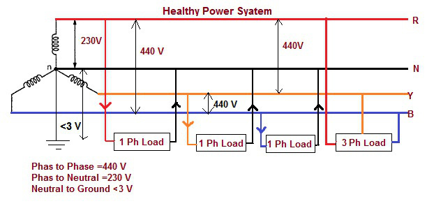

The voltage will be sinusoidal, but it's magnitude is determined by how the connected loads interact with each other and that will vary as loads change (i.e. things switch on and off, fuses blow, things go bang, etc). It's probably easier to explain with a couple of diagrams. They're not perfect for the task but I'll try to explain around them:
In a healthy electrical system the line-line and line-neutral voltages are defined by the transformer which comprises of three windings, each of 230V but with 120° of angular (time) displacement between them. This angular displacement results in there being 400V between any two lines, but 230V between any line and the neutral point. In the UK, residential supplies are connected between one line and the neutral point.
If we can assume that all the loads are connected to the neutral, but that the neutral conductor breaks or develops a bad joint somewhere near the transformer. The voltage between lines is still 400V, because that's determined by the transformer windings. Without the connection back to the transformer neutral point there nothing to force the line-neutral voltage to be 230V. The voltage between line and neutral will be determined by the relative impedances of the loads connected between each line and the neutral, so a heavily loaded phase will see the line-neutral voltage collapse, while lightly loaded phases could see something approaching the full line-line voltage of 400V.

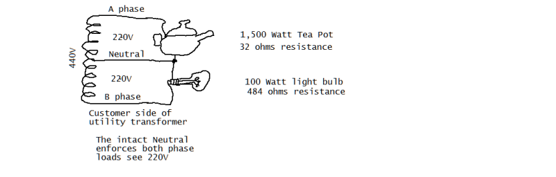

A.
Scotty's correct diagrams may be a little confusing due to the three phase aspect so I've simplified them to a single phase situation.
A normal single phase installation with each phase being exactly half of the 440V supply because of the center tapped neutral.

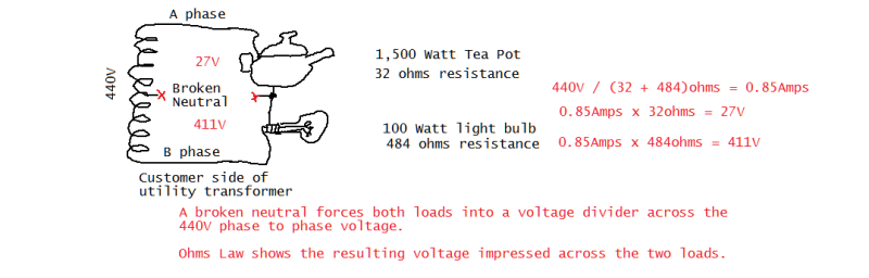

With a faulty neutral often caused by a loose connection or corrosion or both you no longer have a rigid half of the 440V across the two loads. Instead you have something....worse. You have various voltages depending on the individual loads connected at any moment.
You can see the light bulb will take a beating. Typically this would just be a bright flash then the circuit would be open. However if the bulb was instead something with real mass like a small motor it would heat up in a few seconds to a fire starting temperature.
Picture the complexity of a large apartment complex where perhaps a thousand devices are in the mix. You typically get less of a voltage difference just because of the averaging of a great many typical loads. What you get though is perhaps 180V and 260V which can actually be more insidious with overheating and fire starting as it can allow things to overheat slowly enough that circuit breakers fail to trip as they would with a large overload.

Thanks Keith, that hopefully makes what i was trying to describe a bit clearer. :)
It certainly does, and a LPS for Keith!
Thanks Keith ("itsmoked") - that's a great description of faulty multi-phase power for non-electrical engineers like myself. (I had to do a bit of power and electronics as part of my undergraduate Civil / Structural Engineering degree; unfortunately, I am colour blind, so more often than not, I would be hooking up the wrong wires and / or using incorrect resistors, so most of my lab work ended with a release of the magic blue smoke.) These days, I stick strictly to low voltage hobby electronics (< 12 V), and I use a multi-meter to test every component before hooking up the power supply.)
The litany of professional mis-management at Grenfell Tower is just gob-smacking. It seems quite likely that defective power could have been a causative factor in the initial fire, and the on-going issues suggest that it was only a matter of time before a significant apartment fire broke out. This in itself is bad enough, but compounded with the choice and design of cladding system, a small manageable fire quickly became a catastrophe.
Thanks ScottyUK and Keith... I can now see what you're talking about. I didn't realise the open circuit with the neutral could have that effect.
