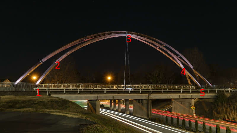

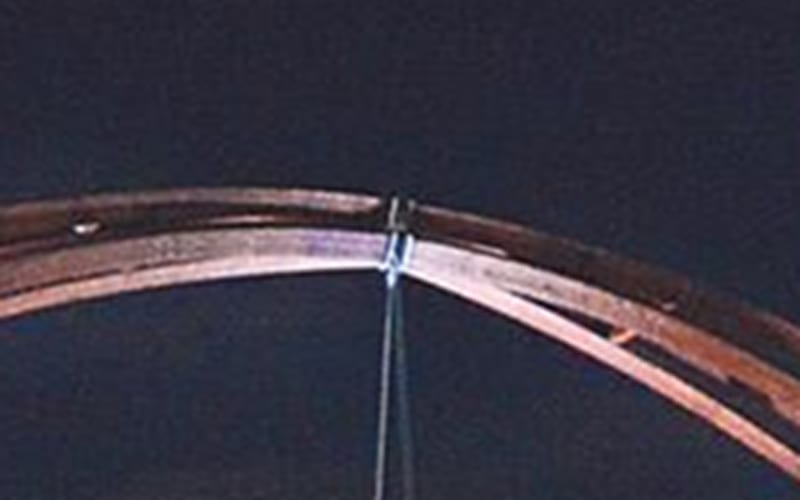

Lateral stability aside, these appears as 5 hinged arches? Isn't that inherently unstable?

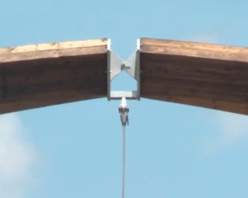

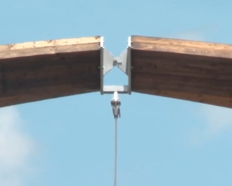

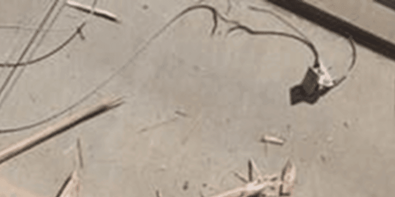

There appears to be a significant gap at the apex of the arches with a simple, single bolt connection. I can't yet imagine how the guy wire mounts were included but the mount for the lower arch came away clean (as seen in previous images laying on the deck) and the mount for the upper arch appears still fixed to the west weldment but there is no damage to the east weldment. I guess the guy wire for the upper arch can pass through the gap in the lower arch connection.
That pin connection looks awfully flimsy ^. The pin holes in the clevis plates have almost no edge distance. The plates appear very thin. Was this really holding the whole arch together??

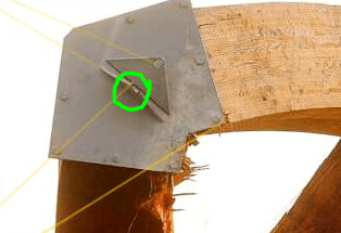

The area circled in green appears to have been torn out. Could this tear-out failure of the pin have caused the arch to collapse? Alternatively, the other side of the clevis appears to have collapsed at its base, which is not surprising considering how thin it is. Could this have initiated the pin to become dislodged and tear out of the other side?
I would image that under wind loading, one side of the clevis would have been in tension and the other in compression. Perhaps this bending through the connection was overlooked, because it might have been thought that the guy wires would eliminate such an effect. But the guy wires appear to be awfully flimsy as well and not in a particularly effective arrangement as I mentioned in my first post.

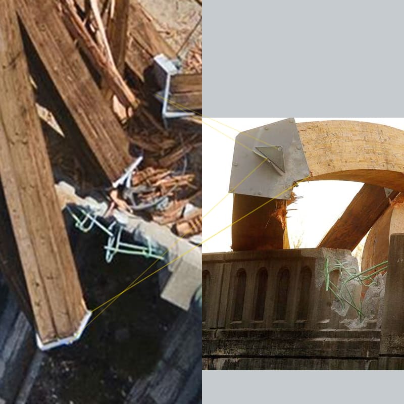

Connection of lower arch prior to work stoppage to address structural concerns (May 20, 2021):
(Video source)
Compare to the piece on the bridge deck ???:
EDIT: It appears that this clevis mount is indeed modified before the completion of the project. (see further posts below)

The structure likely experienced buffeting during its entire life. It is a large sail of significant mass so any movement would likely work over the joints pretty good.
Wow! If this "connection" isn't the cause of the collapse, I will eat my hat.

When I look at the pictures of the completed decoration, I don't see a connection as shown in that photo.
The connection you are referring to appears to have been temporary and long gone. If so, it's kind of hard to see how it could cause a collapse, since it didn't exist anymore.

Tomfh, agreed. I would say that a traditional 3-hinge arch turned itself into a 5-hinge arch with the failure of those 'knuckles' at the top of the wishbones, and that is not a stable structure.
That may have been the intent, but had the structure 'stood up', whether it wanted to or not, the cable stays would have had a real impact on the strength and behavour of the structure. Just because you label them as decorative, unless you detail them as such, they may not be.
As I noted earlier, "I'm not sure what the cables are for... if to provide support of something below, they might have been OK. If to provide lateral support at the top, not so good. Any horizontal load at the top would greatly increase the force in the cable because of the 'steep slope'. We'll have to wait and see why it 'broke'."
