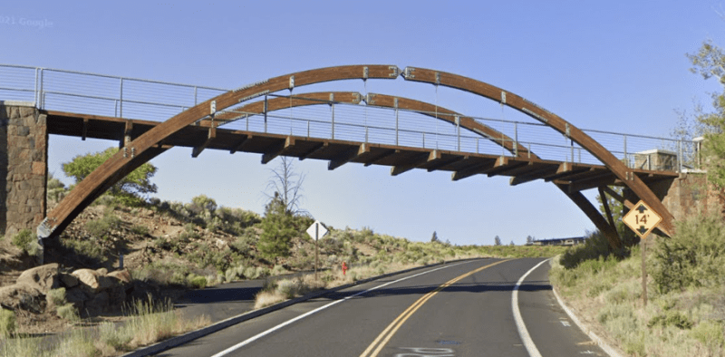

If you look at Western Wood Structures portfolio ( [URL unfurl="true"]https://www.westernwoodstructures.com[/url] ) as well as some of their YouTube videos, they use this type of pin connection quite a bit, through this arch uses the 'lightest' example of it that I have seen. I suspect it is used in dealing with the expansion/contraction of their structures.
None the less, Western Wood Structures is pretty clearly not a run-of-the-mill 'design' firm as they have some simply phenomenal structures across the world (some of which I've seen in person) - which makes this arch creation (and failure) all the more baffling.
The lower UNINTENDED hinge points, that is. You can't have a stable arch with more than 3 hinges.
It is hard for me to tell with the grainy security camera footage (seems to be a staple here at eng-tips...), but it sure looks to me like the tip started to fail first and then overloaded the lower fixed "hinge" points causing them to fail and twist as it rolled over.
I cannot imagine it would take much horizontal load on that single pin joint at the top to cause it to tear out as it appears in gusmurr's earlier post.
Maybe the lower part is intended to be fixed?
Those cables definitely look decorative, with the way they're attached and the angle. I guess they were just tensioned enough to look good. So what was supposed to be stopping it from blowing over?

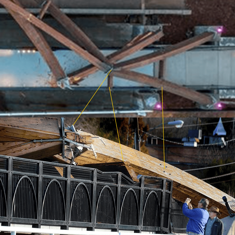

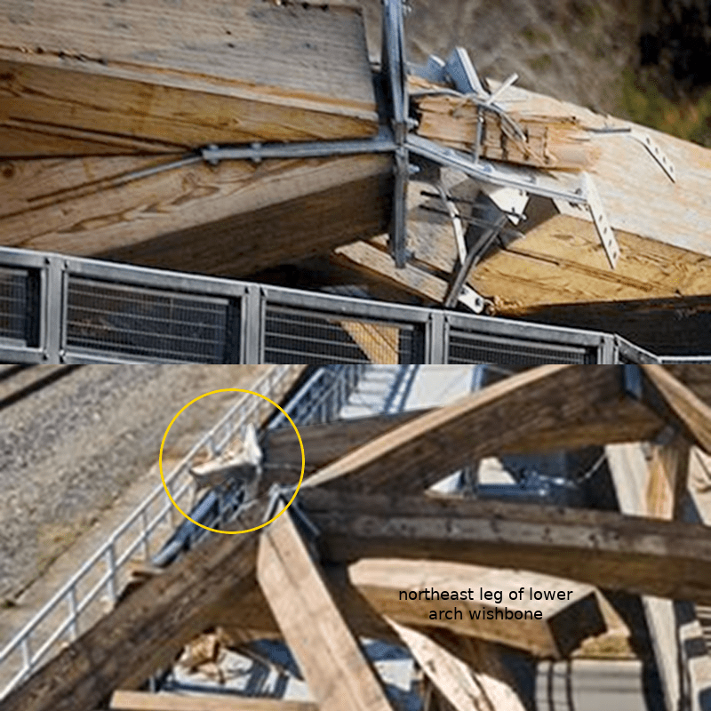

... perforated metal strips must have been the repair as they're not visible in other images ...
Thanks for posting, I was looking for images relating to the repair or where the crew may have been working at the time but had not found any. That flimsy repair may be the key. A closer analysis of the videos just posted may reveal that leg buckling first.
I believe it's the connector of the lower arch on the east end of the structure. In the closeup, the timber to the right of the connector is of the upper arch. Only a fragment of the lower wishbone remains. That southeast leg fell off and under the bridge.

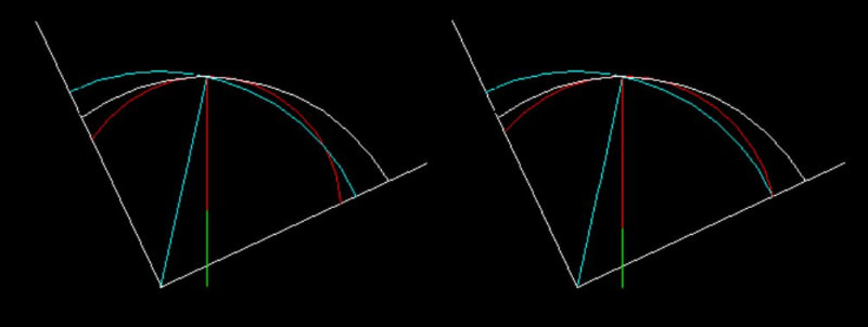

I just discovered that the location of the elevated hinges may have contributed to the collapse. Take a gander at the sketch. By elevating the hinges, the extension to the cable can be minimised so it offers little lateral resistance. That may be the cause.
The blue is the trajectory of the cable and the red is the trajectory of the crown of the arch from the elevated 'base'. The white is the trajectory of the crown of the arch if the rotation were about a non-elevated base. The difference in the two schemes is the location of the elevated base.
yes, the red thing and the red trajectory... nearly matches the blue cable trajectory. The white shows the extension to the cable required if the base of the arch were at the bottom, and not elevated to the point at the intersection of the green and red vertical line. The cable may not even be broken. I'm just trying to show that the cables may have been totally ineffective, or seriously compromised. the white lines starting from the base of the cable are 'trim' lines only for cutting the circle circumference. [pipe]
I just realised that in the Right Sketch, the cable is in tension. In the Left Sketch the cable is mostly partially in compression and the first rule of engineering is that you can't push on a rope... maybe we've solved the manner of collapse.
