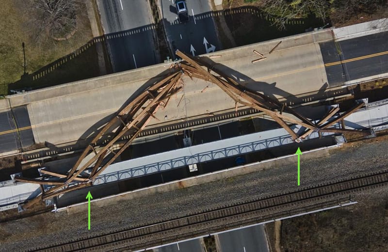

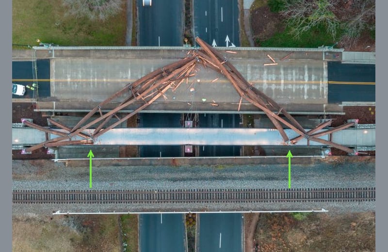

The wishbone connections on the lower arch appear to have suffered worse damage than those on the upper arch. The south east leg of the lower arch even ended up beneath the bridge. Also notable is that the center of the arch pushed slightly east, in keeping with the wind direction relative to the span.

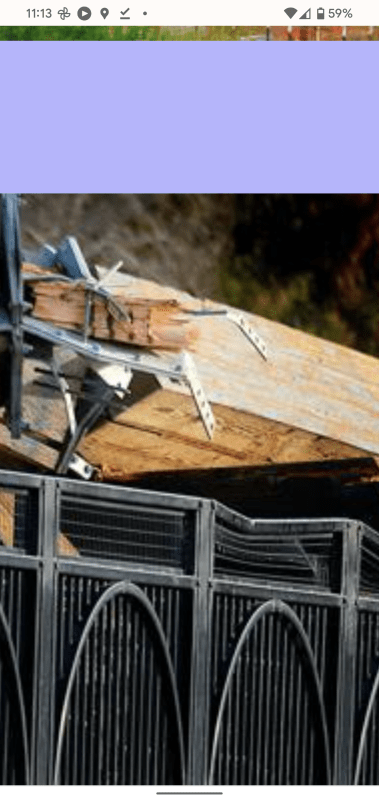

This picture was posted earlier. These perforated metal strips must have been the repair as they're not visible in other images.
The arches seem to be flanged together in th lower 1/3. I question the strength of the flanges that connect the arches at 1/3rd height. They are so very thin. It's so bad it's as of someone forgot to carry a zero.

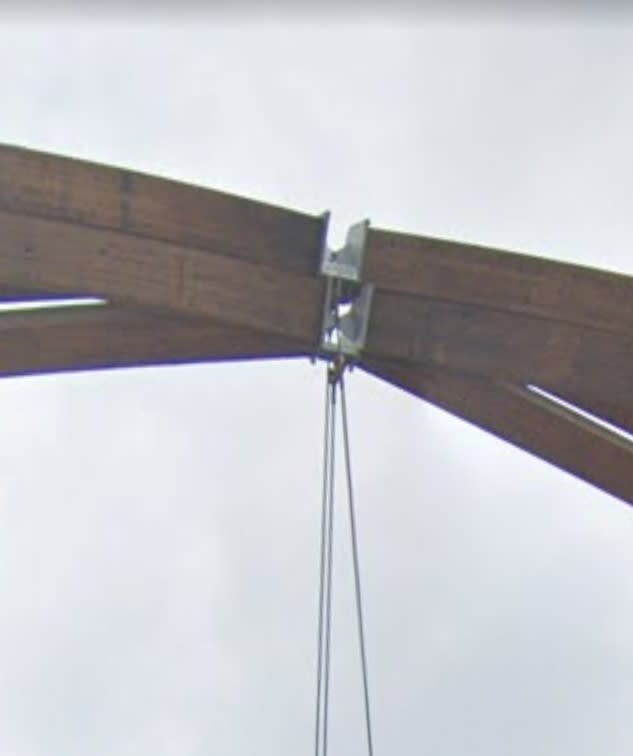

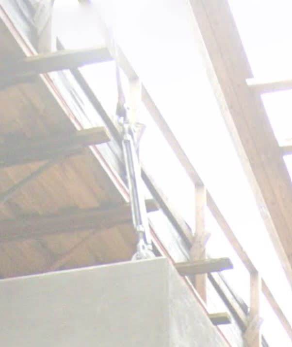

Make of these what you will. I don't understand them but that centre connection looks like a pin to me. Also the turnbuckles on the wires are nearly out of room on tension.
Obviously designed by an artist and not an engineer. That pin joint at the top would have been rejected in 15 seconds by any half competent stress analyst. The other “connections” look horrible also.

Alistair: you notice that the cable bracings are at a 'shallow angle' If they were at a steep angle, the tension load induced in the strand would be huge with any lateral loading on the and they would likely tear free from whatever they were attached to.

Dunno... the top hinge is fairly tall for the span and the reaction at the crown pin in horizontal shear, if half arch is 20T, would be approx 40x0.5x0.5 about 10K plus whatever wind loads are applied (they could be big)... these are not a real big loads, so the connection may be adequate. Looking at the framing, 80K seems like a pretty big weight for the timbers, but I haven't tried to see what the real load is.

Yes I did and there was no load fuse.
Thats why I think they were only envisioned to alter the natural frequency but only in one plane.
