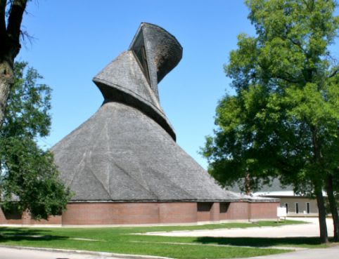

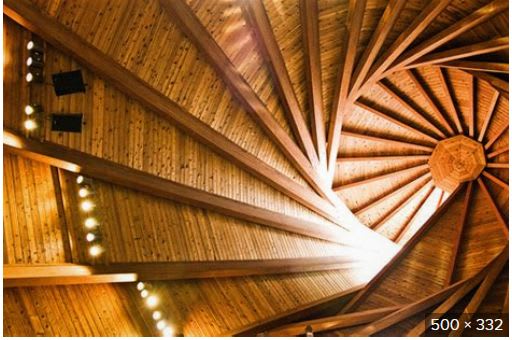

Connections would be a nightmare... Catch the following, Precious Blood Church in Winnipeg
I understand the shop drawings were a b*tch and they ended up just getting a bunch of glulams and cut them to suit on site.
