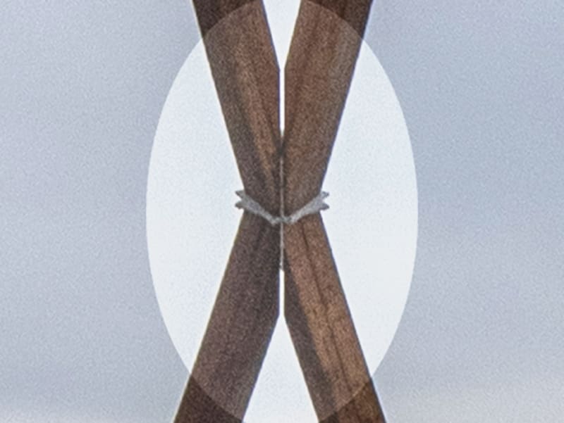

The joint that is key to this is actually the one at the top of the wishbone I think.
That's where artistic impression of continuous strands of wood gave way to engineering reality and where the failure almost certainly came from
I think so, too... it's interesting that the connection at the very top can likely take the forces; they should'n be huge... and it looks so flimsy, almost a little out of proportion. From a load point of view, it likely works.

The extreme closeup (on the ground) seems to be one of the two pieces of the top connection. I note that the cable anchor is conspicuously missing, and assume it was added after the arch was assembled, and likely cut to length. It kind of messes up the "purity" of the single bolt connection.
In the photo shot directly from one end, you can look up towards the near "outer" connection and see three steel plates assembled together. What is weird is that they're not flat and flush with each other--"bent" would be the word I would use. I could wonder if the person who designed this structure spent much time on figuring out how it would be assembled.

You are right. As I see it, each laminated timber member is fitted with a weldment which slots into the members end and extends proud of the member to allow for bolted connections to adjacent members. These individual members are then connected to each other with an additional weldment configured to accept the various members. At the connection to which you refer, you see two end plates and one junction weldment between them.
At the peak junction, you will find an end plate on each member and each of which is bolted to a mount plate. The mount plates then connect with a single bolt.
The following image shows just how minimally, the timbers are connected at the wishbone:

Quite right. I was horrified by the concept as soon as I saw the detailed pictures, and certainly didn't need to do any calcs to back up that impression.
A model, built with pipe-cleaners even, would have identified the weakness of those joints to lateral flexing. There are even lateral triangles in the design, but rendered immediately useless by balancing them on their tips. It is almost anti-engineering.
