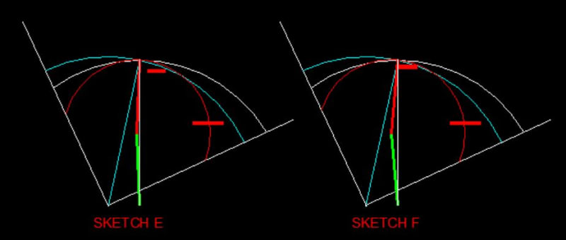

The 5 “pins” would have provided some rotational resistance, but not enough to keep it standing.
It's all dependent on how secure the bottom supports are. If they can provide a rigid base, then it's a three pinner... if not, it's a 'turkeyshoot'. the movement appeared to be limited to the top three pins, but my failing eyes cannot tell for sure.
It was only a 5 pin arch for forces parallel to the axis. For lateral force (wind), it was unstable above the wishbones once the rotational resistance of the connections was overcome. The cables may have been provided in recognition of that instability, but did not do the job.
Concur... even the cables may have had a 'snap through' point where they became useless... and see how quickly it becomes unstable with movement:
The turnbuckles used a huge amount of takeup because the structure provided too little resistance. There were no loose joints that needed slop removed. The damn thing bent. This doesn't HAVE to be bad--lots of things bend by design.
I don't think this one bent by design. If it DID, I surely look forward to the explanation.
spsalso
No doubt those knuckles were imagined as continuous parts of the arch, and yet ended up bending a lot. Bending down due to the tensioning of the rods, and then bending the other way when it fell over.
Bending makes it less stable, and once it reaches the 'snap through' point, the cables become useless, no matter how well they are anchored.

Difficult to see how a structure which is less than a year old and fell down in nothing more than a stiff breeze isn't a design issue. They were supervising during construction so can't back away from that responsibility.
The joint between the A frames / wishbones and the rest of the arch would seem to be the key area of interest and likely failure location.
