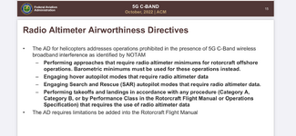

My understanding is helo requires radar altimeter use to hover precisely, and that is NOT ALLOWED, below 5000', due to conflicts with 5G telecom bandwidth and radar altimeters. That is still in evaluation period that does not end until 2028 in US
