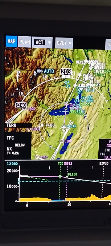

As an example approach into Geneva flown by me.
Magenta is my current leg. White is what it's going to do if I don't do anything.
Notice it has vertical profile as well. And indicates terrain. If the plan was to get near the ground it would trigger an alert and make that leg invalid. We would still need to change the selected alt to allow it to descend on the profile.
I can give you more technicality's of the NAV performance and ATC separation requirements and why it really throws a spanner in the works if your not able to meet them. Which you can hand flying but its extremely high workload and liable for emails to start flying before you have even landed. If you want. But it really doesn't add to the thread topic and would be suited to somewhere else.
BTW at that time we were 10 meters horizontal NAV performance and 25 meters vertical. Once we get below 10 000ft the SBAS stuff kicks in and vertical comes down to 15meters. But everything remains on BARO vertically until the final approach fix doing a LVP approach on GNSS.
