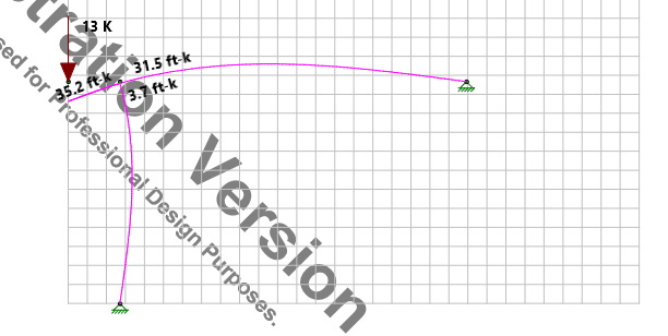

I just did a quick check, if the moment in the column is around 1 ft-k, the code specified minimum will cover (with e=b/6, b=5").
2-D verifications (W10x30 Beam, HSS5x5x3/16 Column):

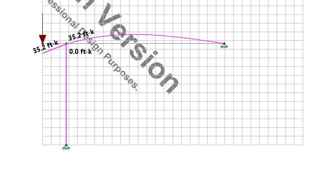

Pinned Beam-Column Joint
Rigid Beam-Column Joint

The load at the end of the cantilever is applied by a HSS column. Everyone so far seems to be regarding its connection with the beam as a perfect pin when in fact it cannot be. If that HSS is rigidly connected to the beam, it too must take moment, for which it should be designed. Also, the moment taken by the end column reduces the cantilever moment.
Is there a valid reason to be so concerned with one connection while completely ignoring another?
BAretired - is this really true? Usually the moment in a cantilever is entirely independent of the assembly beyond (behind) the cantilever right?
In this case, the cantilever moment is always P x (Cantilever Length).

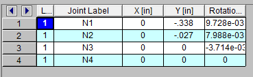

retired 13, what is the rotation of the beam at the column in your pinned example?
JAE,
The end column will reduce the cantilever moment if the slope is as shown in retired13's Risa 2D output. If the span moment is dominant, i.e. if it creates an upward slope in the cantilever, then the end column will increase the cantilever moment. In the special case where the slope is zero as a result of the simultaneous span and cantilever loading, the end column stiffness will have no effect on the cantilever moment.

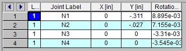

Here is the deflection table. Beam L-R jt 1-3, column base jt 4
BA - when you say "end column" are you talking about the column at the end of the cantilever?
For the rigid connection model,
Yes JAE, I'm saying the end column is the column at the end of the cantilever.
EDIT: All of a sudden, I am realizing that you thought I meant the column at the end of the span. Of course, that column would have no effect on the cantilever moment.
BA
And so assuming that the end column is "fixed" to the cantilever, then yes, the cantilever moment might be affected by relative stiffenesses.
