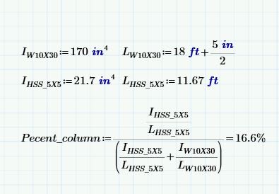

Assuming a rigid beam to column connection will allow you to very simply put an upper bound number to the share of the incoming joint moment that will be resisted by the column as follows:
% = 100 x (I_col/L_col)/(I_col/L_col + I_beam/L_beam)
That assumes that both member are still and pinned at their far ends.

@Vrpps_EIT:
1) What size is your beam?
2) What size is your column?
3) How tall is your column?
W10x30 beam
5x5x3/8
11'-8"
It's situation dependent and I'll know it when I see it. Here, assuming a 10' column:
- W12 or larger over HSS4 or smaller... No check.
- W8 over HSS8... Check, unless I had access to the cant deflection and it was real small.
I'm up for some sport. Throw something at me and I'll call it.
In this particular situation, I would have designed the column for an eccentricity of half it's width at a minimum to reflect the anticipated beam curvature I've the column which would, of course, help some.
So this much as an upper bound estimate assuming the connection to be utterly rigid. I'd have designed the column for a minimum moment of about 7.5%.
The moment there is 35kip-feet & supposedly that column has a little more in its capacity there with 50ksi as yield strength
Wow! that was a quick way to get the relative rigidity between the members and find out the % of moment transfer to column!
Is the column's share of the moment then 35 k-ft or 0.166 x 35 k-ft = 5.81 k-ft? It it's the latter, no problem. If it's the former, I'd be looking for a stiffer beam or looking at a beam-column design for the column as you'd be at at an 88% utilization rate based on bending alone.
no the 35kip-feet is the total full (if its 16% of it then its 5.81k-feet)
