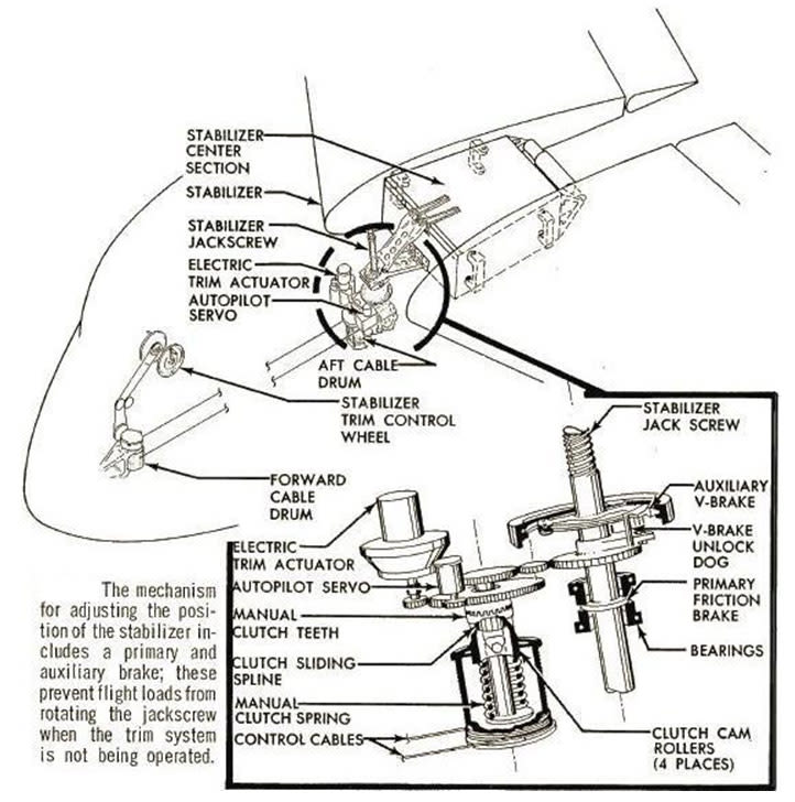

There are plenty of other jets of the same era 1960 which will have been the same in regards of not having full trimming over the envelope. But they had additional failure layers eg the classic 737 had two stab screwjacks, one of the pilot electric trim and one for the auto pilot and it had a cut out switch on the control column with full aft movement. So by the time they got to manual trim they were 3 levels down. The NG you could kill the AP input and leave the pilot electric trim turned on. And none of them had funny aerodynamic effects going on depending on which part of the envelope you were in.
Like everything else about what's happening the information releases are driven by financial regulations and everyone is keeping extremely tight on what's said.
Nothing is expected to be said until end of November when the FAA test flights will either go ahead or not as a lot of us expect. If they do then its EASA test flights next before Christmas.
From the stuff I have seen Boeing is determined to try and get away with only a software fix and a 2 hour ipad training session instead of an hour on the ipad. We shall see if the regulators accept that. If its physical system changes then we will still be discussing this same day next year

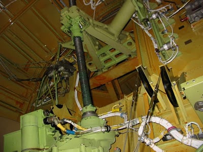

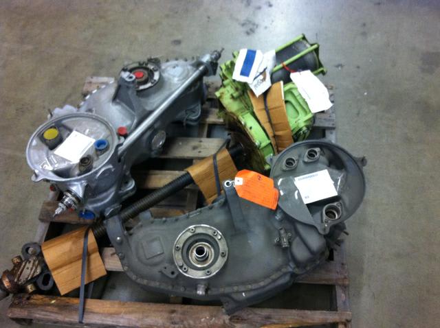

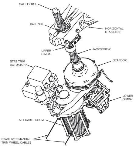

How do two separate independent screwjacks move the same stabilizer???
Don't have a clue you would need to have access to the maint manual.
I presume it would be some form of differential gearing driving the actuator shaft.
The motor's are only a small part of the unit there is a great big gear box on the bottom of it on the classic. The NG is much smaller
I think this is a diagram of the NG screw jack.
boeing_737_ng_horizontal_stabilizer_trim_actuator_1a529610f30d47f02f150f3adb614fff457f950b_ttueso.jpg
to add I am not 100% sure about the top pic is 737 but anyway its a old school one can't find anything on line. The NG screw jacks are a 1 man lift, the 737-500 its 3 blokes a forklift a loads of swearing from what I have seen.
Found this which is a more generic diagram.
So, I'll ask the naive question, why not self locking threads?
